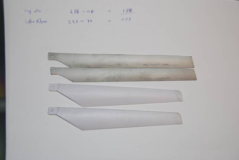

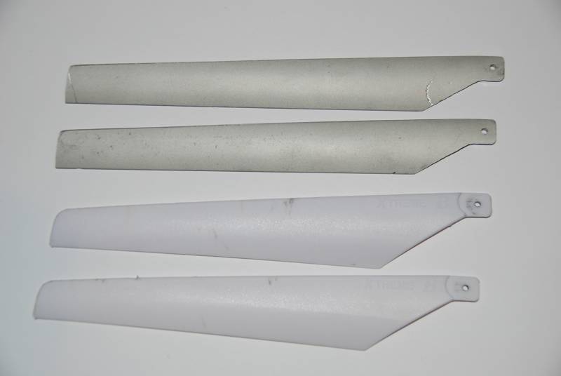

Here is my first attempt at making aluminium blades - all by hand! The photo shows a very rough unfinished blade and the equivalent Xtreme blades. As my aluminium profiles were not quite wide enough, I made them a touch longer. I cut these by hand, filed them, put them together and made sure they had identical sizes. A full hour's work! The weight is identical to within 0.1g and the CG to within 0.5 to 1mm.
Below is the table that summarises the lift caracteristics of the blades I have:
Supplier Weight Lift
Xtreme 5g 208-218 g
Microheli 2.5g 175g
Stock E-sky 3.5g 185g
Aluminium proto 10g 190g
To measure this, I put the heli on a scale, attached with elastics and one pair of blades only. I take the heli to full speed and measure the initial weight and apparent weight at full speed. The difference is the lift.
Does it fly? YES! To test I put the Aluminium blades at the top and Xtreme blades at the bottom. Had I thought of the testing earlier on, I would have started with Alu blades for the bottom rotor - to see how control is exercised.
It is a bit more sluggish than normal - but after a 5 minute flight, both motors were running at their usual temperature. I look forward to testing with 4 aluminium blades.
Caution: If you try this, just be TOTALLY careful that there are no kids, spouses, pets, plants and furniture within a 1 mile radius. Aluminium blades are 10g a piece and if they come flying off, they can do considerable damage. Just being hit by a blade will be dangerous - absolutly NOTHING to do with the plastic blades. Hitting an object with the blades can do a lot of damage to the heli itself.
Next step, while waiting for my motors, frame, etc. is to make the lower blades and try to make them lighter - down to 5 to 6 g.
Have fun and take care!

A quick update - i did the second set of blades today - this time same length as Xtreme blades, and just a bit narrower near the center. They weigh 11g each.. real heavy weights. Photo next to Xtreme blades and details showing the curve and narrowing. The edges are still rough.. I only polished the leading edges.
On a standard Lama 4, they have up to 170g of lift, compared to the Xtreme blades at 190 to 200g.
On my turbo charged Lama 3, they have 200g of lift with 7.4 V batteries and.. wait for it, 340g with an 11.1V battery. The Xtreme blade stops at 330g lift. As I hoped, the metal blades continue increasing lift with revs while the Xtreme blades taper off.
With both sets of blades on, my turbo lama 3 has 450 to 480g lift with Xtreme blades and 515 to 525g lift with the aluminium ones. These results are approximate as I did not want to burn my motors out so just went to full speed for a short while.
I expect to get in the 600g lift when I put on the brushless motors! Cant wait for them to arrive!
Ah.. does the heli fly ? YES! I only tried it on my V4 standard lama (the turbo lama 3 needs some reparation of the landing skids) and as you may expect with such heavy weights, it is as stable as a.. Lama 4 V4! Actually a bit tough to get it turning and there is quite a bit of momentum.
So my next step is to reduce the weight by half. Should keep me busy drilling - I need to find a very thin coverring film. Any ideas ?
By the way, has anyone tried measuring the lift of the carbon fiber blades ? Anyone tried them?

The potential interest of this is to be able to use different blades and do trials with different head speeds / blade angles. On larger machines, acrobatics are done with higher head speeds.
Anyway, so I made a blade holder where I can manually adjust the rotor angle up to about 12 degrees - see photo for the first draft. I made a few mistakes when doing it so its a bit messy.
With a 7.4V battery on my turbo-Lama 3, it has 170-190g of lift, which is a bit lower than the Xtreme and aluminium blades. At 11.1V, we get ot 310 to 330g lift, again, just a bit below the alu or Xtreme blades.
The lama is very nice to fly with this - I tried with a mix of xtreme and symetrical blades, as I only did one blade holder. For now, the best performance is with a fairly steep angle, in the region of 10 degrees. My guess is that I did not get the head speed high enough for optimal angle, which should be in the region of 5 to 6 degrees.
More tests will follow when I FINALLY get my brushless motors!
