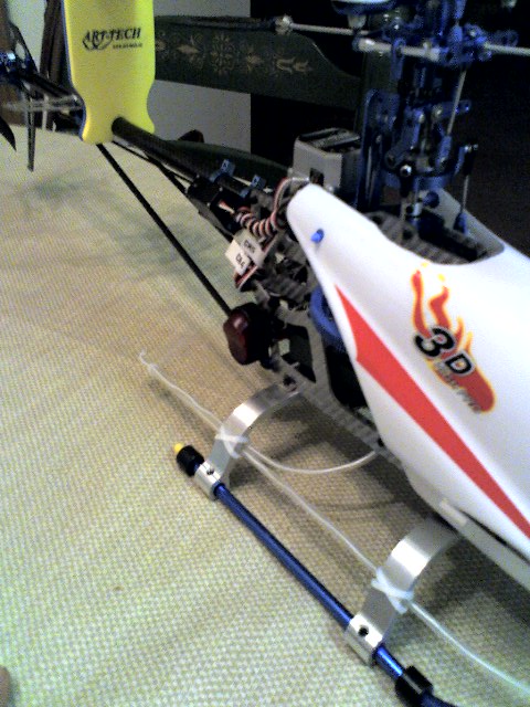

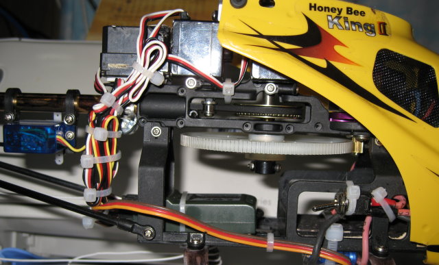

taking an idea from 'the other micro heli forum'...i installed a radio shack 275-624 micromini toggle switch on my hbk2...i soldered the switch into the hot (red) lead between the esc and battery...now i can walk out to the flight line, turn on the transmitter, flip the switch up, and fly...after i land, i flip the switch down, turn off the transmitter, and walk back to the pits...i think it is a worthwhile mod...btw, the switch is rated at 3 amps @ 125vac, which equals 30 amps @ 12vdc...i use a cc phoenix 25 esc...i've already experienced total electrical failure on my logo10, so i'm not overly paranoid about a switch failure...ken
CAUTION....CHECK POST #11 FOR LATEST SWITCH (Radio Shack 275-712)...The first switch I tried might not have sufficient current-carrying capacity.

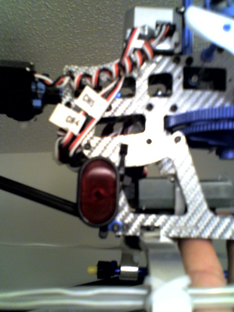

thanks for your suggestion to check out automotive switches at radio shack...i bought the #275-712 automotive illuminated rocker switch, spst contacts, rated at 30a @ 12vdc...here's the switch installed on my hbk2...

That sounds like a great idea but I still won't be trusting it carrying the bird with the deans connected. Your brave If you bump that switch with the TX off you could get a surprise. So where on the new rocker switch did you connect the hot (red) leads? I'm going to pick some switches up tomorrow. Thanks for sharing man.
Old 01-26-2008 | 03:16 AM
kenhiraihnl's Avatar
Joined: Jul 2005
Posts: 603
From: Pearl City, HI
Default RE: HBK2 Power Switch
ORIGINAL: xodarap1
hi xo...you're right about the hazard of a connected pack...the rocker switch is spst, and has 3 copper blade terminals (ground, load, and power)...i just cut the red lead from the esc to the male deans and soldered the ends to the load and power terminals...the illumination doesn't work that way, but the switch completes the circuit between the 3s lipo and the esc...i used my multimeter continuity tester to verify that up was 'go fly', and down was 'safe'...ken
Old 01-26-2008 | 03:50 AM

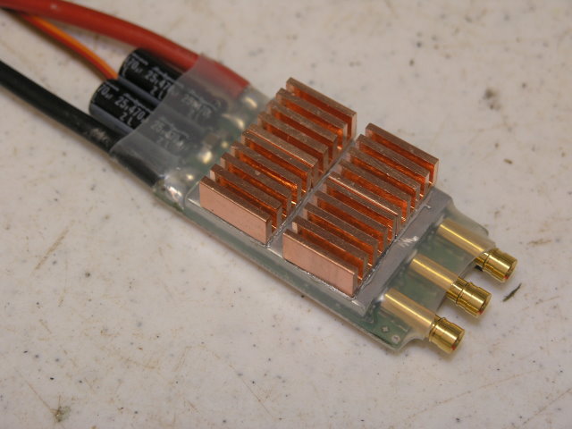

Quote:this is what i'd love to use but it's only good for 20amps... damn
http://www.frozencpu.com/products/58...html?tl=g4c153
that link looked familiar...i got my copper heatsinks and thermal paste from them...ken

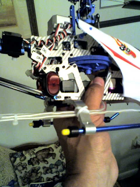

I got a few of the switches at Radio Shack today. I figured it would take me 20 or 30 minutes or so to install them on each heli. It ended up taking me two hours to tidy it all up. Took it outside to test it out and it works sweet. The only thing is my Li-Po alarm wires are still connected whenever the battery is, but that's no biggie since there is no power to the RX until I toggle the switch. The switch weighs next to nothing and for $3 a pop, a nice safety feature. After landing I just hit the switch before messing with the canopy and deans. Here's some pics of it mounted. Thanks again Ken.

Old 01-26-2008 | 11:34 PM
Joined: Jul 2005
Posts: 603
very clean installation...i flew my hbk2 in 20mph winds today, and the guys were impressed with the stability (nothing to do with the switch -- just a good pilot, and nice headspeed on idle1...lol)...btw, i'm looking at the gaui hurricane 200 from readyheli...the guys know me -- if i start looking at something, the 'add to cart' button is not too far away...ken
