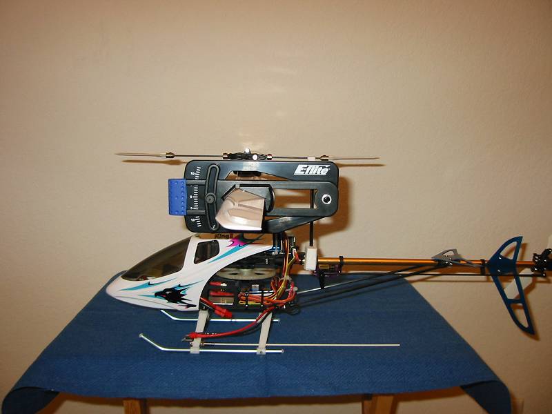

OK - I've got my HB King 2 pretty well set-up mechanically, BUT - I've read LOTS of posts in regard to main blade balancing, tracking and pitch. I've got the blades balanced, and I'm awaiting on my pitch guage in the mail. I have asked this question before, but I still don't understand (sorry) -
Since you use the same link adjustment for both pitch and tracking:
1) What should be done first - pitch or tracking adjustment, and,
2) please explain why whichever one you do first, why won't doing the next step affect the first (i.e. - if I set the pitch, and then turn the links for tracking, won't that change the pitch (or vice versa)?? I know I'm not seeing the forest for the trees - please help with an easy explanation! Thanks, Ken
Joined: Oct 2007
Posts: 398
From: Johnson City,
TN
You set the pitch first (checked with a gauge when the blades are at rest). That gets the blades mechanically close in the same range together. It doesn't take into consideration the play in the entire head which might make one blade or the other "off" as it rotates.
The tracking is fine tuning .. just another small pitch adjustment that you make when the blades are at rest, then observing the blades as they are spinning at different rpm's - with continued adjustments to one blade or the other until the blades appear to look as one when looked at horizontally.
Both are pitch adjustments, but tracking is tuning the blades a little bit (usally less than one full turn of a ball link end) so they track well together (by using the same adjustments that you use when setting the initial blade pitch). Tracking tape can then be used as a visual marker to fine tune them perfectly. (Thanks Cactus Hopper)

Hey Ken when you get your pitch gauge in and you want to set the pitch ranges on the blades you will need to use the 3 rods going from the servos to the swash plate. Remember disconnect the motor so it will not spin up. Set the idle up switch to stunt mode or flight mode 1. Set the throttle trim to the low position and the throttle stick to the center position. The blades should be at zero pitch. Move the stick to the upper position and you should have between 9 and 11 degrees positive pitch. Move the stick to the lower position and you should have 9 to 11 degrees negative pitch. You will be basically be setting it all to the center. Now you need to spin it up and set the tracking of the blades and you need to use the upper links in the rotor head to adjust the tracking of one blade. Mark one blade with some sort of colored tape and when you spin it up you can see it in the light. One will be higher than the other. If you need more pitch in the positive direction add pitch to the lower blade with the linkage in the head to make them track the same. If they are way off you may need to adjust both of them a little bit both directions. When you get them tracking close recheck your pitch adjustments so you still have the settings above. 10+ and 10- roughly. When you get this close the flight mode Normal will be correct. Have Fun and Good Luck Gittle
here’s my .02 on tracking…first, as previously posted, balance the blades…use red/black/blue balancing tape…at a hover, one blade might be flying higher than the other, i.e., the red blade is higher than the black blade (you can see it clearly under the right lighting conditions)…you can either increase the pitch of the low blade or decrease the pitch of the high blade…i recommend lowering the high blade by shortening the pitch control link, which will decrease the pitch…it’s safer to shorten the link, so that you’re assured that you won’t run out of threads…the engineer who designed the hbk2 specified that the link have a nominal length of about 57mm…us pilot/mechanics shouldn’t deviate from that too much…

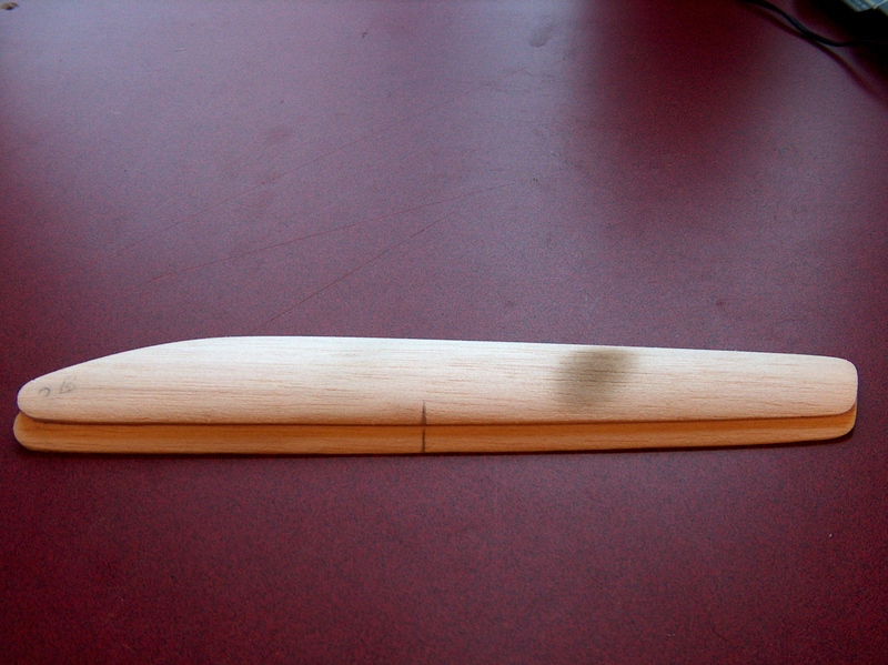

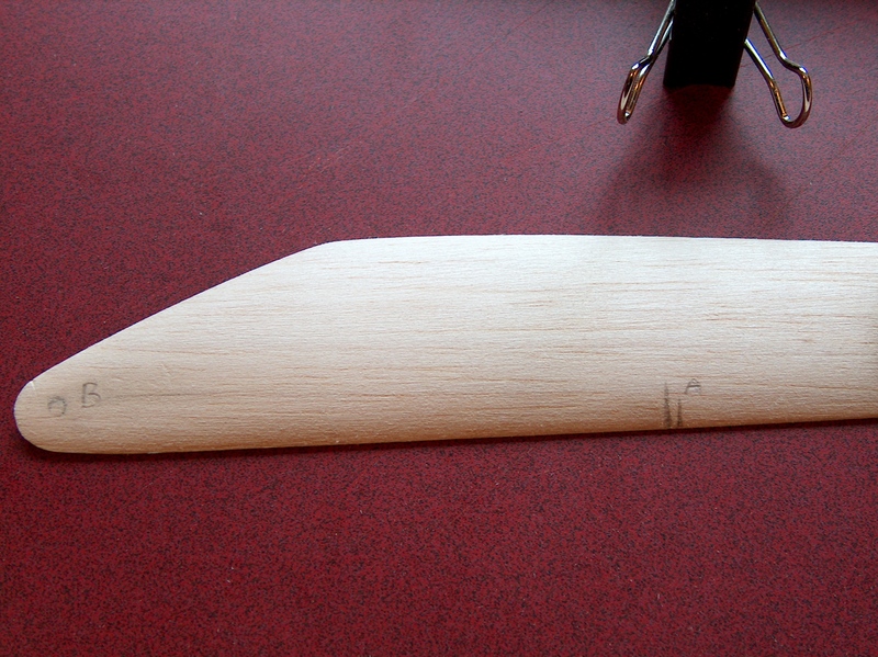

Now on to the blade balancing. To do this properly you will need some tools. You need some fairly accurate scales. I used Triple beam gram scales for years. My good friend was a sheriff and he had confiscated many sets of these things and one year they decided to clean out the evidence room. Well the county Judge new that I flew helis and ask Me if I needed or had any use for the triple beams and I said most definitely. So out of the many sets they had I got one of them for free. Cool story for the scales now I use electronic scales that weigh in grains. They are a little more accurate. You will also need a balancer. There are many out there or you can improvise by using a razor blade or some sort of sharp edge to balance on. I bought a balancer because I use it on everything you could imagine that spins. The first thing you need to do is weigh the blades and make sure they are the same weight. Grams will work if you can weigh in tenths of a gram. Grains is better.
Get them the same weight and most of the work is done. Now the blades have a center of gravity lenght wise and chord wise. Most people just cg the blades length wise and doesn't worry about chord wise. If you have a large heli 60 size nitro or bigger you probably need the chord wise balance also.
How to cg the blades length wise. Take a blade and set it on a blade edge and balance it. Put a small mark on the blade at the edge point when it is balanced. Now do the other blade too and mark it (temporary mark). Once you mark both of them. Compare the marks on the blades and see if they are the same distance from the bolt hole. If they are you have a set of blades that have the same center of gravity. If the marks are different then the cg is off. You will need to make the blades the same. You can make the marks move by adding small amounts of weight or removing small amounts of weight on either end of the blade that you wish to modify. Pick one and modify it to match the other blade and there you have a balanced and CGed set of blades.
Now this is pretty indepth and there is alot here so read carefully and don't miss anything. I will get some pics and put with this to help you. You can see where he balanced the blade and then balanced the other and then compared. Then he achieved equal cg in the last pic. In the last pic of the gauge you can see how to peer down the blade and get the gauge level with the flybar. Have Fun Gittle [sm=thumbs_up.gif] PM me if you have any questions.
The pics of the blades brought to you by courtesy of the Codfather from a previous post. Maybe he will not mind if we use them. The pitch gauge is one that I took of My King II heli.

No problem with using the pics, feel free to use anything I post here! It is the least I can do as a newbee to start paying back all the good info you have all shared with me! My technical background has helped me a lot to understand how each head system functions and how it relates to controling the machine. It definitely gives me a leg up on the non-techie newbee, when it comes to figuring out how I can fly this thing. Fly it??? I'm still having trouble just keeping it in a 4X6 ft box at 2 ft.
Joined: Aug 2007
Posts: 445
From: Runaway Bay ,
TX
Hang in there Codfather and you will get the hang of it. The blades look good. I have built some blades for the cp2 out of aluminum. I will post some pics of the here before too long. I have most of it down but the weight. They are a little heavy right now.
