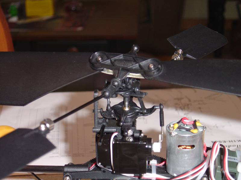

hi just bought a honey bee fp had a crash broke fly bar so iinstalled new flybar and now the ball links seem to short to reach to main rotor where did i screw up i think i put it back together ok but not sure what happen can any one help

What did you remove to replace the flybar? Did your rotor head pop up off the center hub? Also make sure your crash didn't damage the center hub.

yes i removed main rotor un hooked ball likks and took little set screws out that hold flybar put back together everthing seems to be where is made to go here some pics if that will help

ohh, I know what you did, when you re-inserted the flybar, you didn't get it to slide through the center hub, if you look the center hub will have a hole that the flybar slides through, if you don't know what I'm talking about let me know, I'll make a quick video on it, or I might already have, check [link=http://www.youtube.com/watch?v=ltcpaiHf8So]HERE[/link], there should be something in there
