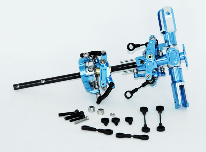

I would like to know if this will work on the Belt CP. Thanks in advance Rick.

everything but the swashplate if it's a trex head clone.

Thanks Druss. What swashplate do I need to make it work Thanks again Rick

the esky cnc head. the difference is that on the trex the elevator servo is at the back and on the esky the elevator servo is at the front but if you turn the swash from that head so the link is at the front then the anti rotation bracket is also at the front.

no problem, I think someone on here had posted a pic of the same thing you want to to... esky purple swashplate with a trex blue head. i think it was in the last couple of pages of either the big king2 thread or the belt cp thread.
