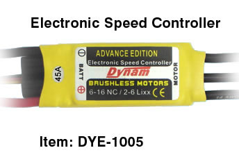

hey guys hope someone can help me.
i crashd my belt cp in the pool got it out quich only thing wrong was the speed control.
i baught a dynam 45A speedcontrol got it hoockd up but nothing no beeps nothing using lipo 2200 11.1 v batt.
thanx

sorry forgot to mention it arms when i use the old speed control but not with the new one..

ouch, the pool . Umm so your new ESC is it card programable? Also have you tried truning the Tx on moving the throttle to full then plug the heli in, it should start beeping when it stops return throttle to low and unplug heli and usually its good to go (a process that still makes me very uncomfortable but seems to be the only way to get some ESC's working), sometimes though you may need to try connecting the motor wires in a diff combination

Im very new to this so could u help me?
ive got this one
ESC-45A ItemYE-1005
(not include BEC)
Size(mm): 52X 25 X8
Weight: 30g
Current: 45A
Accu NiXX / LiXX: 6-16 / 2-6
http://www.dynam-rc.com/images/45A.jpg
how do i program it to work
when i plug it in nothing happens.
thanx alot

oh, if it doesn't have a BEC then thats the problem, your Rx isn't getting any power, heres a page with a bunch of BEC's

cool one more question where do i plug in the esc and where would i plug the bec into the reciever?
do i have to cut red the wire on the esc going to the rx?

the link that I put showing the BEC I have has a wiring diagram underneath it, but since your ESC doesn't have a BEC you won't have to cut the red wire
