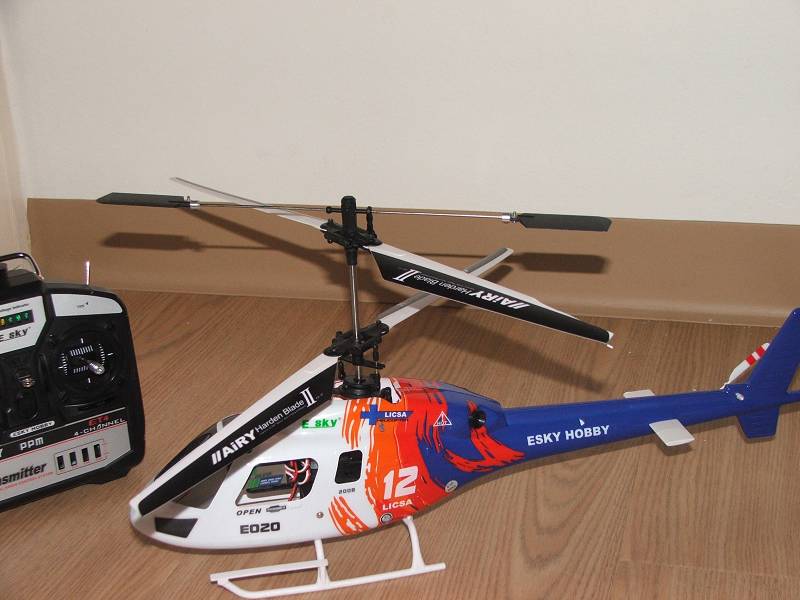

Here's a trick for INCREASING CYCLIC RESPONSE on the BIG LAMA. Takes less than 5 minutes, cost nothing.
Remove the brass counter weights from the flybar, but keep the rubber boots attached. The lighter weight flybar reacts 10 times faster than the weighted flybar, at a slight loss in stability (NOT RECOMMENDED FOR NOOBIES).
I've been able to do "CRACK ROLLS" with my BIG LAMA, without stalling the head, or causing it to stall out in high banked turns.
My next "cheapy mod" replaces the rubbers on the flybar with small flybar paddles, I just need a new flybar to mod, and it seems NOBODY has parts in stock (a worldwide Big LAMA parts shortage)[:@]!
Shadow
Sorry to "steal" your idea. But, as you can see below - I've just tried paddles (from my DF#4)
It does Xtreme Manouvers better than original IMO - like crack rolls and FFF due to torque?) - but is DEFINATELY NOT WHAT A NEWBIE WOULD WANT TO DO!
Peter

Thanks Peter, yes I am excited about being able to use my DX7. Now if I can just get a couple days that are not windy. I had a 1 hour window this afternoon where the winds were under 6 mph. That is when I tested the new setup. Since then the winds are back to 12 to 15 mph.
Your stabilizer modification looks great! What are the benefits and where did you get the paddles from?

I got the paddles from my DF#4 (FP) parts box. A while ago I replaced them with Super-paddles from Super-skids (WOW - what an improvement in "cyclic control"(? - I'm not sure if this is the right term) doing that gave to the DF#4). I had a few spare wheel collars also.
I have been doing exactly what Shadow said and practice>practice>practice my manouvers - well I think I am getting better at them anyway, but the paddles just gave me that between feeling of - not so much stability that it won't do much but hover & a slow FF, and total instability that I got when I removed the flybar weights entirely (leaving the black plastic ends as indicated).
The reason I indicated that this is not for newbies (who generally want MORE stability on hover) is because I don't want to be responsible for anyone hacking into flybars and not being able to reattach the hooks on the ends.
Peter
