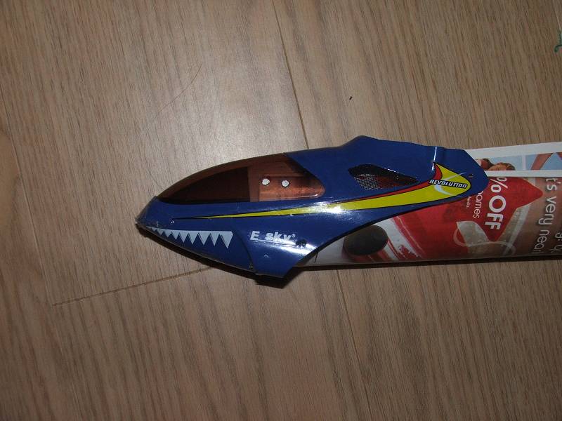

If I am short on time, I just push the trim forward two clicks to compensate for the loss of weight of the canopy and leave it off! Ensure that any 'prop' adjustments that you make are "enabled" by unplugging and re-plugging the lipo. For 'gain' adjustments you don't have to do this
Peter[sm=49_49.gif]
P.S. On one of my original canopies I made this mod to allow access:
