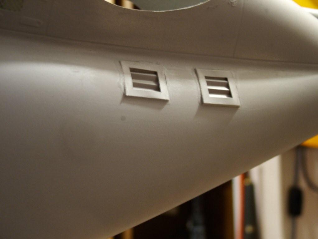

Default RE: E=Smart 600 Fun-Key Bell 222

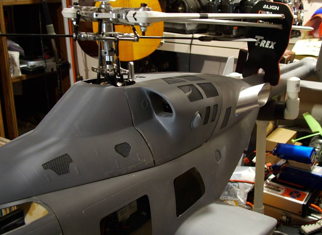

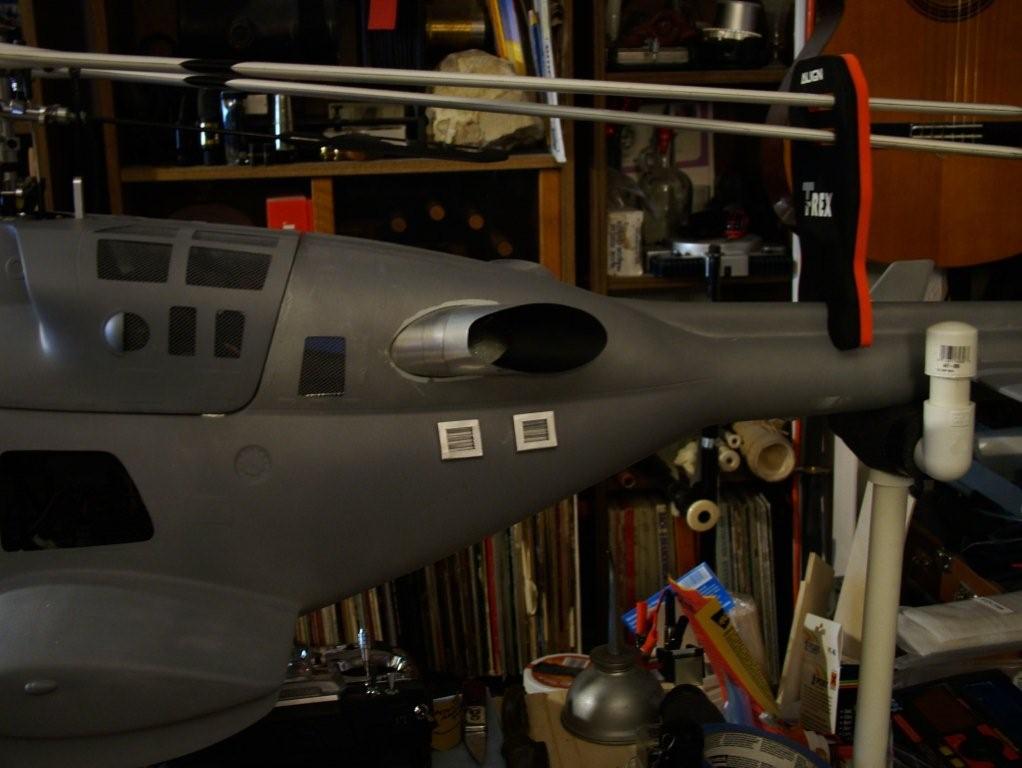

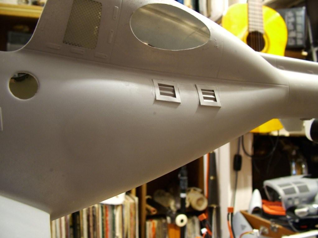

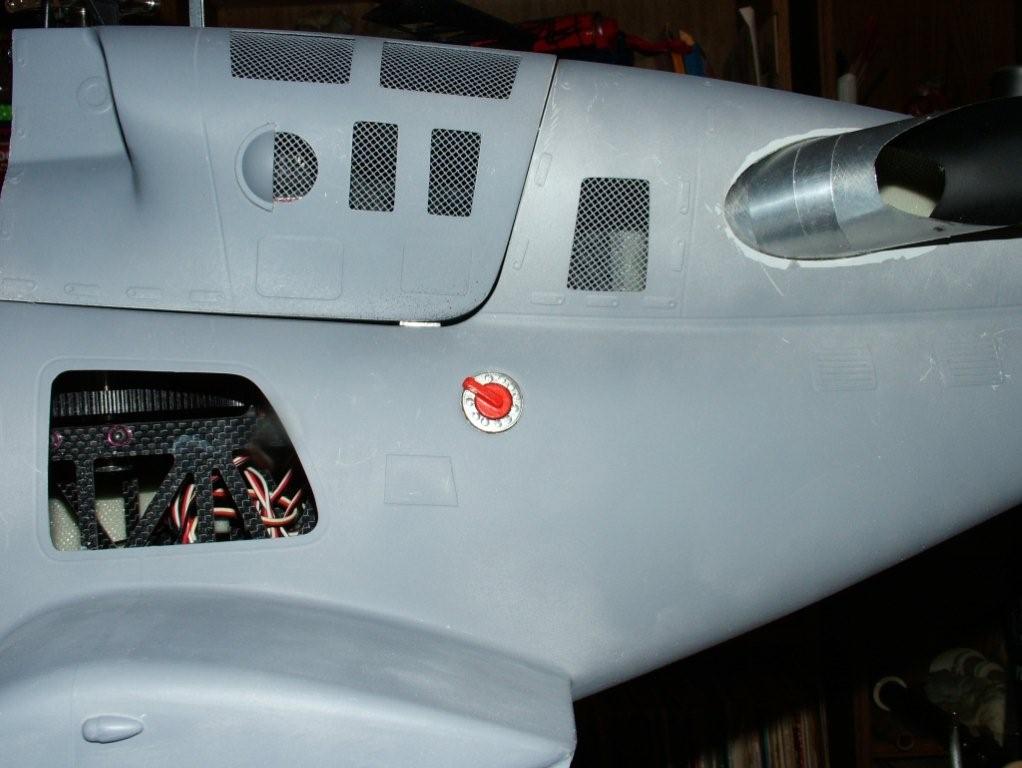

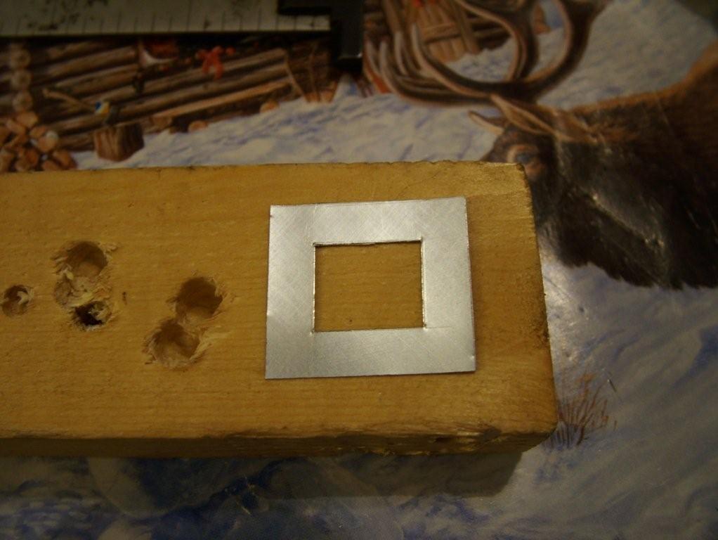

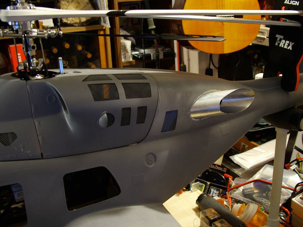

Hi people yesterday I was thinking about vent covers this was what I came up with. They are small and hard to make with what I have here at the house. Soda can again. Tell me what do you think. Yes or No
ID:	1301484   Click image for larger version
ID:	1301485   Click image for larger version
ID:	1301486   Click image for larger version
ID:	1301487   Click image for larger version
ID:	1301488   Click image for larger version
ID:	1301489   Click image for larger version
ID:	1301490   Click image for larger version

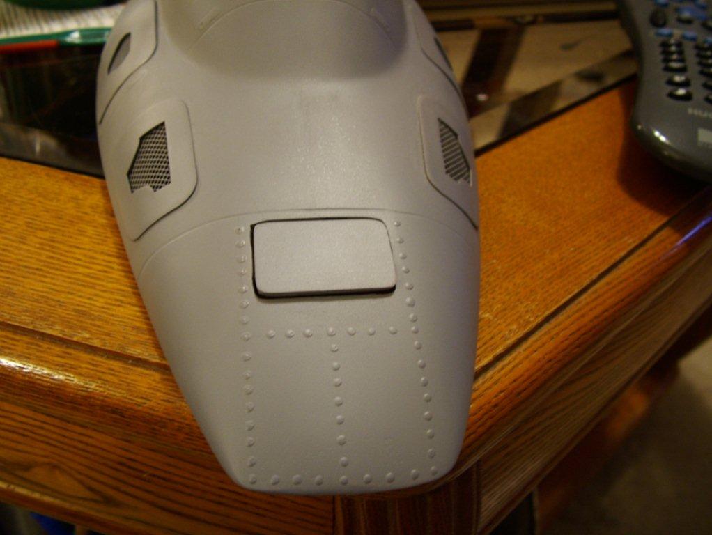

Fuel Door

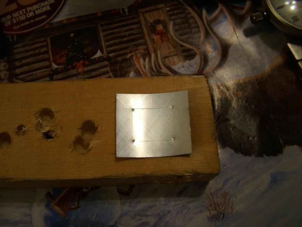

Well I played around at work a little and made this fuel door. It is raw not finished but it looks a lot like the one on the Fun-Key fus. I will paint the inside red and the outer bezel silver or the color of the fus. what ever color that turns out to be.

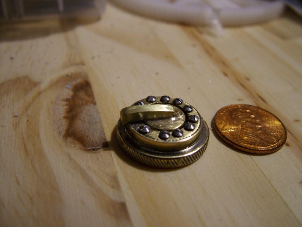

Old 10-28-2009 | 11:47 PM
  #31
Joined: Jan 2008
Posts: 116
From: Duncanville, TX
Taped in place

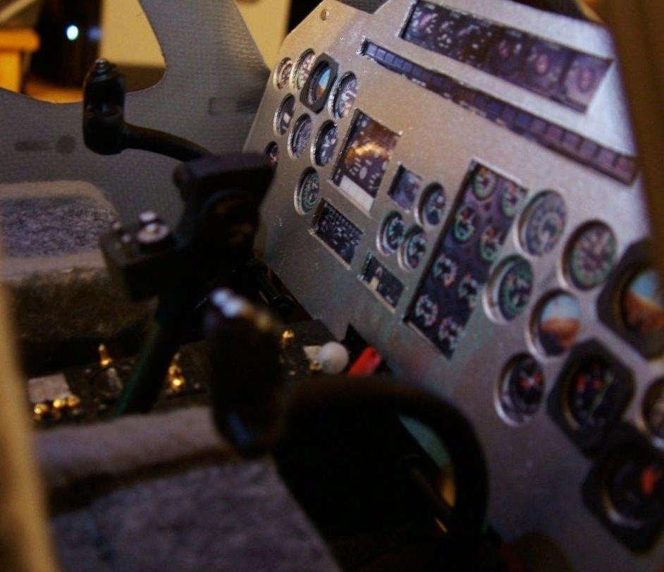

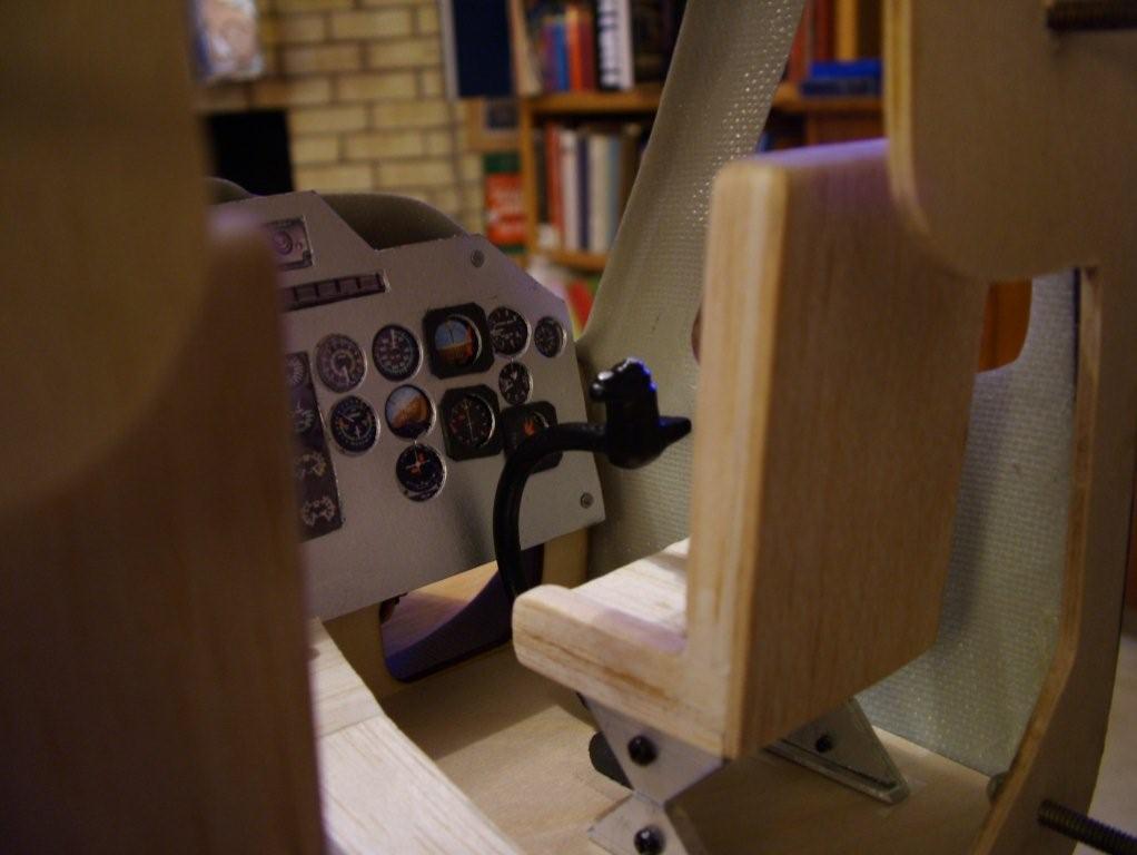

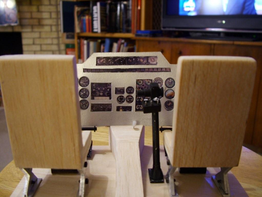

Gauge panel, I found a picture of the gauges in a Bell 222 and printed them. Hard to find good, correct pictures for free. I guess they don't have to be correct it's just for fun. Here are some pics. don't be too hard on me, kind of rough.

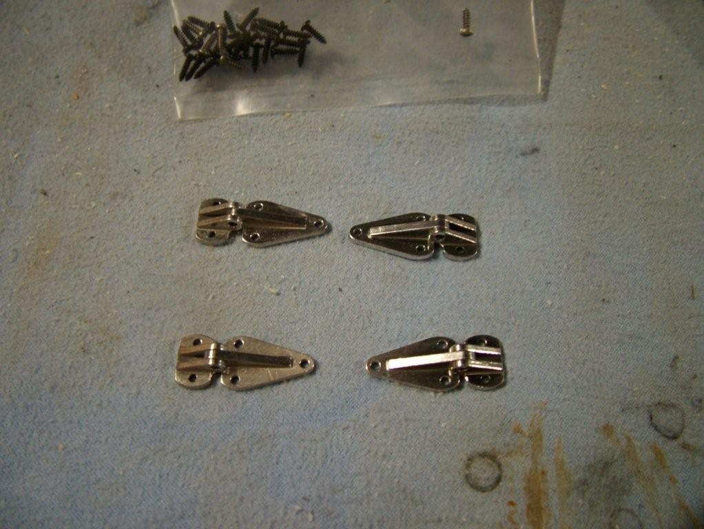

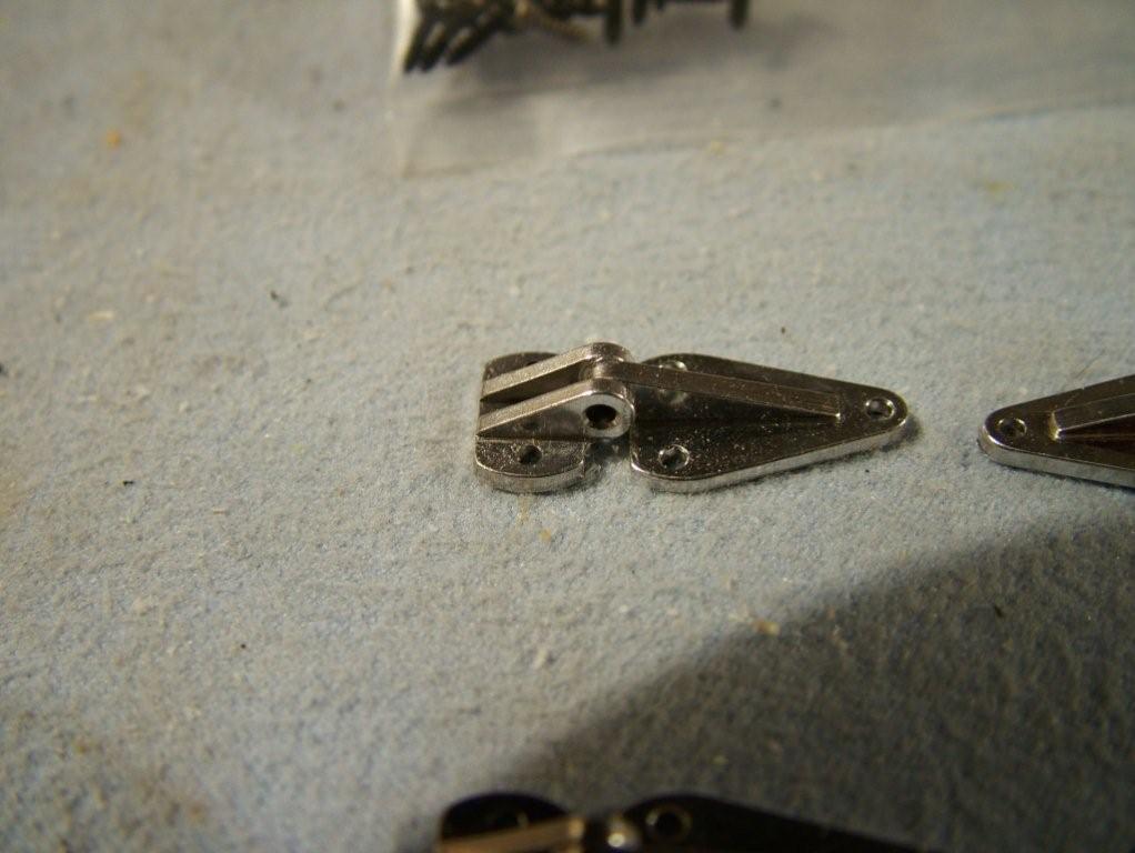

Something else to look at, hinges do I make the back doors open or the front doors open? That is the question, the only problem is the front left door was cut on the door line. These are so cool they're from Airstar International.

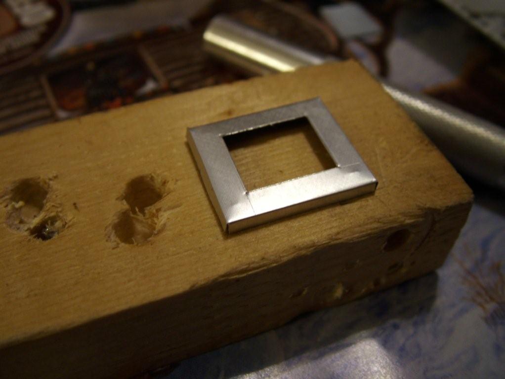

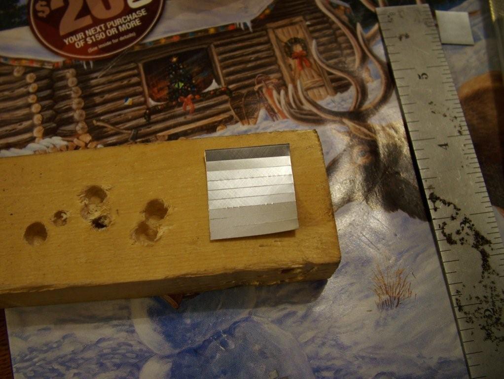

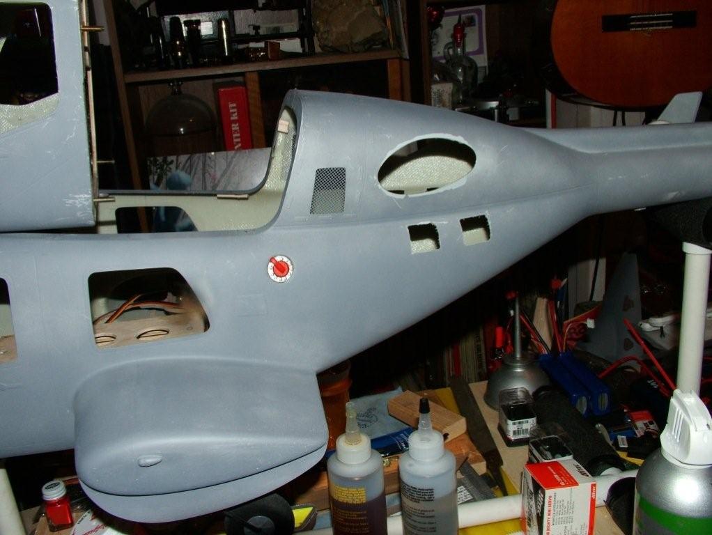

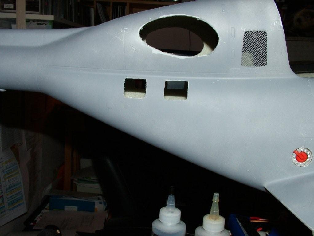

Cut the holes for the vent covers CA them in and will go on the inside and Z-poxy them.

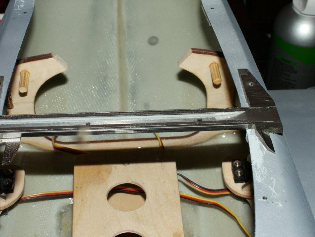

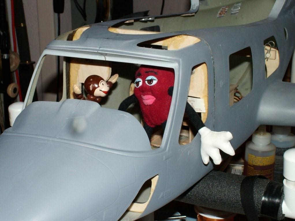

The brace was removed by the first owner. It is still removable using clips. Found scale pilot and co-pilot lol

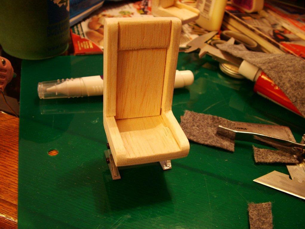

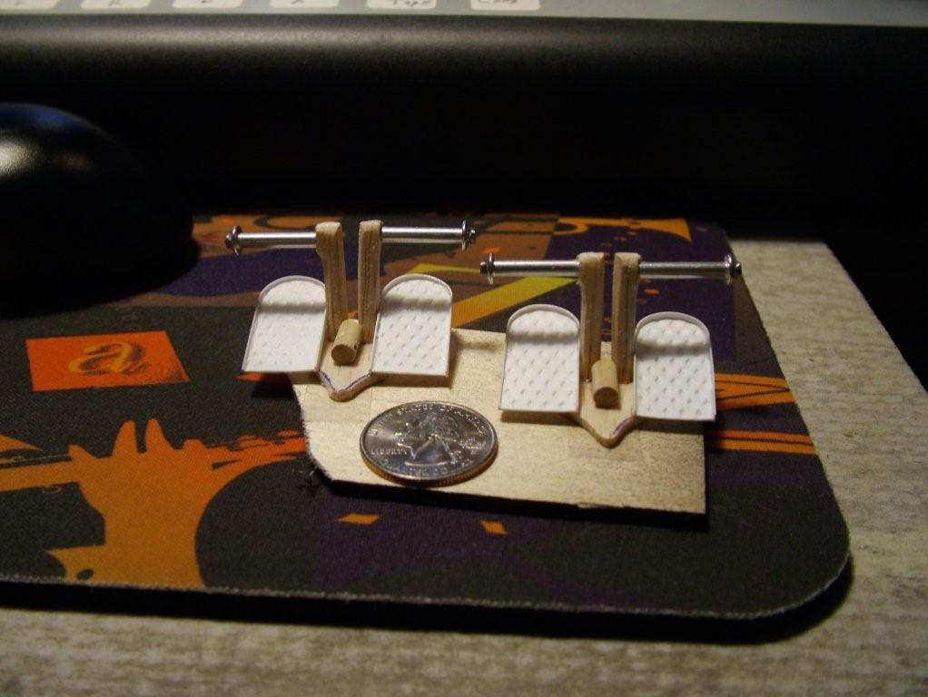

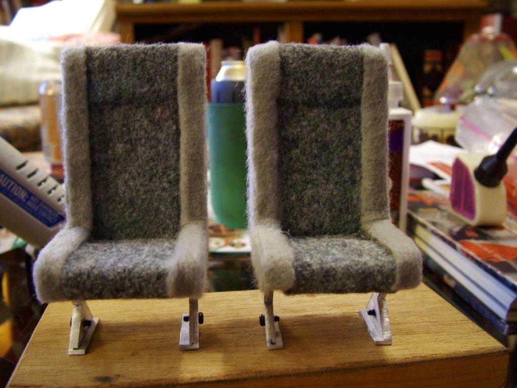

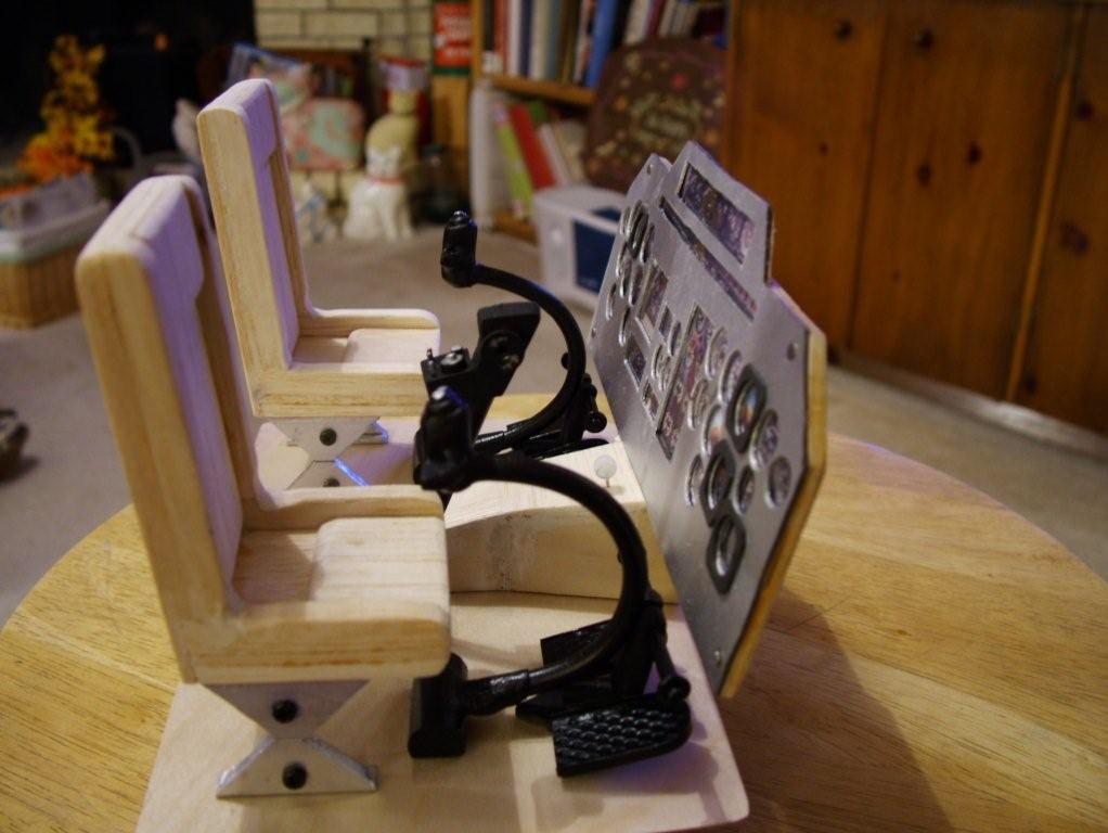

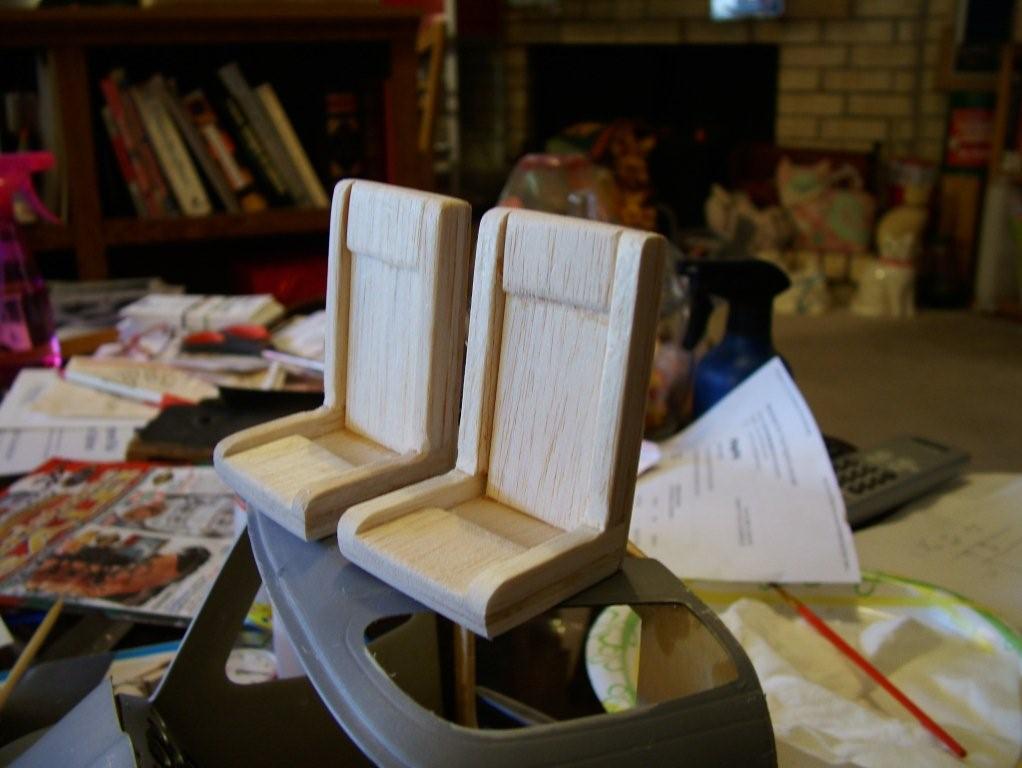

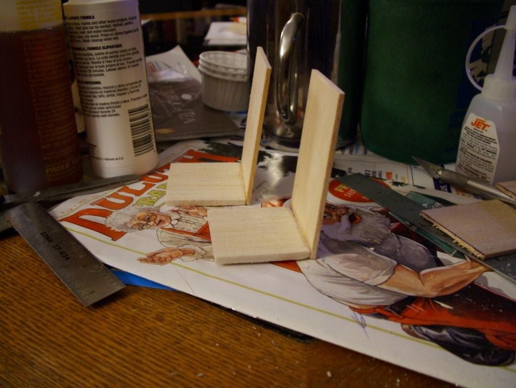

Working on the seats today.

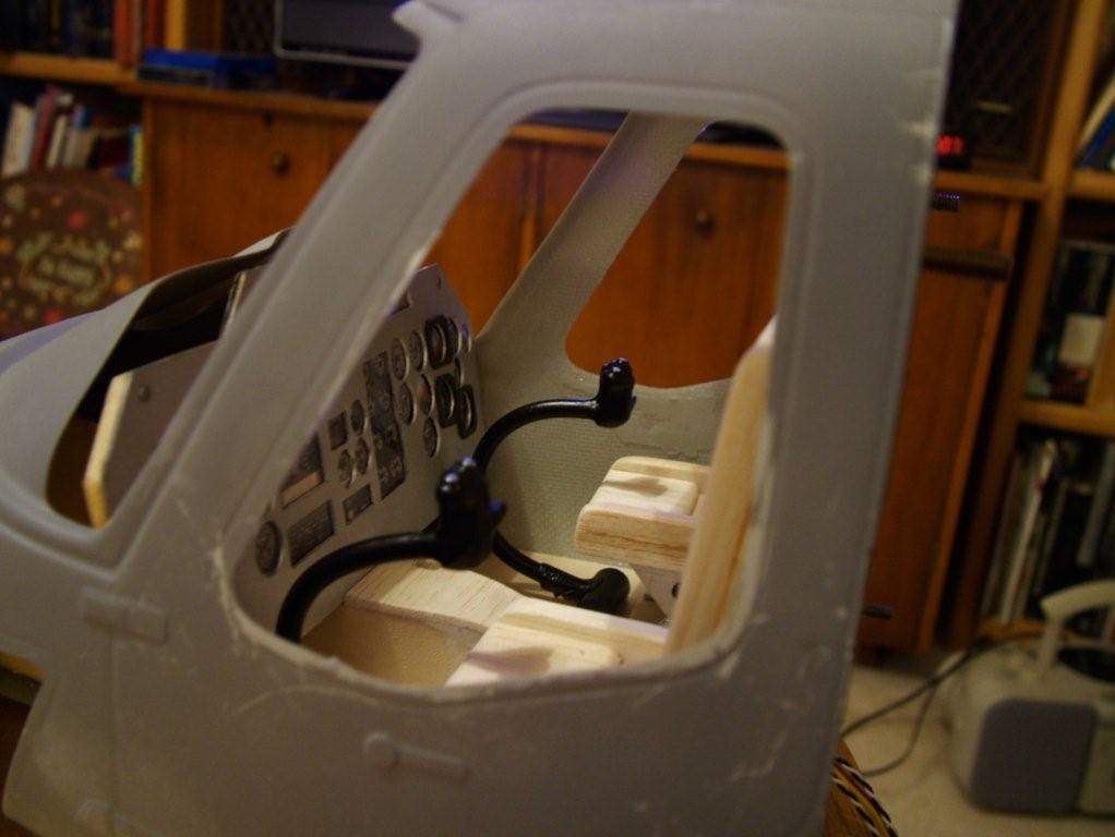

Cyclic stick, Grip is cork, the stick is aluminum, the bottom is wood, the boot is made if very thin leather. Painted the stick and boot. I Plastic dipped the cyclic grip put a dot of chrome paint on the buttons.

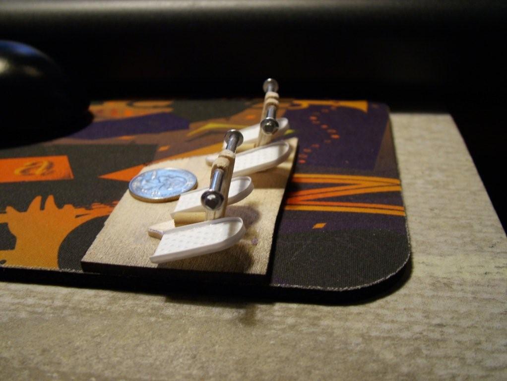

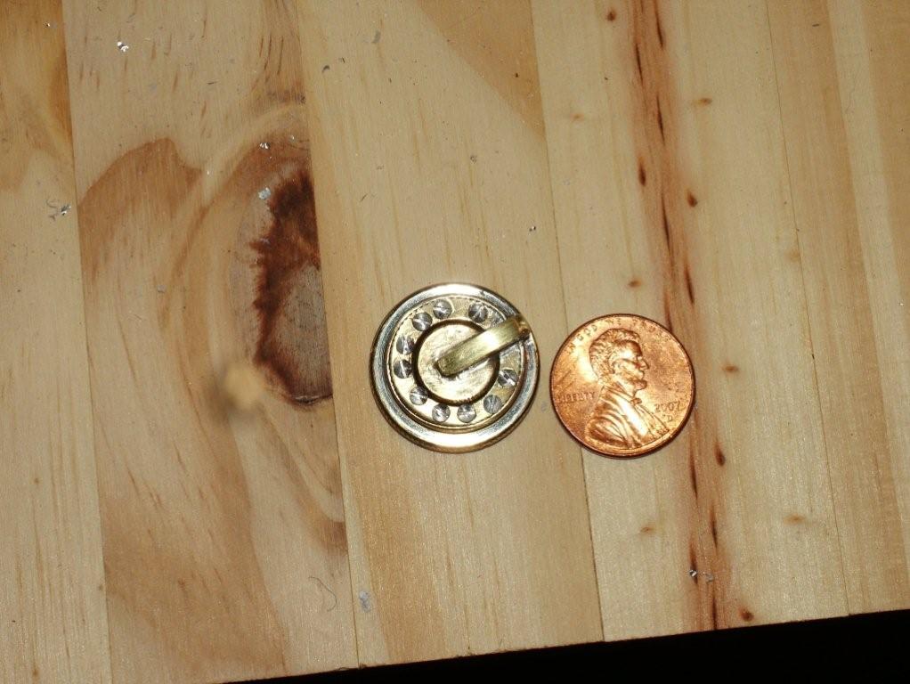

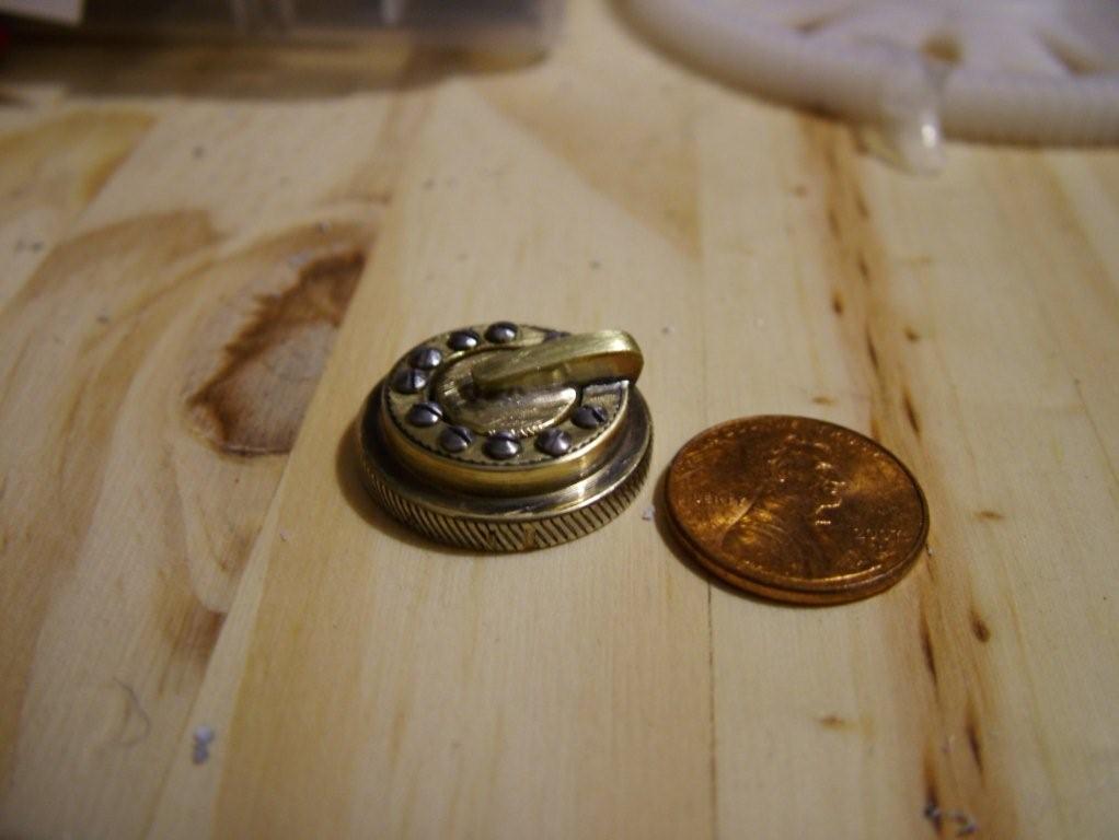

The pedals are made from rivets I cut off and then turned around. I used balsa wood and cork to finish the pedals. The foot pads are made from .020" .010" sheet styrene. I textured the pad by crimping it between wax paper in a vise then cut my pieces.

Old 11-18-2009 | 11:57 PM
  #46
Joined: Jan 2008
Posts: 116
[youtube]http://www.youtube.com/watch?v=v28X0NuUu1g[/youtube]

Seat covers
ID:	1317569   Click image for larger version
ID:	1317570   Click image for larger version
ID:	1317571   Click image for larger version
ID:	1317572   Click image for larger version

Started on rivets today too.
ID:	1317824   Click image for larger version
ID:	1317825   Click image for larger version
ID:	1317826   Click image for larger version
