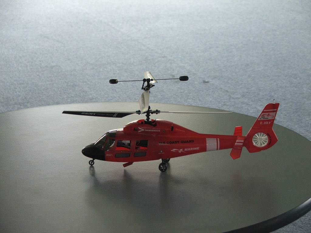

Has anyone upgraded to brushless motors for this type of heli.
They look a lot smaller than the original brushed ones, probally a lot lighter too.
My question is can these motors just be plugged into the the 4 in one or is there a ESC.
I really dont know too much about these co axial helis except they are a lot of fun, and fairly easy to fly.
Also thinking of going with the full CNC rotor head.
I think the co comanchie is the same as the lama V2 and V3 .
That means all the parts are interchangeable. Please correct me if im wrong.
Thanks in advance

The commanche is about 95% compatable with the smaller Lama coaxial parts. Most of the internal parts (including the motors) is a straight swap. But be cautioned. MOST BL motors indeed need a different 2 x ESC (part of the 4in1
) - unless a piece of electronics called 2 x "BL converters" is supplied. If you want more info - please supply a link to the BL conversion that you intend to buy.................Also a flier who calls himself "Wheelnut" - PM him[sm=wink_smile.gif] - actually had a commanche (and sold the fuselage) due to it being a "headache" to take off and put on every time you must alter the links - or do any service-type things to his bird![:'(] He upgraded it with the Xtreme pod and boom kit and the fuselage was obsolete. After doing this, his commanche parts were nearly totally interchangeable with Lama4 parts which are readily available.......
P.P.S. The first upgrade that you should be considering is the blades - to [link=http://www.boomtownhobbies.com/category_s/40.htm]Xtremes[/link] (available in three colours - white, blue & yellow - scroll down within post), but don't forget to order uppers AND lowers.
Peter[sm=shades_smile.gif]
P.S. The full [link=http://cgi.ebay.com.au/RC-Esky-LAMA-v3-v4-ESKY-300-Upgrade-FULL-Metal-Head-SR-/250468592177?cmd=ViewItem&pt=Radio_Control_Parts_A ccessories&hash=item3a51176a31#ht_2664wt_948]CNC Rotor Head set[/link] is great if you go with the cheapest available and DON'T INSTALL THE BLADE GRIPS. Reinstall the original black plastic ones.

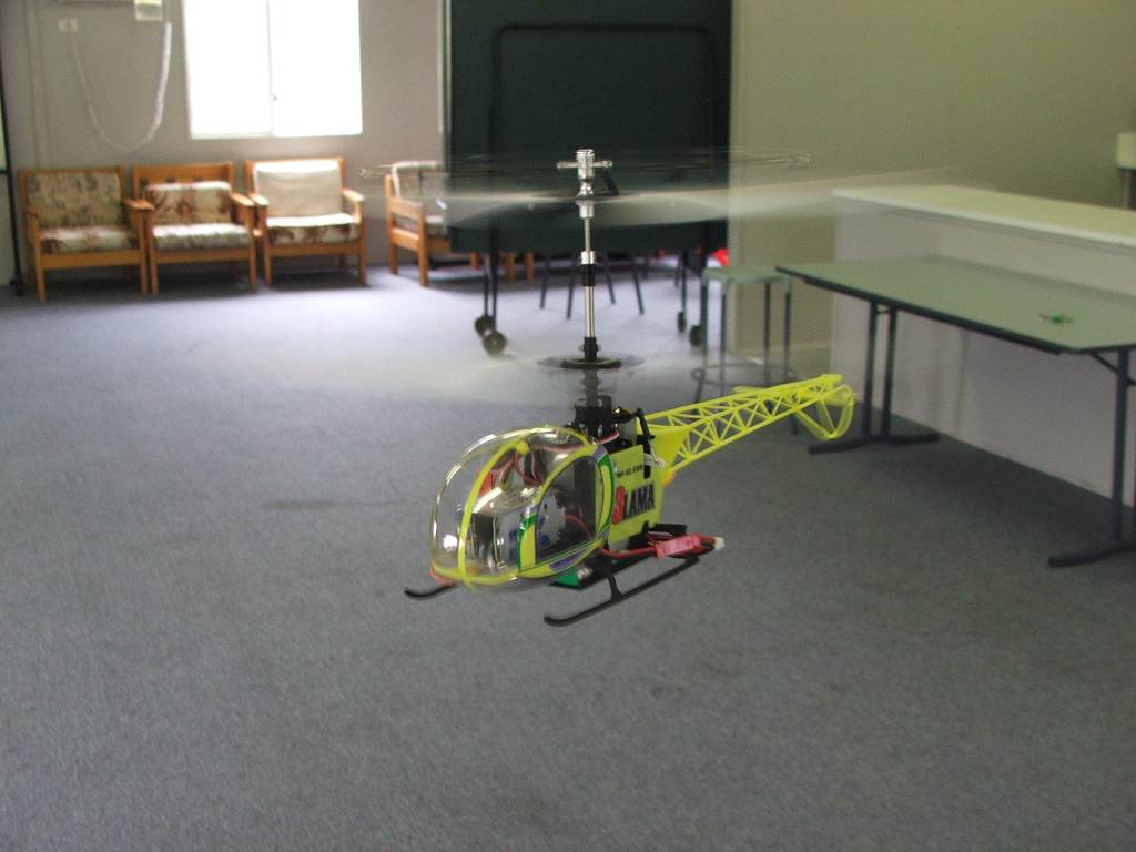

Hey again Sven,
Mate, I didn't use the word "perfect" anywhere within my post. If you want as close to perfect as you can:
1. Don't buy a cheap coaxial and
2. buy Skytec upgrade parts (mostly) with a few 'spatterings' of Xtreme - just as you suggest
I think I answered Nick's question fairly well. Maybe I will edit it and type in "Just my Opinon" - but at a later date - so you can re-read my original post to search for a "perfect" and not think that I edited it in.....

1) Is an extended inner shaft a good upgrade? My Comanche flybar keeps hitting the upper blades and damaging it all the time. To use the extended shaft I need to have a metal upper head, right? Could someone provide a picture of it?
2) As to the xtreme blades, how stronger than the original ones are they, pls? They are 5 times more expensive than the stock blades here in my region and I just want to be sure it is worth the price.
Thanks.

1. [link=http://www.rchelicoptershop.com/catalog/lp0002-turbo-shaft-for-lama-dauphin-comanche-p-342.html?osCsid=06570c9r4dvnt3tt00c4js14f3]Turbo shaft[/link]= metal upper head + extended shaft
Check out the videos within link also.....2. Extreme blades are at least 10 times hardier - well worth it!
