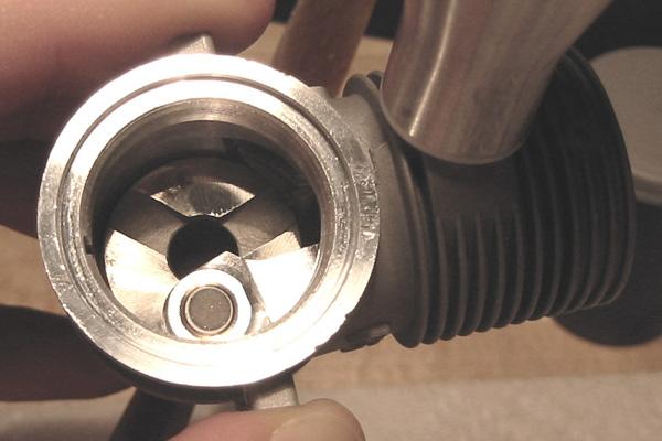

Ok, we have a thread about upper combustion chamber shape but not one about the lower half of the engine and although this is not restricted to either glow or diesel two strokes Ifind this topic extremely interesting.
So to kick it off please view this link concerning the Cyclon PC6 combat engine and specifically the pic labeled "View from the rear," showing the most unusual crank web cut aways used to enhance gas flow at the expense of engine balancing. A lot of this can be done by someone handy with tools to a standard engine - if they dare!
http://www.clcombat.info/pcsix.html
It's not only the crank work.
Case compression has been raised to shift best pumping efficiency to high regions
Flow channels have been changed to obtain the same
The front bearing is fixed, so the rear bearing can float to allow heat expansion
The piston is adapted to allow good flow at high rpm.

That Cyclon is what, 10 years old? Fora was doing this at that time as well. I think the notches do little more than allow the gas to flow out of the crank passage, which in these engine is a very large portion of total crankcase volume. I have a Stels where the crank passage is not drilled concentric to the journal. I think was done to assist balance though. Some of the older Rossi engines used sealed bearings and relieved crankwebs wrapped with a band to reduce crankcase volume.
It's all a big game of design compromise. You want the engine to breath well so you increase the crank passage diameter which increases crankcase volume. You shorten the rod to increase primary compression. Now you have piston skirt interference. So you cut off the skirt where it isn't needed and notch the backplate for the skirt that is. The rod can't be so short as to let the piston cover the transfer passages. And so on.

The lower crankcase compression ratio is what, about 1.6:1?
And stuffing the crankcase with a minimal backplate does little to raise thatcompressionratio so I am notsurprisedthat Duke Fox, George Aldritch or even<span class="Apple-style-span" style="font-family: Verdana, Arial; font-size: 13px; -webkit-border-horizontal-spacing: 1px; -webkit-border-vertical-spacing: 1px; ">Edgar T. Westbury found any difference! It not like the primary compression ratio where a quarter of a turn can make all the difference.
This is all about gas flow and keeping the mixture in its gaseous form, and the least amount of non port surface area the better.
Just think of the lower crankcase as part of the transfer system and not a storage tank as this is what modern designs do.<br type="_moz" /></span>

Yamaha engineers have done a lot of research on the case volume issue. In all cases they achieved a volumetric efficiency of nearly 100%. The rpm at which that efficiency was obtained increased with the c'case compression ratio. So it is a matter of tuning the items together. For Example, it will not do to have a high CC compression ratio for a low rpm ported engine or vise versa.

In engines, it is all about time-area for the porting.
A slow turning engine with highly stuffed crankcase would need very small transfer ports, and there probably would be too much time between transfer closing and exhaust closing. Such a setup is used for racey engines, not low rpm torquers.
Like Jens said, a very well tuned pipe system could make use of this long period. Because of the long period, the pipe should not be sharply tuned, but very mild in order to have a reflecting wave of long duration..
All in all a difficult setup. In your case it would bebetter to have less crankcase stuffing and larger transfer ports with quite short time between transfer closing and exhaust closing.
