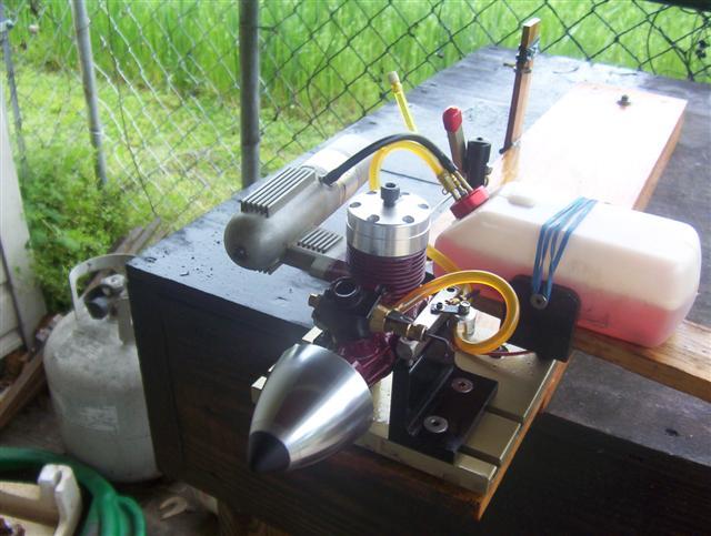

Cat, I bought this head from Mr. Davis for the exact reason that it had no fins. It was an unrun proto-type so I bought it as I would any other. I run the exact same Davis ABC mix fuel as all others others with no issues. I enjoy being asked about it though. This head by AJCoholic on my Fitzpatrick .61 is a clone of the glow head and has virtually no fins either.

RF, here you go.

Thanks for that Dave, the new position of the locking screw looks to me a lot simpler to machine but may be in accessable if the cowl sat flush to the engine's head.
But I really like the look of the new DDD heads, they seem distinctly 'diesel' to me!

Davis heads rarely if ever need re-adjusting once set up and the tension screw even less often but the head could be mounted with the tension screw facing forward. You would never need to turn it while running.

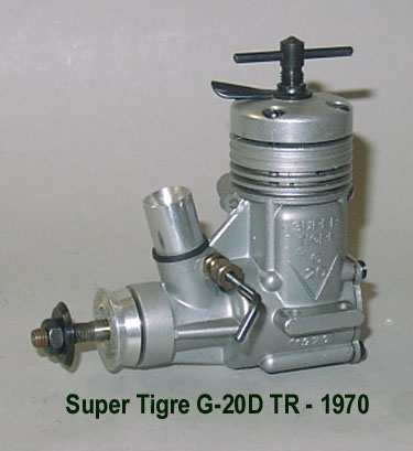

On the subject of "finless heads", I had several Super Tigre G2015 diesels in the 1970s similar to the one below. They had no fins on their heads and ran really well and never got hot when used normally. I still have one which I made from junk parts and used to use in 2.5cc rat race. It still runs well.
If you look at the photo you can see that there were originally more cooling fins on the earlier versions. The 1960 version had all the fins, but by 1965 one had been filled in and by 1970 another had been filled also. Possibly the earlier versions used to over cool and removing the number of fins improved performance. They were very powerful engines for their time. By the 1970s when I was using them, they had been relegated to "second tier" racing events like Goodyear and the serious FAI team racers were using modified Super Tigre G15 glow motors converted to diesel and other specialist motors like those made by Paul Bugl.
I also had a Super Tigre G15 RVD (rear valve diesel). It was intended for FAI team race and was very similar to the G20 but it was outclassed by the more specialised motors. And, they were famous for breaking the crank pin off the crank shaft. Mine did too. It was very common.
