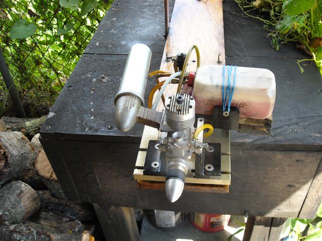

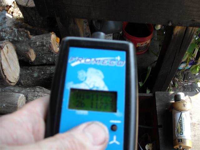

As I write this I have Fox .46 ABC running on Davis ABC mx with a Taipan 10.5x8 prop. The engine has 10 minutes total run time on Fox 5% glow fuel with 20% castor. So far it turns the Taipan at 11,655 rpm. I am going to finish a 16oz tank of Davis ABC mix which will take close to an hour and refill and get some more numbers and pitchers.

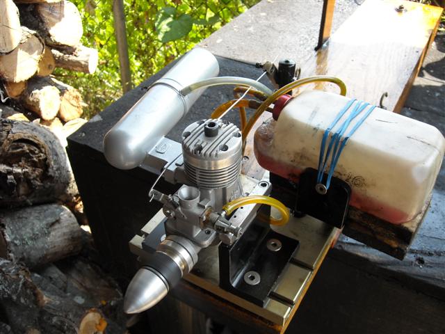

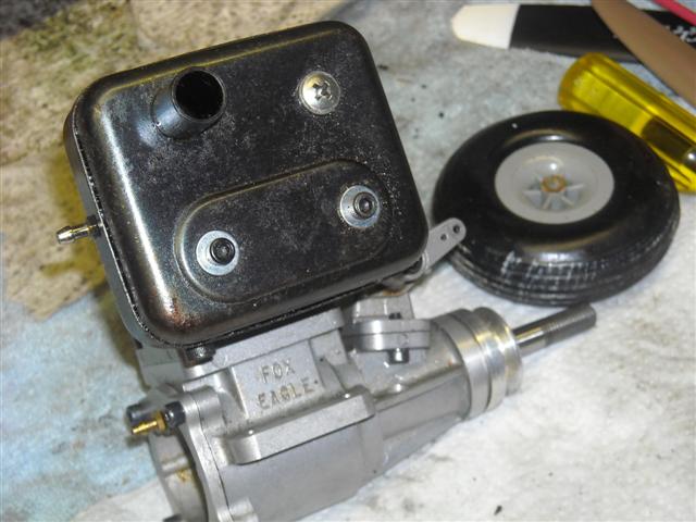

Thanks Earl, I got about a 120 rpm improvement over the first run. 11,777 to be exact. It runs best with the EZJust carb open about 85%, if I open it further the engine leans and slows, if I richen it a couple of clicks so it does not lean out and slow down it still runs the same rpm, so this falls right into what Mr. Davis says is a perfect set up job.
Please note exhaust, no gasket and no leak, not even a dribble.

Hi David
The MVVS quiet muffler looks good on the Fox 46. Were any modifications necessary to ensure a good fit?

Default RE: Fox .46 ABC/Davis head
Thanks Derek, no mods, the bolt holes in the Fox are ever so slightly closer together than the holes in the muffler but they run down with only minor resistance. The 3255 fits the larger Fox .60 and .74 the same way.When running the square MVVS DustBin on the .74 Diesel conversion it has a really neat sound.
Yeah I needed to touch up the holes on a MVVS muffler a little and elongate them slightly on the inside as the FOX engine's holes are about 1/2mm closer together. Depending on the muffler and how large the holes are, you may or may not have to oval the holes slightly. I put a Bison in-cowl muffler on my Fox 45 powered Japanese Zero plane, and I had to elongate the holes on the inside slightly to get the screws to go in. But another engine, one of my .60 engines, the MVVS muffler fit it just fine as is.

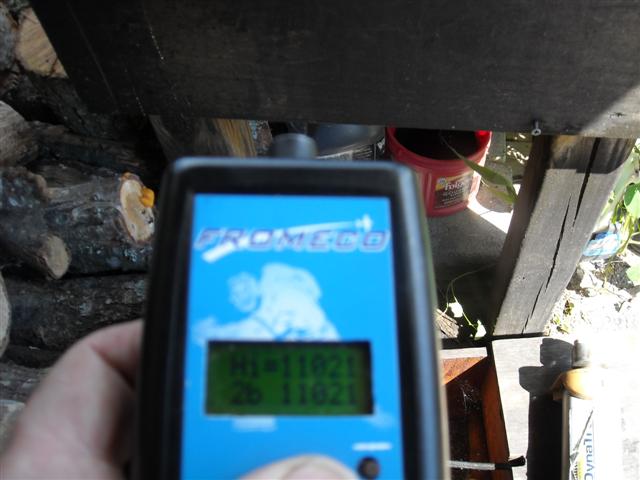

OK, I'm adding this post here since this involves a Fox .46. I dug into my junk parts bin and came up with a useable Fox .50 cylinder, piston and ring. I have a well used .46 ABC with a slightly loose rear bearing, I slid the .50 cylinder into the .46 block while rotating the cylinder so the ring would gently adjust its self and go in. And of course I went against all logic and put a Fox Quiet Muffler on it. I used the same carb as on the .46 above since it was already set up. I first ran a MA K 12x5 for an easy load and good flywheel effect then changed to the Taipan 11x7. It holds 11,000 plus rock steady as long as you want. The Davis head is quite old and well used but that doesn't matter at all. On this one I could run the carb at full open. This set up runs easy and smooth, idle is for as long as you'd like with no burble from cooling off. Atta Boy Dave, and I just broke my own arm.[8D]

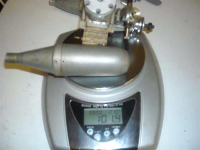

Is it a normal thing to use a 50 piston/liner in a 46 block?
Imean it obviously fits but was it intended by the factory that way?
And do you have any wieghts on these engines mate?

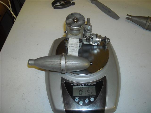

The .46 is the .50 block with a brass/ABC sleeve in it and .46 stamped on it, the brass sleeve like most ABC sleeves is pretty thick so the .46 weighs more than the .50. The .50 is the lightest .50 being even lighter than a Webra .50.
Picture #1 is Fox .50 #2 is Webra .50. I am involved with the motorcycle display at the Richmond County fair for the next four days so will be very busy.
