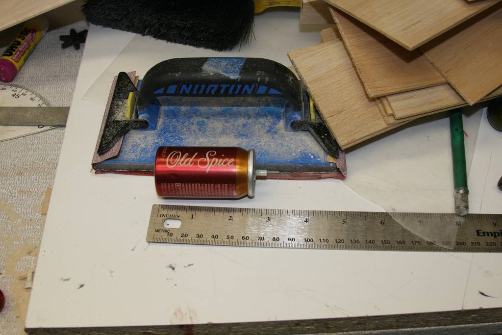

I had the same problem, I found the ether goes right through plastic, this is what I found at The Christmas Tree Store. I is a .75oz sample bottle of Old Spice spray powder, it was 99¢. I have some aluminum soldier, I bought some 1/8" aluminum tubing and I'm going to make some tanks.

Actually those are a pretty good find for those mini Old Spice spray cans. Looks very useable to me.

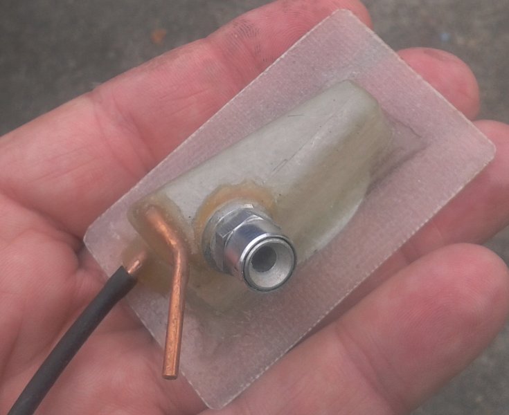

As Greg has suggested above Diesel Fuel tanks are easy to make. Especially if you have some basic soldering skills.
Otherwise a decent lightweight and durable tank for Diesel Fuel can be easily fabricated from Glass Fibre cloth and a decent slow set epoxy. It turns out that
epoxy is highly resistant to the Kerosene.
The pic shows a Mike North control line diesel tank completely fabricated from 1.5 ounce cloth with slow set epoxy. The valve is for C/L racing.
It can be molded around a male plug liberality coated with PVA release or a bit of suitably shaped Styrofoam which can be
dissolved away with solvent after the epoxy has cured.
Others have successfully coated a bit of flat thin balsa with GF cloth or Alfoil on one side and then constructed the tank out of it with the cloth on the inside.
