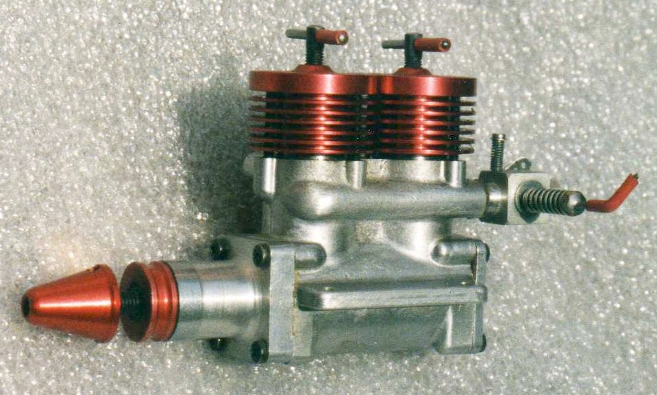

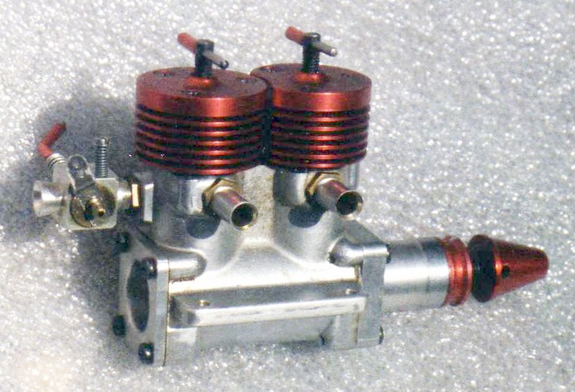

CS .30 Twin
Posts: 2,995
From: Hervey Bay Queensland, AUSTRALIA
On the bench: New CS .30 inline twin.
Propeller: RAM 10 x 6
Fuel mix: None specified. I used my standard sport diesel brew; 25% castor oil, 35% ether, 38.5% kerosene, and 1.5% IPN.
First fire up: The needle was wound out 2 1/2 turns. It actually fired 3rd flick after choke priming. It starved for fuel and stopped. It hand started easily after I wound the needle out to 4 1/2 turns. The spray bar inlet orifice is only 1/64 " (0.4 mm) diameter. I conclude this is why the needle has to be well backed out. Well filtered fuel will be essential.
Subsequent re-starts were acheived within a few vigorous flicks of a good choked prime. In all, a real possecat. The aficionados in the "club gallery" were impressed.
Six five minute runs were completed. Setting was very rich and undercompressed. Complete cool down between runs. Exhaust efflux was light honey in colour. No signs of distress. Session ended when rain closed in.
Running in will be completed when time and weather permit. If all progresses as anticipated I will post rpm performance. Short iPhone video link of engine running:

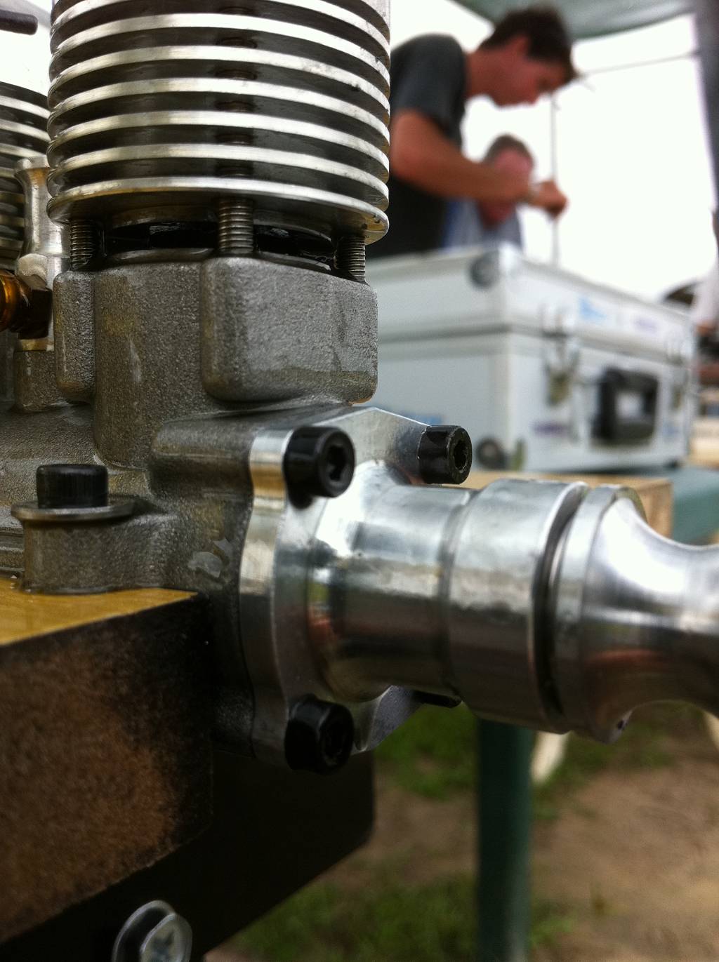

I had a problem with my CS Twin while completing running in. Email below explains resolution. I am impressed that CS are standing behind the one year no-quibble warranty they offer on their web site.

The OT Twin engine I recently bought from you has been damaged. I need to return it for service.
I believe I have sheared the drive from rear crankshaft, to the coupler which engages the front crankshaft.
This occurred possibly due to over compression of one cylinder. I will exercise great care in future.

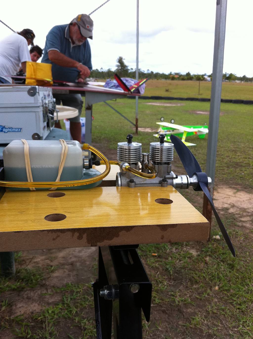

A further run of my CS twin .30. No problems experienced post re-build.
Easy starting, and good performance on a RAM 10x6 propeller.
My thanks to Adrian Duncan and Maris Dislers for their insight on how to get the best from the engine. The advice about checking the exhaust efflux with fingers was particularly helpful.

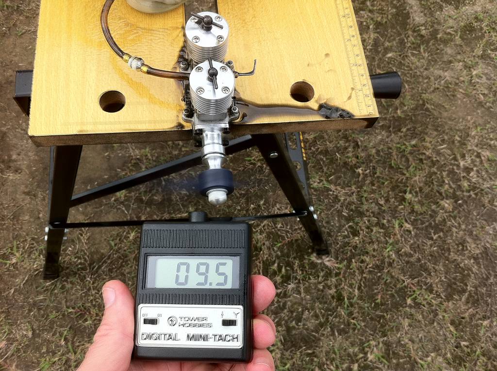

CS Twin .30 back on the stand after internal overhaul and R/C carb intake by Jon Fletcher.
The engine runs very well wide open throttle. It turns the RAM 10 x 6 propeller fitted at over 10,000 RPM. Minimal vibration. The noise is most impressive. I should have worn ear protection.
The twin needle R/C carb works well. However there is a problem. Unequal mixture distribution through the rotary intake valve causes the front cylinder to run leaner than the rear cylinder, and the front cylinder quits below 1/2 throttle.
Modification to even out mixture distribution between the cylinders will be undertaken.
