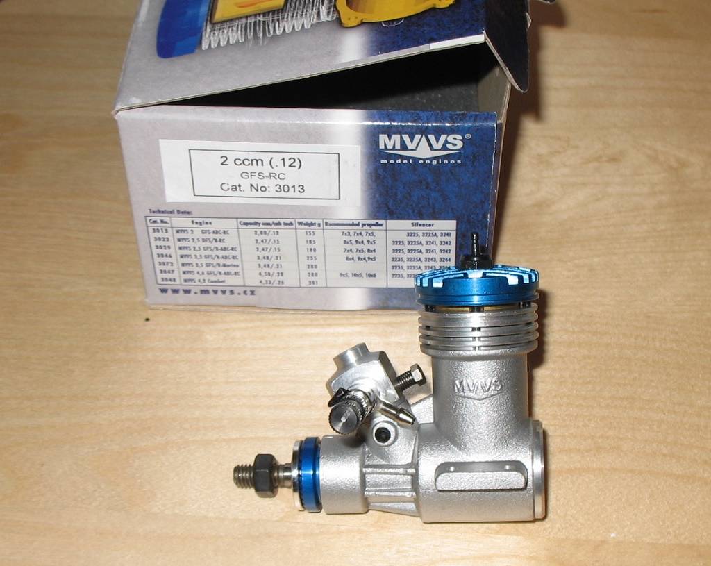

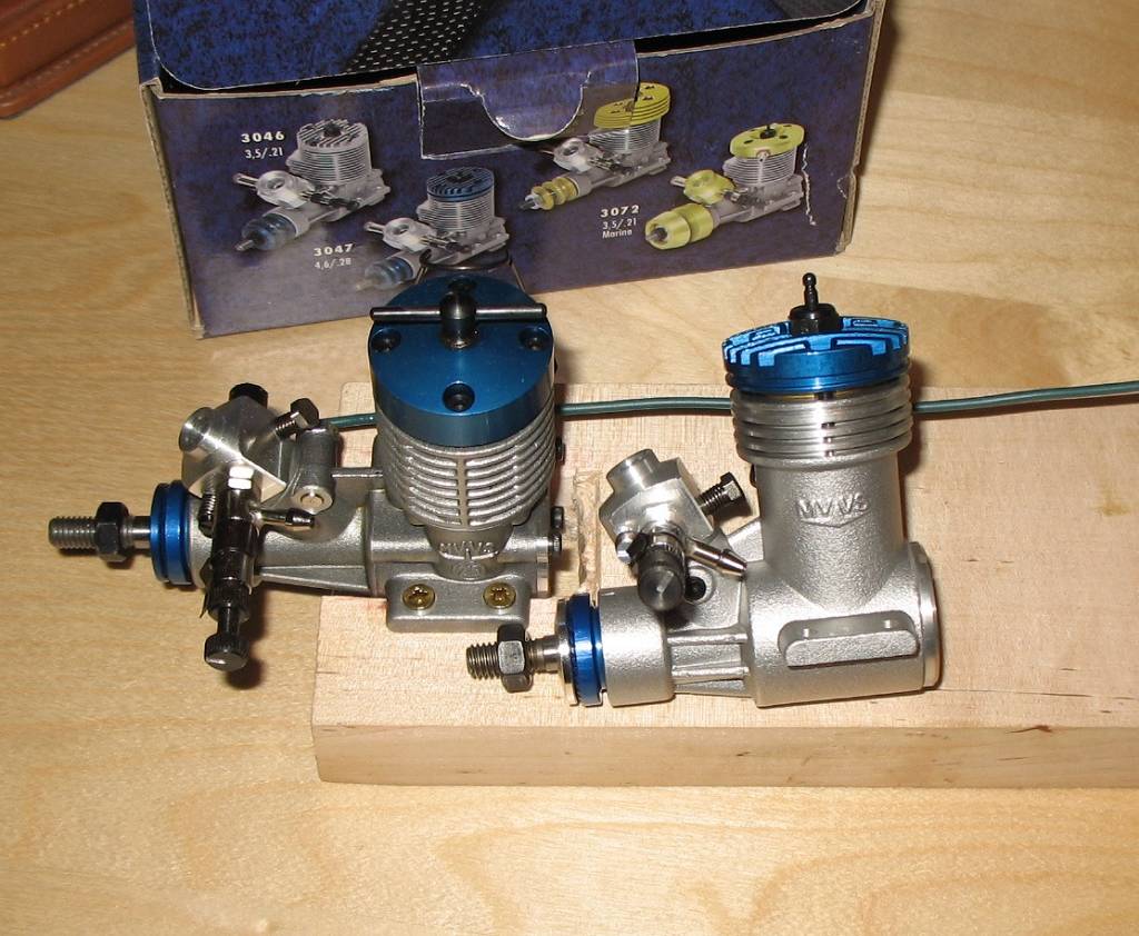

Here are a few images of the .12 GFS-RC, and one next to a .15 DFS/R RC.

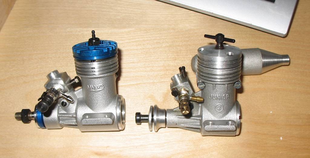

Here is another size comparison. The earlier plainbearing MVVS (Modela) Junior 2cc, next to the .12 GFS. The Junior is also a traditional steel/iron construction while the .12 GFS is true ABC.
