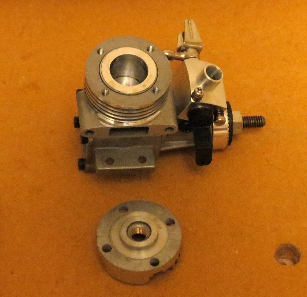

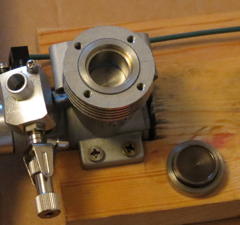

Here is my Enya 11CX D , interesting head design contra is in head but extends into cylinder sort of a variant on contra, guess it allows a thinner head,
Just pulled it off the shelf for the pix, wonder if same engine as glow except for head? martin

Martin,
I bought one from Enya - thinking to convert my early model 11CX to diesel, and it will only fit if you also get the diesel cylinder.
The 11CX bore is around 14mm while the contra diameter is 15.7. The same head is used on the 15 diesel as well.
Luckily for me Enya has a good returns & replacement policy. In fact Ken Enya is s delight to deal with.
Never did convert my 11 CX to diesel.
So to answer your question, the engine is the same as the glow except for the cylinder, which is recessed on the D to take the contra.

Many, if not all, glow ABC and AAN engines have a head that protrudes into the cylinder, I think it is related to the expansion of the cylinder being smaller at the very top where there is a flange, so you don't want the piston to go all the way up to the top of liner.
There is a long thread here on RCU on these engines and I've put some of my findings there; [link=http://www.rcuniverse.com/forum/fb.asp?m=10408168]Why a .11CXD[/link]
The glow and diesel engine have a common crankcase but the cylinder timing is more timid on diesel and the supplied carb is a also smaller. These engines are very nice and smooth runnning, I've used the quiet muffler from Enya on mine which makes it sound even smoother.

The design of the Enya head is interesting being bore of the insert in the head that holds the contra is the same as the cylinder bore the contra easily transverses
both unlike the the Davis and factory Irvine heads using a smaller contra that does not project into the cylinder, so is really a contra in the cylinder like many of the classics such as PAW. This also eliminates the stuck in cylinder bore we see in the classics sometimes. For a 10size engine (11 of course) it quite a bit heavier than the OS and TT 10s. The twin needle carb that Fiery describes might be a good upgrade, might be a little on the pricy side?? martin

The older AAC version is actually about the same weight as an OS .10FP, but the later ABC versions are a little heavier and they also come with the larger and heavier .15 muffler. The stock carb is a very nice one, it is the metering type rather then just a plain airbleed (like the OS one), why would you want to change the carb?
Edit; It looks like the .09 carb on the first image, is that stock or was it replaced? All my .11 (AAC and ABC) have the meetering carb or a twin needle carb.

well a close look at mine reveled model 2201 under the exhaust flange, it is an air bleed carb martin

Yes, I didn't see the step in your image and thought it was just a darker band from where the head would protrude down the cylinder of a constant bore. I can see now that our engines are the same, in terms of the bore.
The glow version has the regular design, a constant cylinder bore, with the head protruding down the bore. Here is the glow AAC engine;

Mr Cox Mine diesel the Bore for the contra piston insert in the head same as the cylinder thus easily moves between both, never had the glow version I can see that the projection of the glow head would take up space to reduce volume and have compression correct due do to piston staying pretty far down at TDC martin
