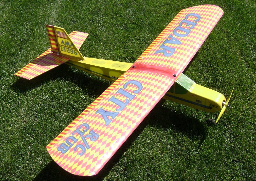

Had the plane out this morning, and it was the cylinder sleeve alignment that was causing the problem. Put in a flight of 45 minutes and still had half a tank of fuel left when I landed, power was adequate and seemed to improve as the flight went on, so I suspect it is still breaking in. It was also idling much better when I landed than when I took off, just ticking over, I had to pinch off the fuel line to get it to quit. Prop was a 10-6 Kavan I’ll have it out again tomorrow and post numbers with several different props.

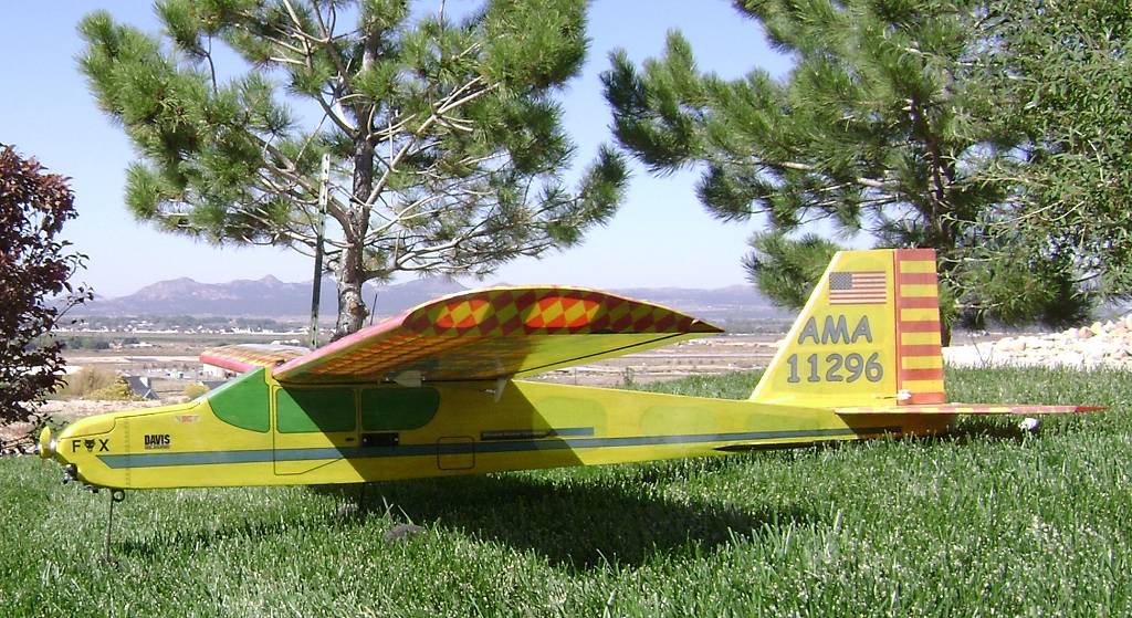

Love that inverted installation Tweedy. Where's the exhaust outlet?
Scenic background too.

Default RE: Need Help with Fox 15 Davis Conversion
See the black line below the blue stripe exiting the Fuselage in front of the Stab it ends about 1" aft of the elevator T.E. it's a carbon fiber arrow shaft.
Tweedy nice Mr Clean special all out the "stack" not over the plane martin

What is the covering? Airspan?

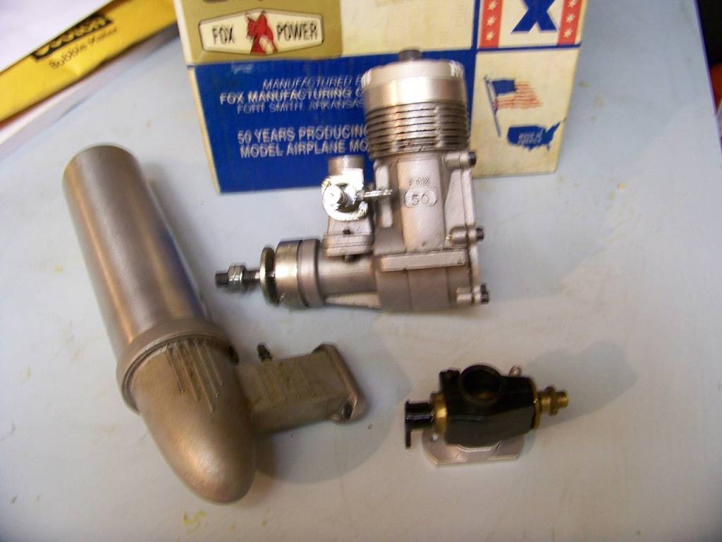

Here is its "big brother" a 50 fitted with r/c fox carb the black one is a Perry carb bigga muffler

Graphics done wwith a CAD program (DeltaCad), Printed on Dollar Store tissue, applied with Nitrate Dope, then silk, then topped off with a sprayed coat of Klass Kote. If I did it again I think I would put the tissue over the silk also well over $100.00 of ink.

ORIGINAL: fiery
In the background in the gap between the wing and stab is the runway of the Cedar City Airport, our flying field is at the base of the hills in the distance.

ORIGINAL: fiery
Nice ...
these were also printed on tissue
