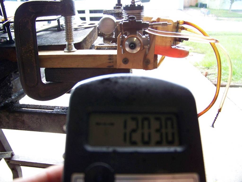

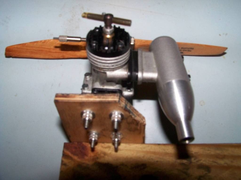

Ok group first run on MP jet 061 top flite wood7 x4 Davis 1/2 A fuel we did hit 12300 on 3rd run , all short engine runs temp got up to 199 on head
easy hand flip, oil very dark out the pipe not much smoke, needs time, time time
has nice bounce in prop flip no more squeeks turning slowly, got a little nick on thumb joint joint reaching over to adjust needle while holding tach
CA to the rescue martin

Just reran the same prop same fuel on my PAW 06 best we got was 10400 martin

Sounds about right in terms of rpm for both engines, the MP jet should improve a little and reach about 12000rpm on a 7x5 prop.

Martin, you found my one gripe with that engine...the needle is sooo close to the back of the prop! Excellent runner though!

George glad it was a wood top flite , had it been an APC "razor blade" would have been a lot worse, and with the carb mount cannot rotate a few degrees aft martin

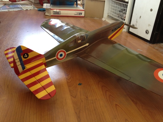

I had mine out just this morning, and it was great. Used an APC 7x3 as usual. The model is a little semi-scale D.520 CL stunter I drew up, about 34" span - more than enough power!

STEVE111 superb build and finish not too many around with the skills and willing to take the time to do this.everything today seems to be instant gratification regards martin

Nice Dewoitine Steve. I envy modellers who can finish a model really well. I can build, but have real issues with finishing.

Don't worry Derek, I can't finish them all that well either. About all I can do is try to throw on a flashy paint scheme, make it look shiny with some gloss marine varnish, and then photograph from far enough away that you can't tell what it's really like. I know that plenty of guys (particularly those on the US stunt scene) will spend months sanding with wet & dry, apply half a dozen coats of 2-pack clear gloss, etc, and get a stunning finish, but that's way beyond both my skill and patience.

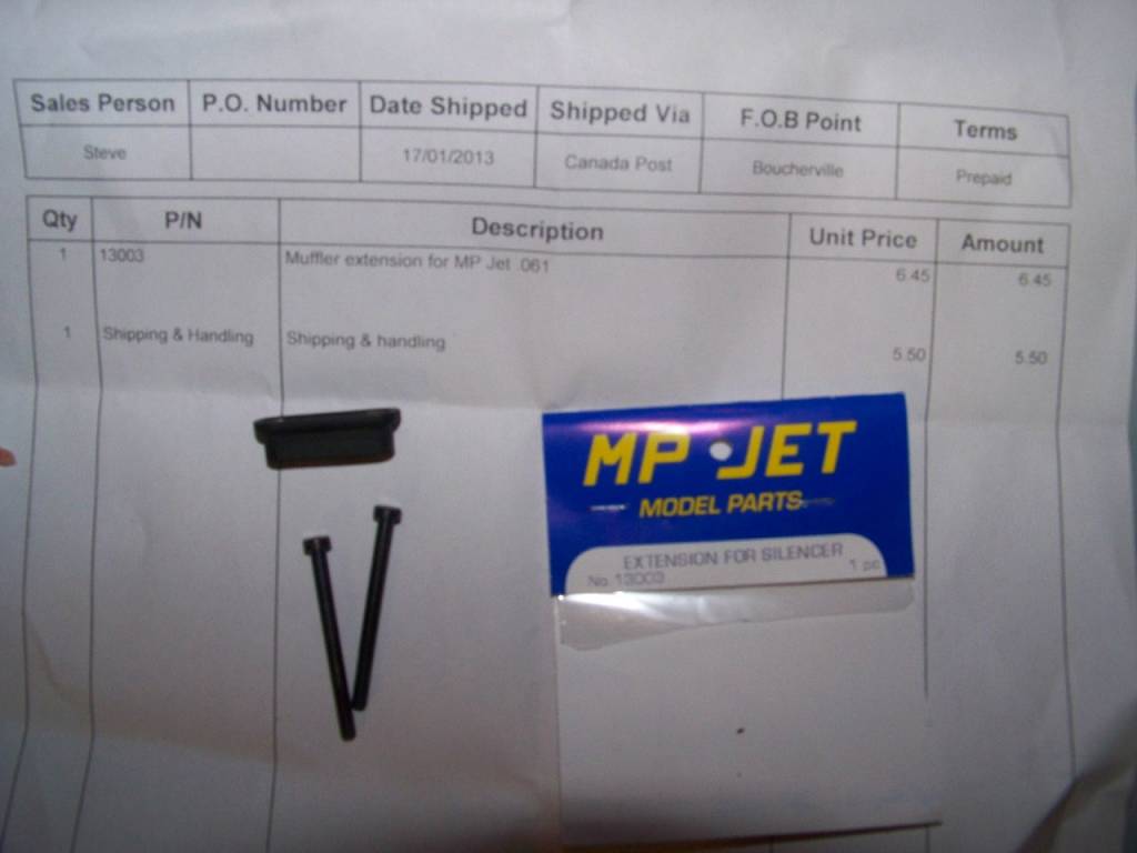

The mystery deepens just got this from I Care RC Quebec
Its molded BLACK PLASTIC NOT ALUMINUM MARTIN

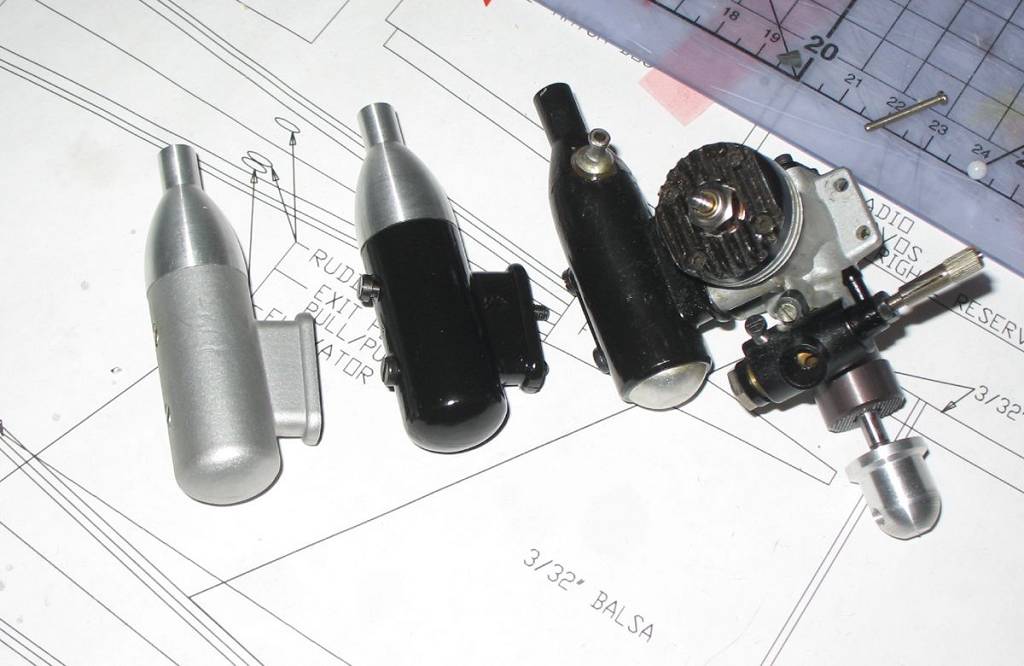

You may have gotten a new production item then. The extension I linked to in another thread (how many different threads do we need on this engine?) had a red label on it, and it is made in aluminium.
The mufflers have gone through some changes too throughout the years, I kind of prefer the latest plain coloured one;

NEXT ISSUE screw size originals with engine 2 lengths with the extension the longer original perfect fit at muffler front at rear the screws they sent to short for the front can only catch
a few threads about 1 1/2 turns with screwdriver very shallow grab martin
screw supplied 37mm needs to be 39mm they did not take this into account
go up 2 posts ( just above Mr Cox) for installed spacer

Yes, the extension comes with two equal length bolts, so the rear one will be a little short. Can't remember just how short it was but I think it would do two turns at least, might break easily in a crash though (and strip the threads in the case).
I think it will be a little hard to find long enough screws, so unless you need absolutely all of the extension, you could grind some off from the extension I guess.

The screws are regular M3 and can be bought long enough elsewhere. I found a brass one straight away in my tool box...

Mr Cox All set the screws that came with 37mm -the local Hobby shop has 3x40mm and 50mm that should do it can always cut the 50 but think enough grab with the 40mm
thanks for the offer but solved locally martin
