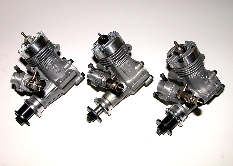

Martin,
That TT .10 is a nice engine.
It has a longer crankshaft thread than the OS .10 or Magnum .10 so you can use spinner.

Dan I lucked out, had he had 2 would have gotten both only one in stock, price very fair about 43UKPounds but you knock off 20% for the VAT tax over there, we do not pay it, do the math on the exchange rate and approx56 to 58 USD maybe 10 or 12$ shipping around $70 to the door, An OS10LA from Tower is $63 martin
I see your TT has a straight needle the one coming has that nice 45 degree offset to the rear

Hi Martin,
Yep, mine is a very early one so I would imagine an offset needle valve would be an upgrade to eliminate finger nipping.
If I remember correctly the guy who designed the Thunder Tiger 10 was an ex-OS engineer.
The Davis OS head is supposed to fit the TT and Magnum .10's.
