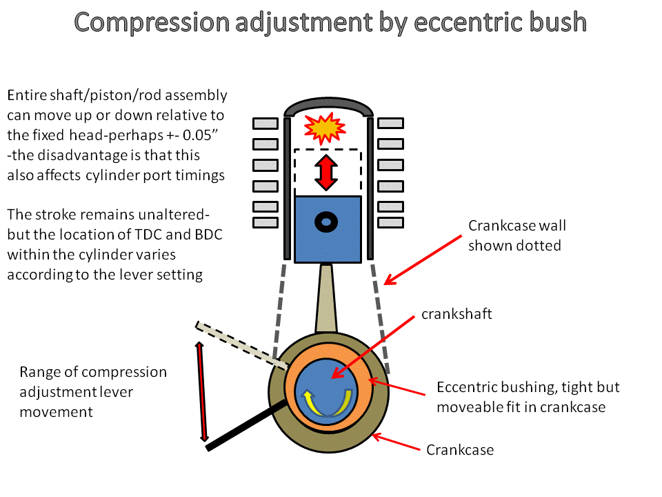

It's quite simple-there is no contra piston, merely a fixed head with a combustion chamber (or even a blind bored cylinder)-the crankshaft is carried in a bush which is eccentric-in other words-the OD and the ID of this bush are not on the same central axis-but offset. This bush can rotate within the crankcase............so if a lever is attached to the bush, the bush can be turned through perhaps a 45 degree arc of movement. This movement-because of the eccentricity-will cause the crankshaft axis to rise (or fall) as a consequence.....since the piston and rod are also attached, it follows that the piston will travel higher (or lower) in the cylinder as well-since the head is fixed, the piston will come closer or further from the head depending on where the lever is set. Simple-we have a way of adjusting the compression ratio.....
The limits are set both by the orientation of the bush within the crankcase-and also by the limits to the lever movement-in some engines it operated in a slot in the casting itself-so the length of the slot limited how much lever movement there was, or in a cutout sector of the crankcase nose-again the length of the arc cutout limited lever movement.
I'll try and put together a diagram and post it later............
ChrisM
'ffkiwi'
Edit: diagram added

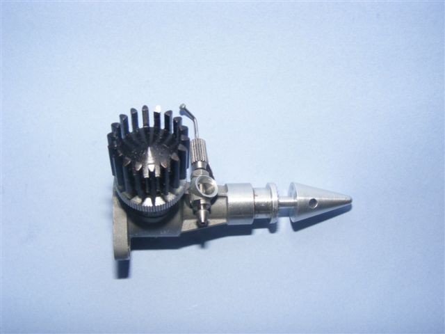

While we're on the subject-not too many of you will have seen one of these [see pic]-a John 0.35cc-there is no movable contra in this one either-compression adjustment is achieved by screwing the cylinder up or down in the crankcase (locking being achieved by the knurled ring)...........again, in theory this too will alter the cylinder port timing..........in practice the engine doesn't seem to care...........!

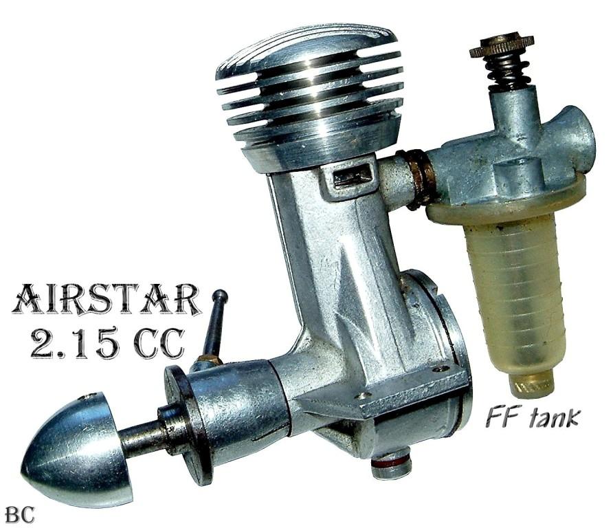

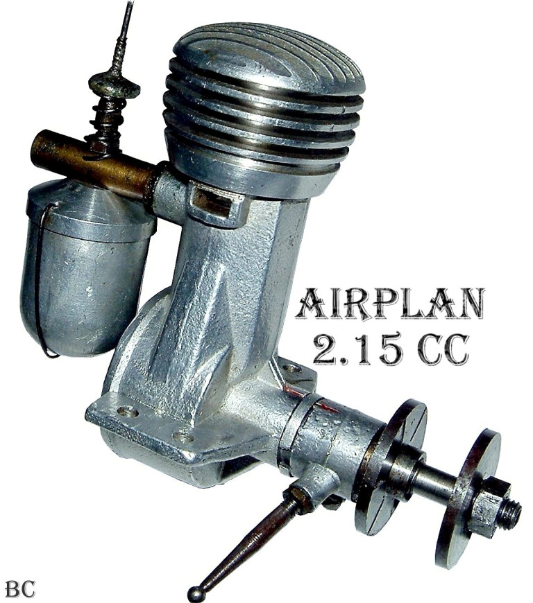

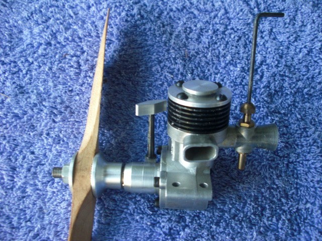

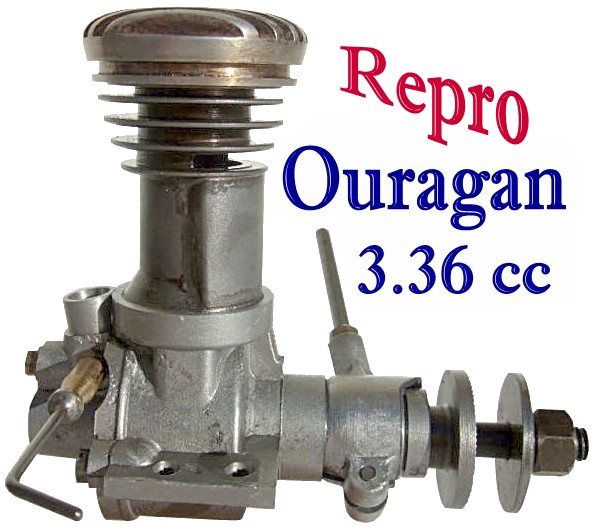

Here are a few more. The repro engine isn't mine, but the others are and they all run well.
