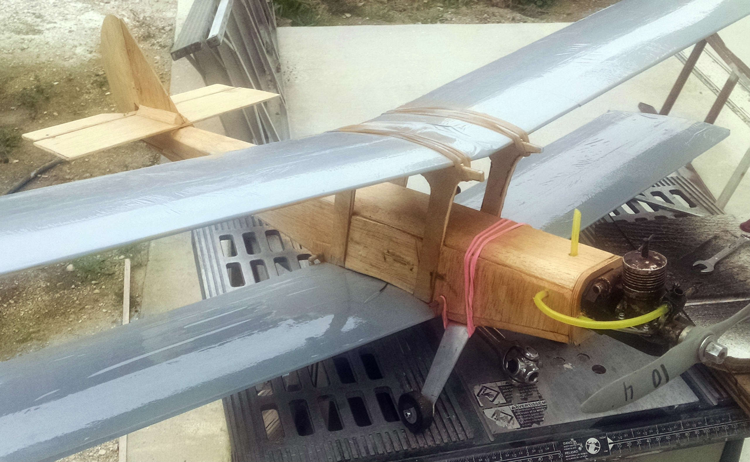

I like the PAWs a lot too, but its the vibration
rather than the smell that bugs me. Mine haven't
been as well balanced as other brands.
On an undersized plane, with less mass to
dampen the vibration (regardless of lower
throttle) the elevator servo seems to wear
out too quickly. It would be the rudder on
one with a horizontally mounted engine,
though just as fatal on a 3 channel plane.

I tried an unbalanced prop, but with unbalance on the
blade so far from the crankshaft, it was very RPM
sensitive, with the lowest vibration point at one
particular speed. This would work on a control
line plane but not on RC.
I ended up drilling a hole in the prop hub
(on the prop, not on the engine prop drive)
and sticking some lead in it. I also ground as
much extra metal as I could from the pin
side of the crankshaft. Together this was
an improvement, but not as good as a
properly balanced engine.

Of course the servos are shock mounted with
rubber grommets. The vibration is entering
through the servo arm.
The up and down vibration of the engine causes
an up and down vibration in the elevator, which is
translated to a continuous push pull vibration in
the pushrod. This causes premature wear in the
servo gear teeth and bearings.
The elevator is made of the lightest possible balsa.
It is mounted with pin type hinges for freedom of
movement. Easy hinges could possible reduce
the elevator's motion, but would be a difficult
modification with the wood already full of epoxy.

You would think that a balanced propeller could
be mounted in any direction. In theory it is true,
but a prop that is statically balanced, may not be
so well balanced when spinning. If there is a little
extra weight near the hub on one blade and a little
extra near the tip on the other it could look perfect
on the dubro balancer. At 10,000 rpm the heavier
tip would have more momentum and try to pull
the engine off center.
It will do this regardless of which direction it is
mounted. It will, however, add its own vibration to
that of the engine if mounted straight up at TDC.
It will subtract from the engine if mounted straight
down at TDC. Since the prop appear balanced,
you need to try both directions to find which one
is better. some props are so good you can't tell
a difference.
The propellers I use are pretty good in this respect.
I usually mount the propeller so that when the
engine stops, the prop is in a near horizontal
position (so it doesn't break in deadstick landings).
The PAW engines NEVER quit in the air, so this
is not an issue. On these engines, I mount the
prop in a direction to make it easy to flip start.
Then I mark where I want to add the lead weight.
After I weight the prop, I mount it in the same
orientation.

My plane is powered by a .19, possibly the same as WNewbury's,
though changes have been made over the years. There is nothing
actually wrong with the engine. It is just a shaker.
The pushrod idea won't work. The push pull force will still be
there. That is how the elevator works. If the secondary arm
was very flexible, it would absorb the vibration. It would
also allow the elevator to flop up and down and encourage
flutter.
The only thing that would work is mass balancing the
elevator. That is too much engineering for such a small plane.
This problem is not one to fix, but one to live with, kind of
like being short.

The small ones seem to help most on 40 to 60 size
two-stroke engines. I didn't try the large ones.
My biggest engine is a 91 surpass. It ate through
the rubber on the small mounts pretty fast.
I used to have a source for even smaller ones,
but I don't remember where. After several
failures I gave up on them.
Jenny

I wonder if the issue is something other than an inherent vibration problem with the PAW 19. I've used a number of these extensively over the years, and have never had an issue with vibration, even when using 3/8" square bearers of modest length. What size prop are you using? Perhaps the engine would be happier in a different rev range.
Join Date: Jan 2015
Posts: 280
Perhaps the vibration is inherent only to the engines
I have. The .15 that was on the same plane
(before the .19) was also a shaker, just not as bad.
The .19 is 23 years old, and the .15 is 25 years old.
Hopefully some design updates have happened.
since then
Jenny
