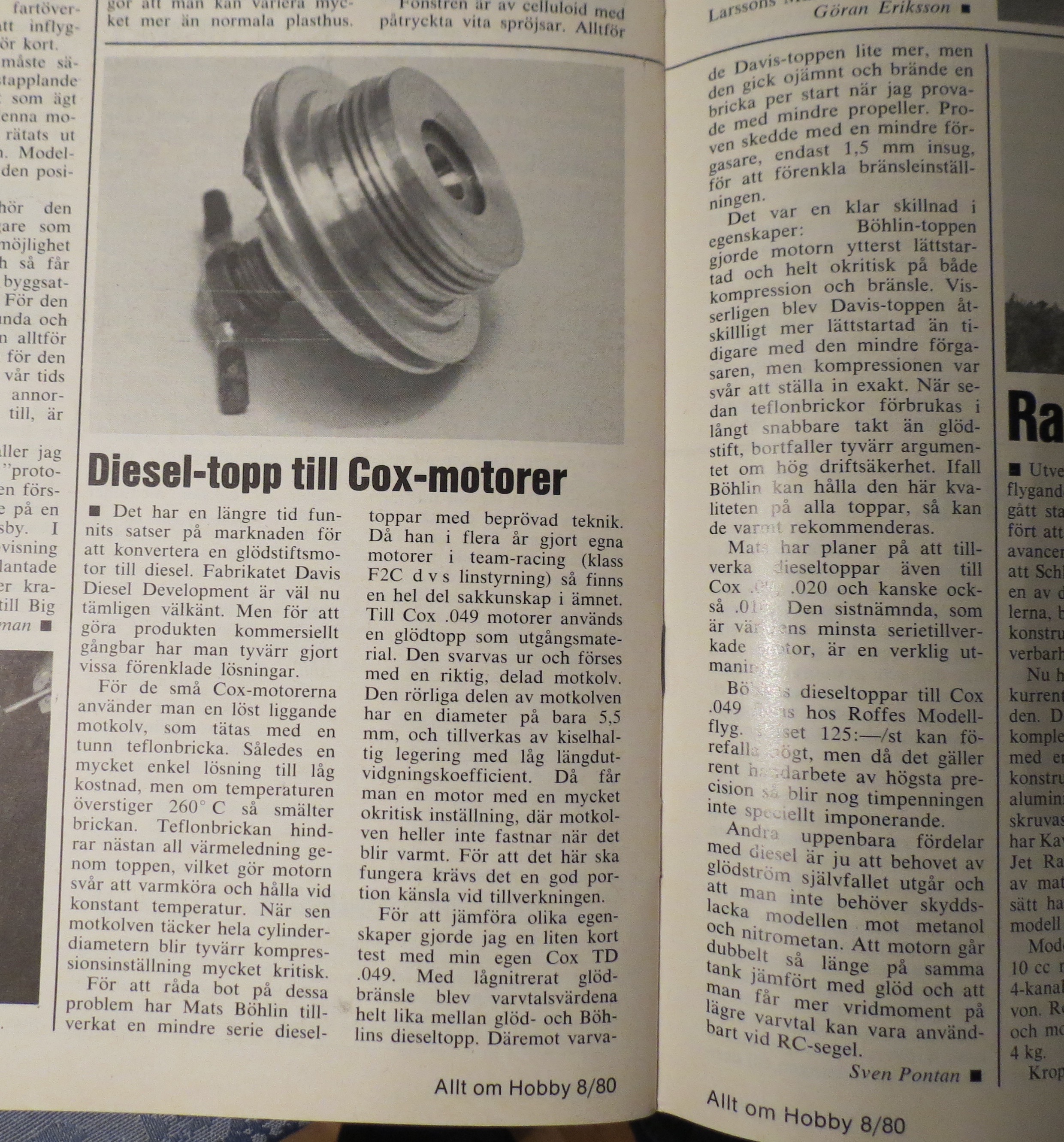

I have never been able to burn out a disc, instead they leak around their periphery. If you bring the piston to TDC and hold it there, yuo will see this as a rather rapid loss of compression, much like a worn piston/cylinder would behave.
By replacing the Teflon disc with a metal one, you can in contrast get a fully adequate seal around the periphery and a much slower loss of compression when held still at TDC. The compression setting on the head screw will now be lower for starting the engine, compared to the Teflon, hence also more gentle running for the engine.
Around 30 years ago there where also other conversion heads for Cox engines, with better performance but at a higher cost. There was for instance a Swedish product which consisted of a classical iron contra piston running in a steel head bore, much like in a classical diesel, that outperformed the DDD ones.
So 30 years later I see no reason to continue to fiddle with those silly Teflon disc that never did the job well. Most engineers would get this without even trying to run an engine with it....
Correction, the head was made from a high silicon alloy and they where made by Mats Böhlin in the eighties.
Below is an engine test from August 1980, comparing a TD on glow with the two conversion heads. The DDD heads where too sensitive on the compression screw (possibly due to a poor heat conduction and the large contra diameter) and didn't give any stable setting. The disc had to be replaced very often, in fact on every start when a "smaller" prop was used...
