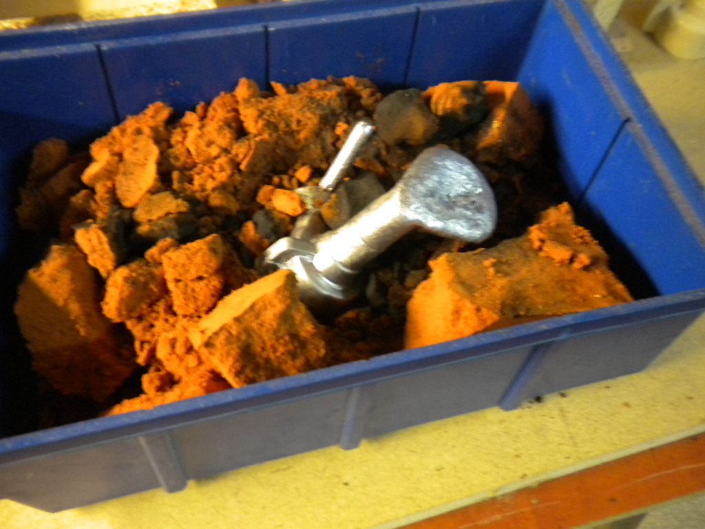

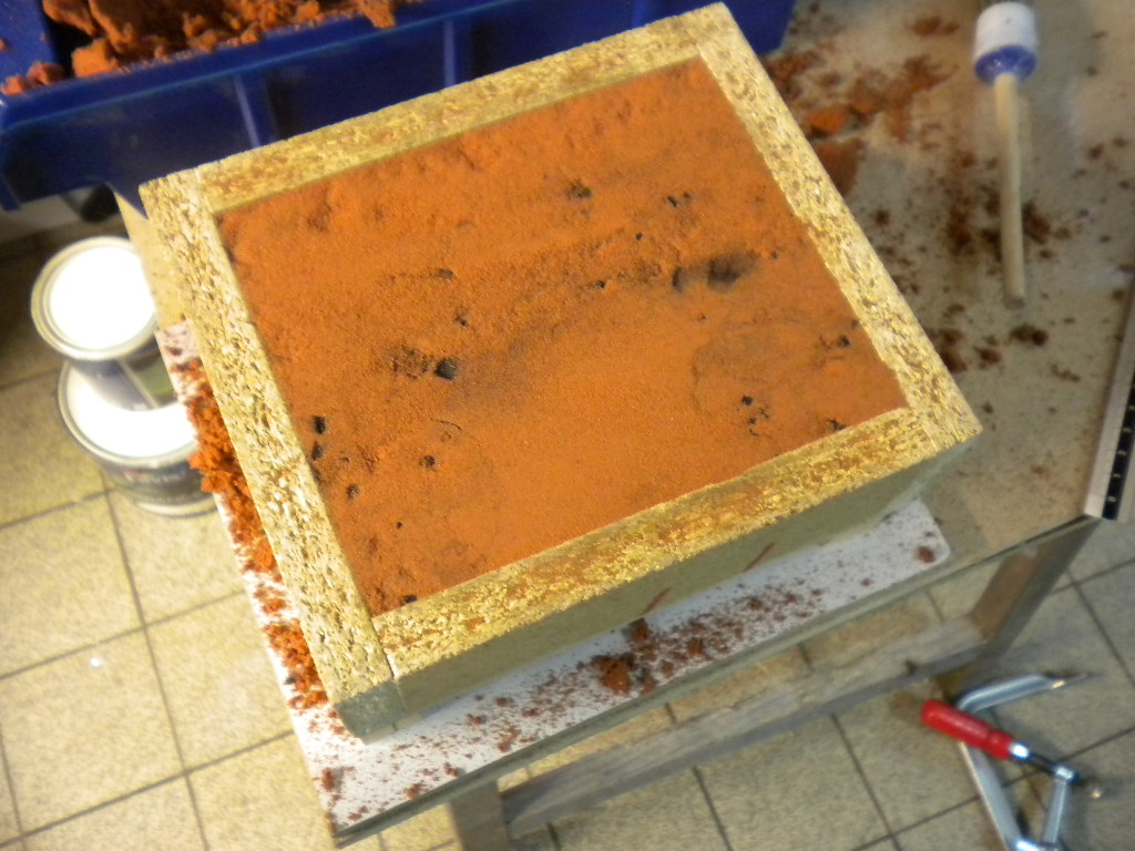

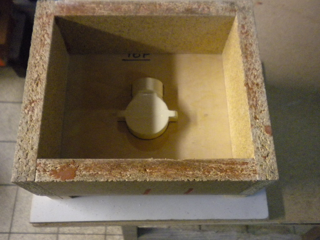

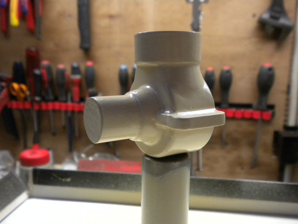

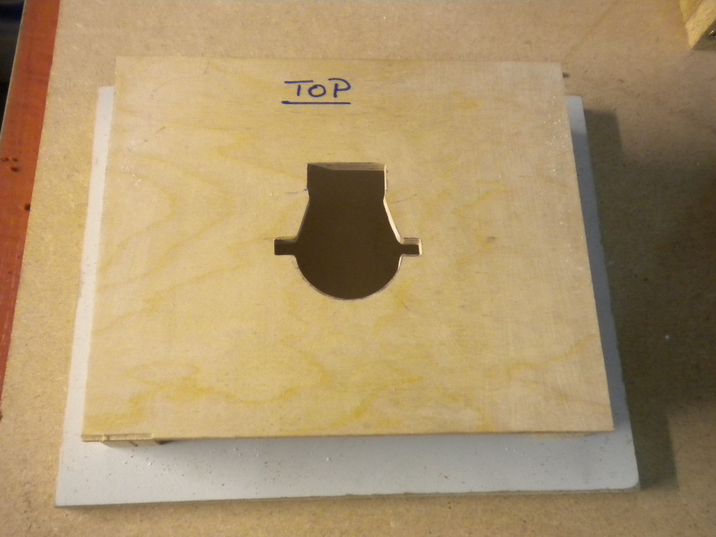

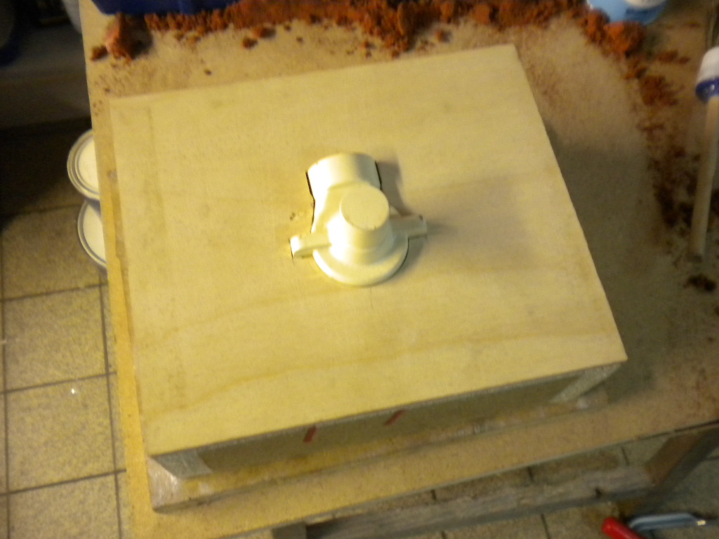

I have start the build of an new(old) engine , the "NOVA 1"
It is a 4,5 cc diesel designed by a Dutchman I.J.v.Leeuwen in 1943 , during WW2
I have made my own castings for this engine , it was my first attempt of aluminium casting but it's actually pretty good
Here are some pictures of the casting procedure
Greetings Jef

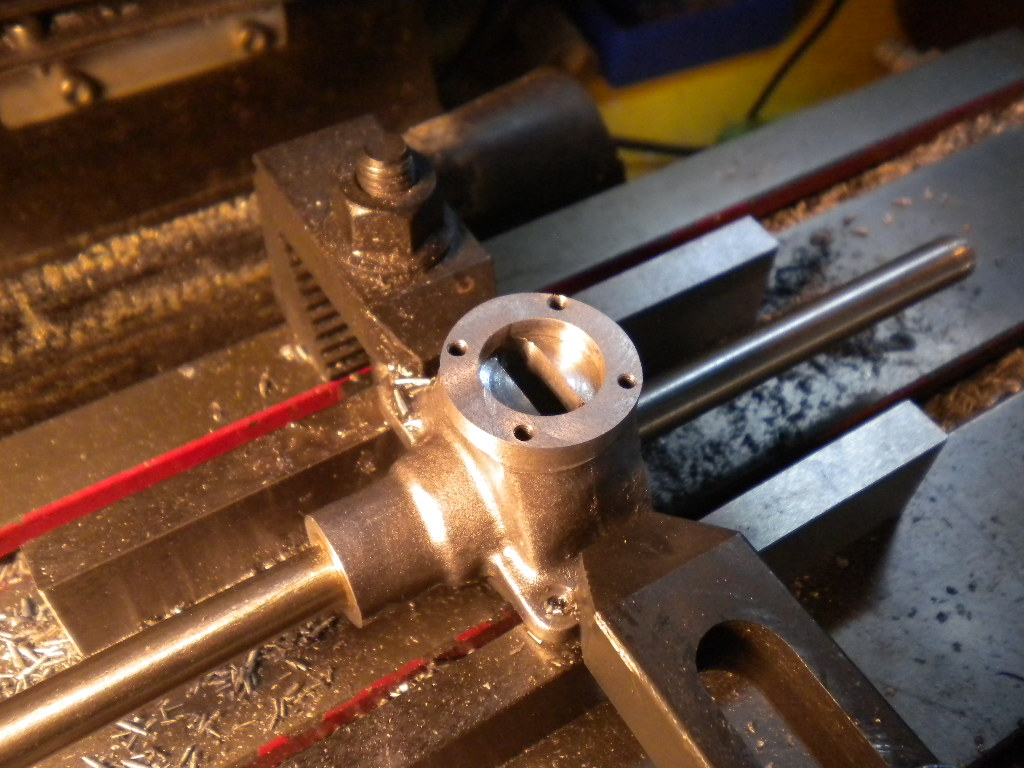

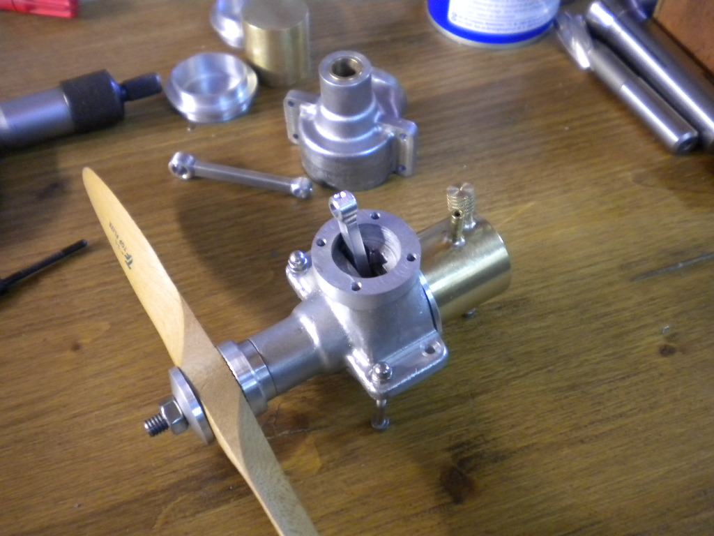

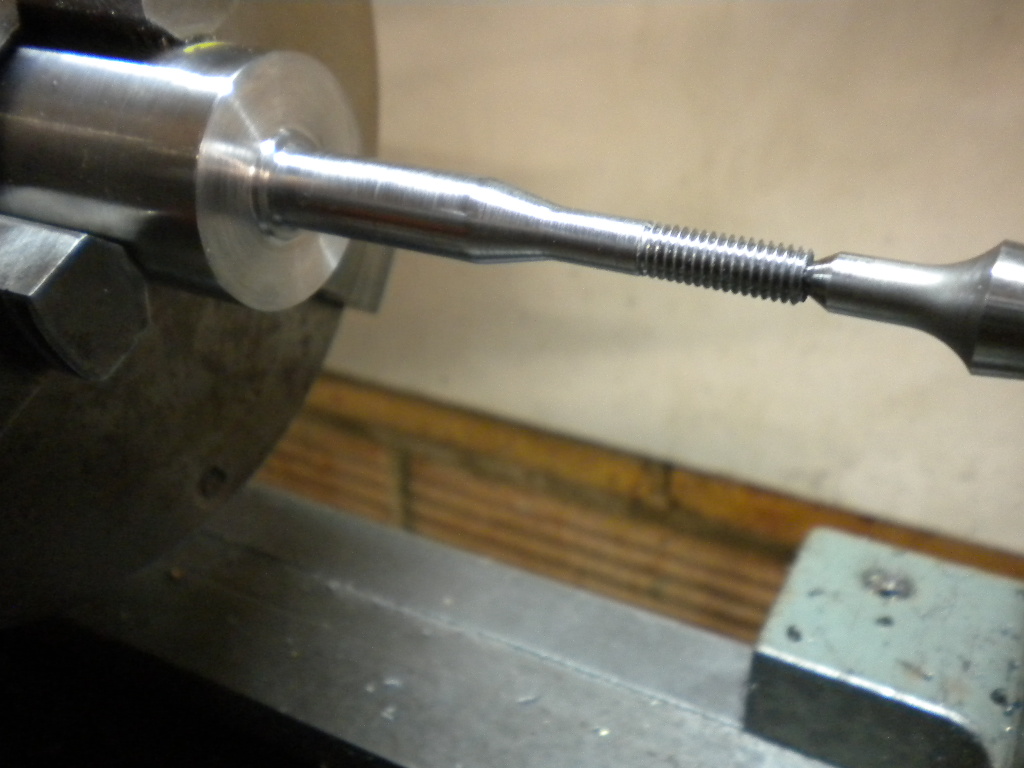

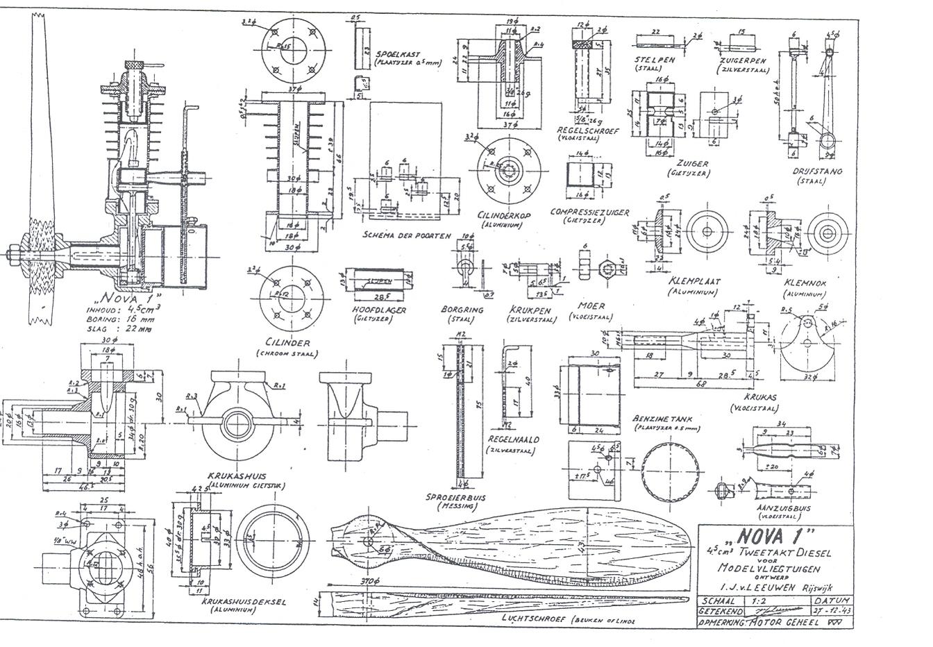

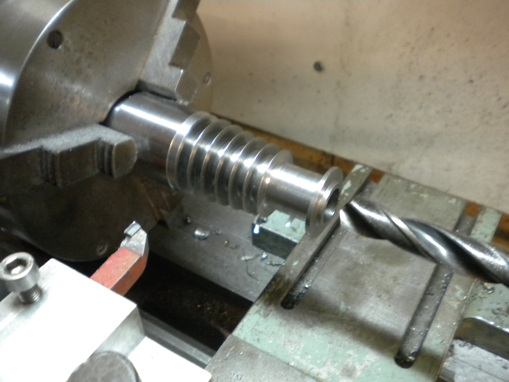

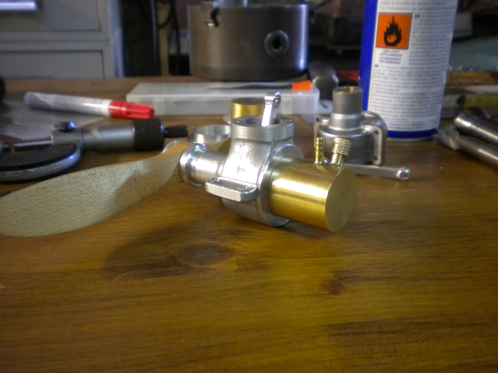

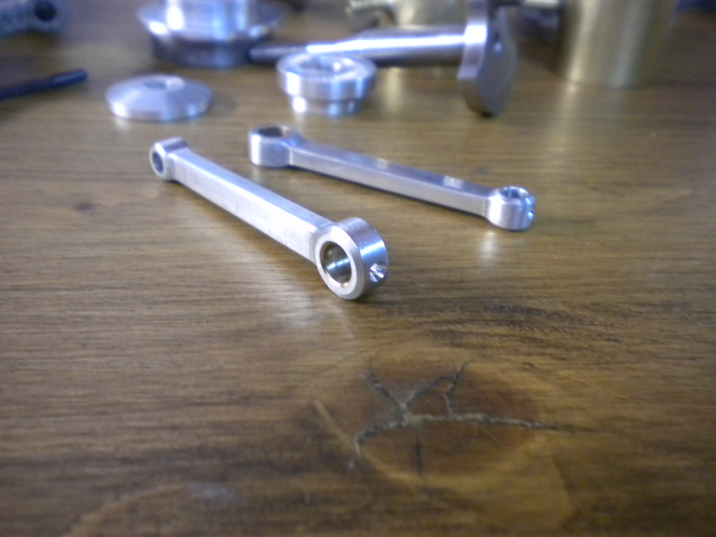

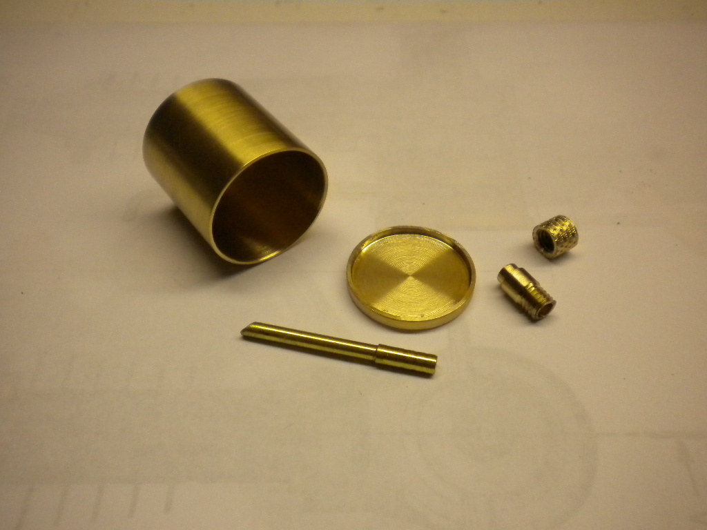

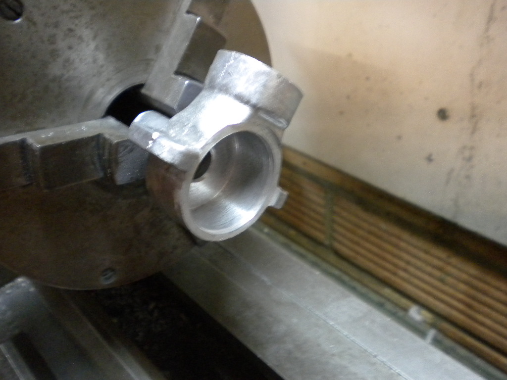

I have made some minor changes to the original design , for example , the cilinder wall was only 1 mm thick in the original design
The original plan
Machining the cranckcase
The fueltank
Cranckshaft
Conrod
The engine parts that are finished so far
Greetings Jef

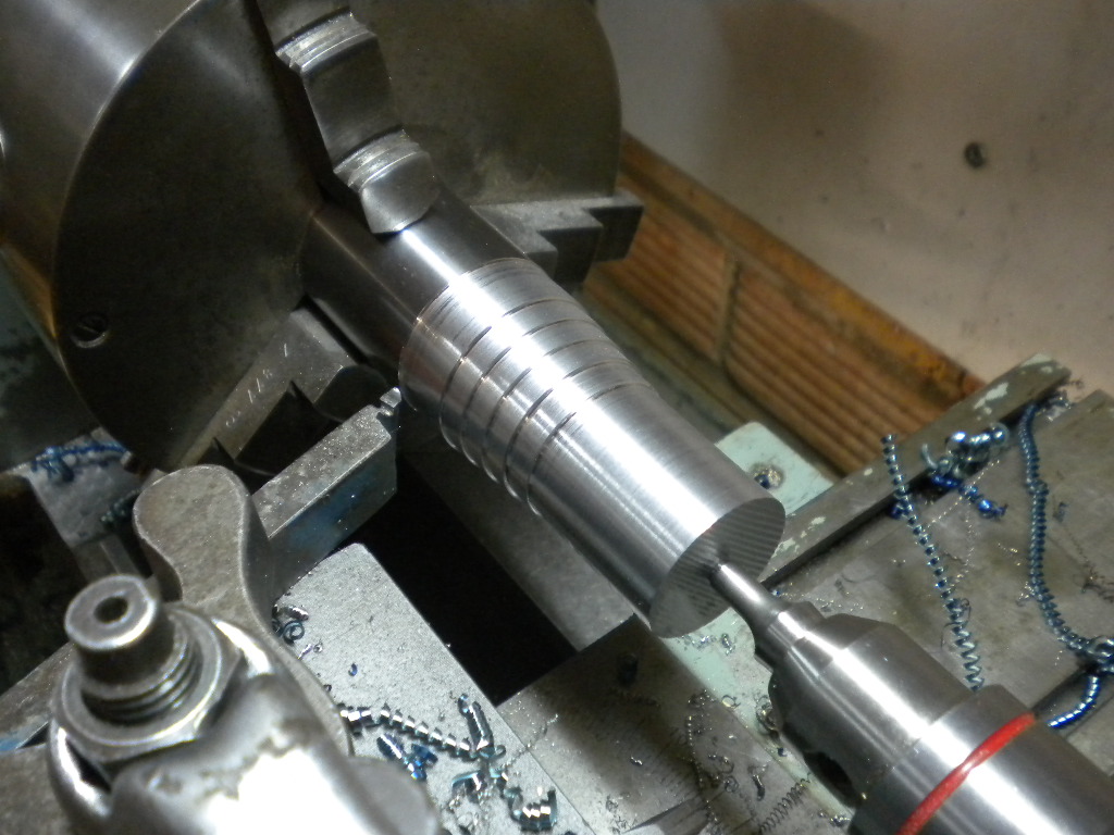

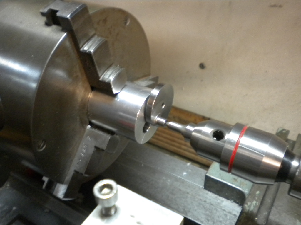

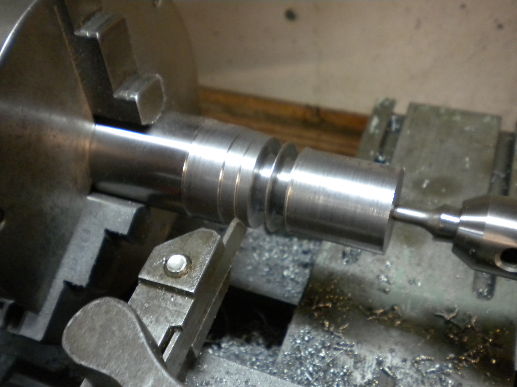

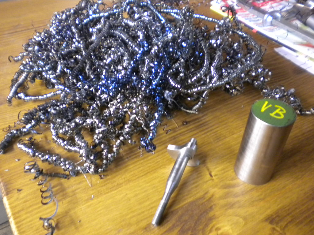

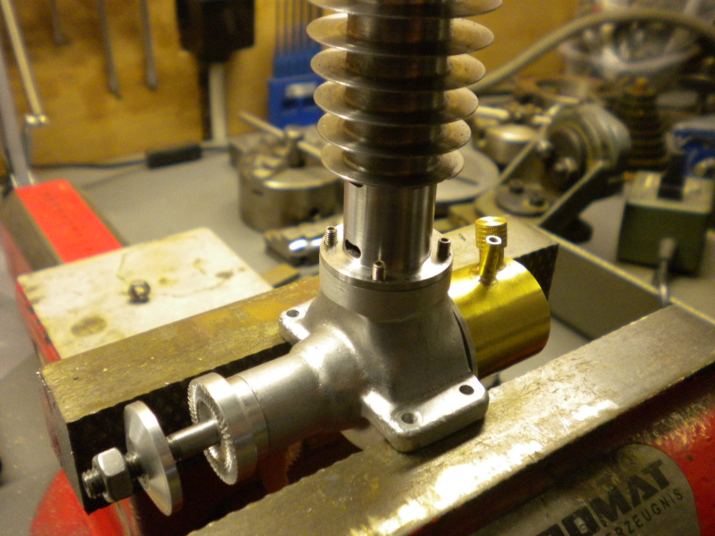

I've started machining the cilinder , it's quite a job turning the 42CrMo4 steel and the cooling fins are only 0,5 mm thick , that's only 0,02 of an inch
Greetings Jef

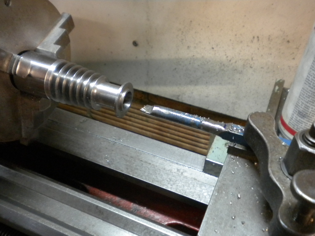

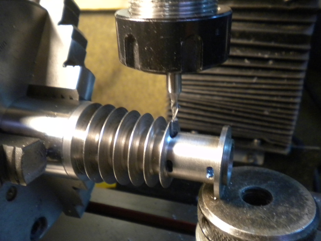

A bit of progress on the cilinder
Greetings Jef

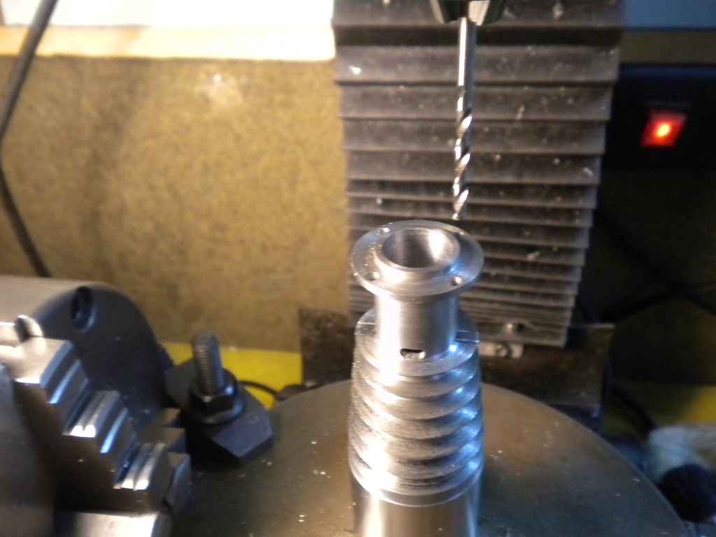

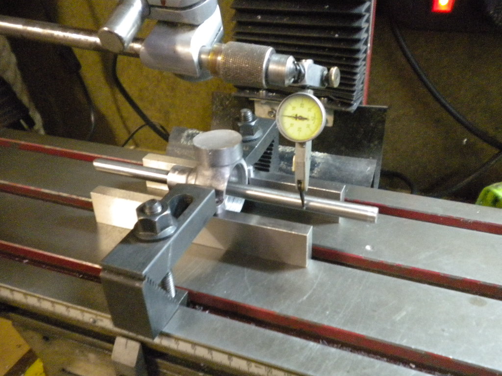

Again a little progress on the cilinder , milling the inlet- , exhaust- and transferports , drilling the holes bottem flange cilinder
Merry Christmas and a happy 2016 , Jef
