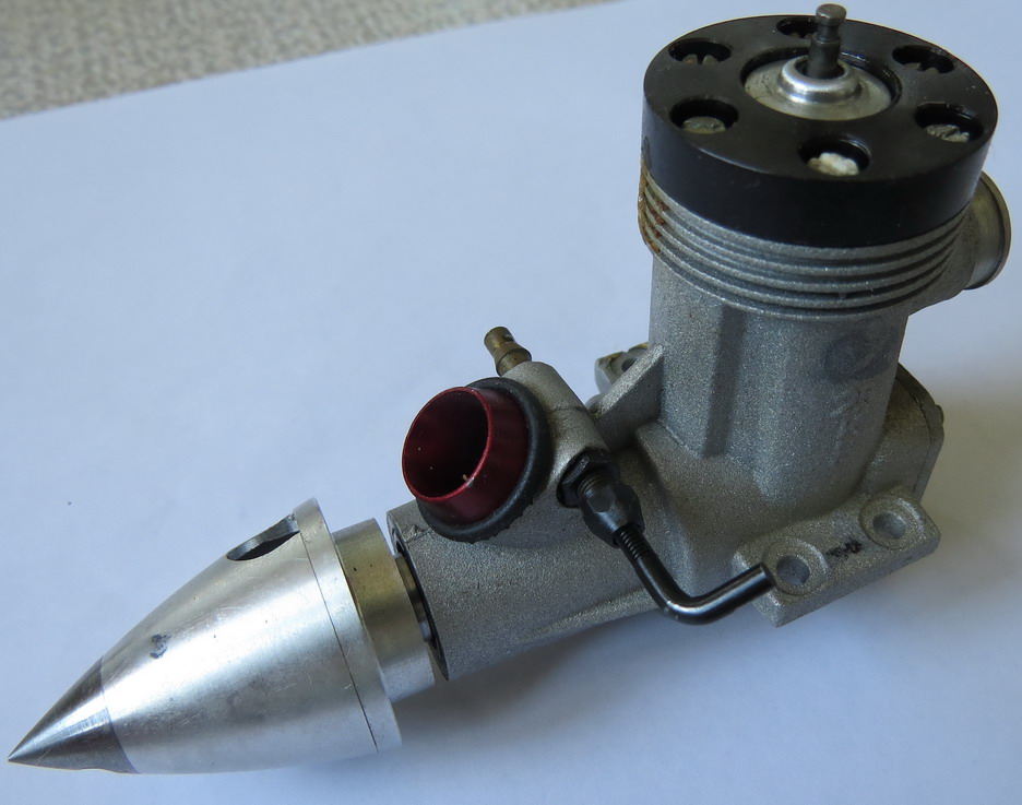

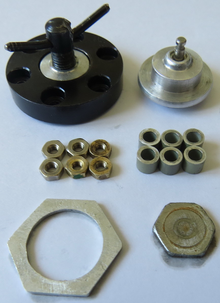

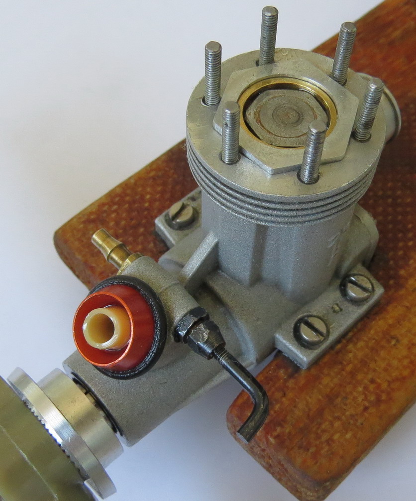

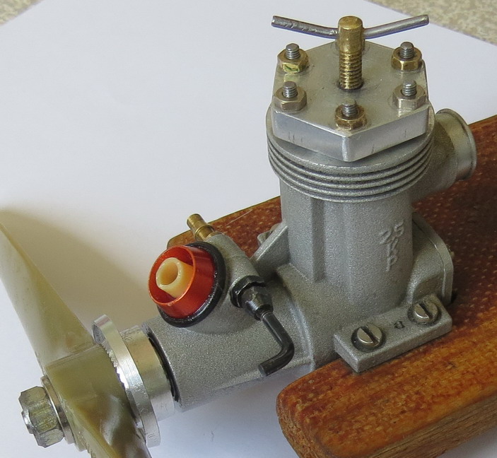

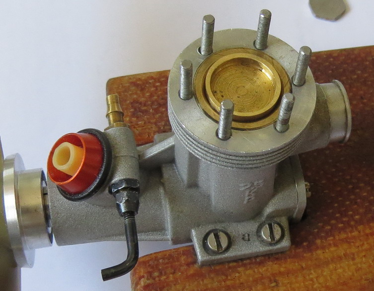

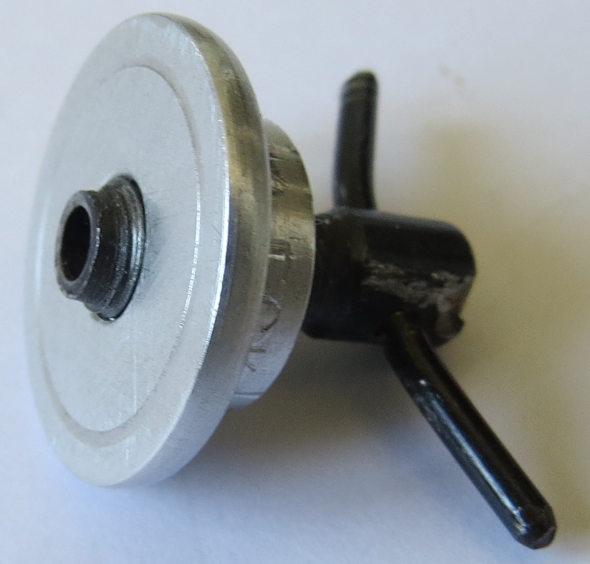

Dear All,
I present You my diesel conversion of Russian glow plug engine UCSTKAM 2,5KR. I make this without lathe with help by file, hack-saw and hand drill. The counter piston execute from 15mm valve of water tap. There is two arrangement of head of cylinder. Two arrangement of counterscrew head execute from old glow plug.
Best Regards.

I suspect that the UCSTKAM 2,5KR is a Rossi mk2 clone. A Parra 15 diesel push/pull head should fit with just a little fettling. They're available from Parra for about 30 Euro. Actually the Fora 15 Junior diesel is a real powerhouse for less or about the same cost as an UCSTKAM. I don't mean to denigrate the achievement of diesel converting one of the latter with hand tools though. Nice work :-)

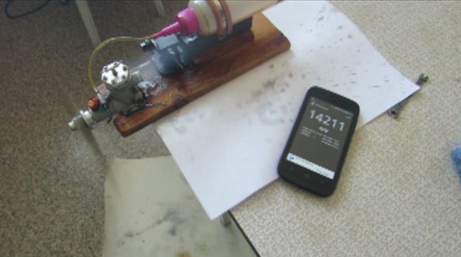

Dear All,
The tests of this conversion to diesel was be with fuel:
-Arrangement 1, Diesel fuel-33,3%, Aether-33,3%, Mineral motor oil-33,3% without additives. Many smoke.
-Arrangement 2, Kerosene-33,3%, Aether-33,3%, Mineral motor oil-33,3% without additives. Little smoke.
