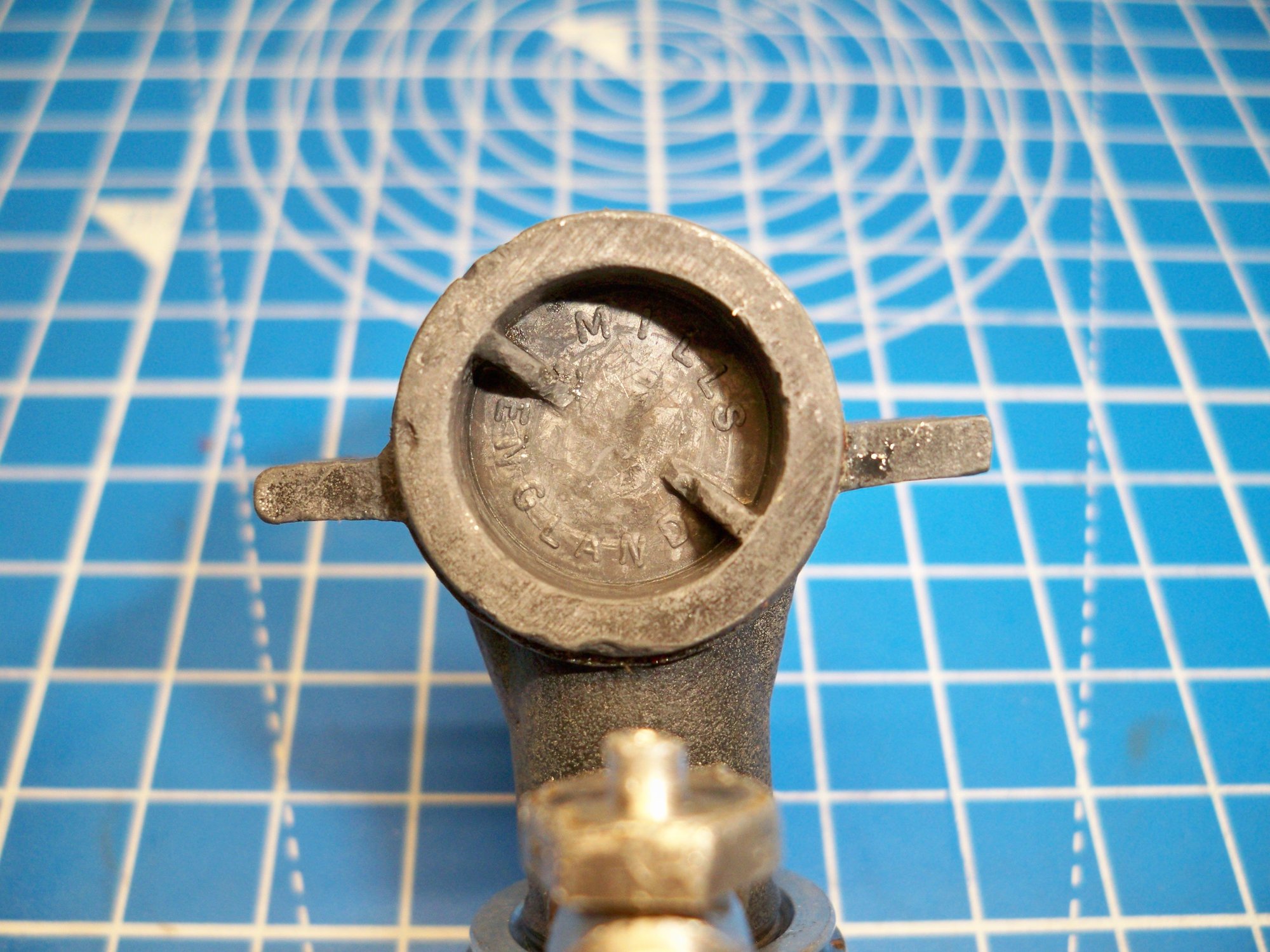

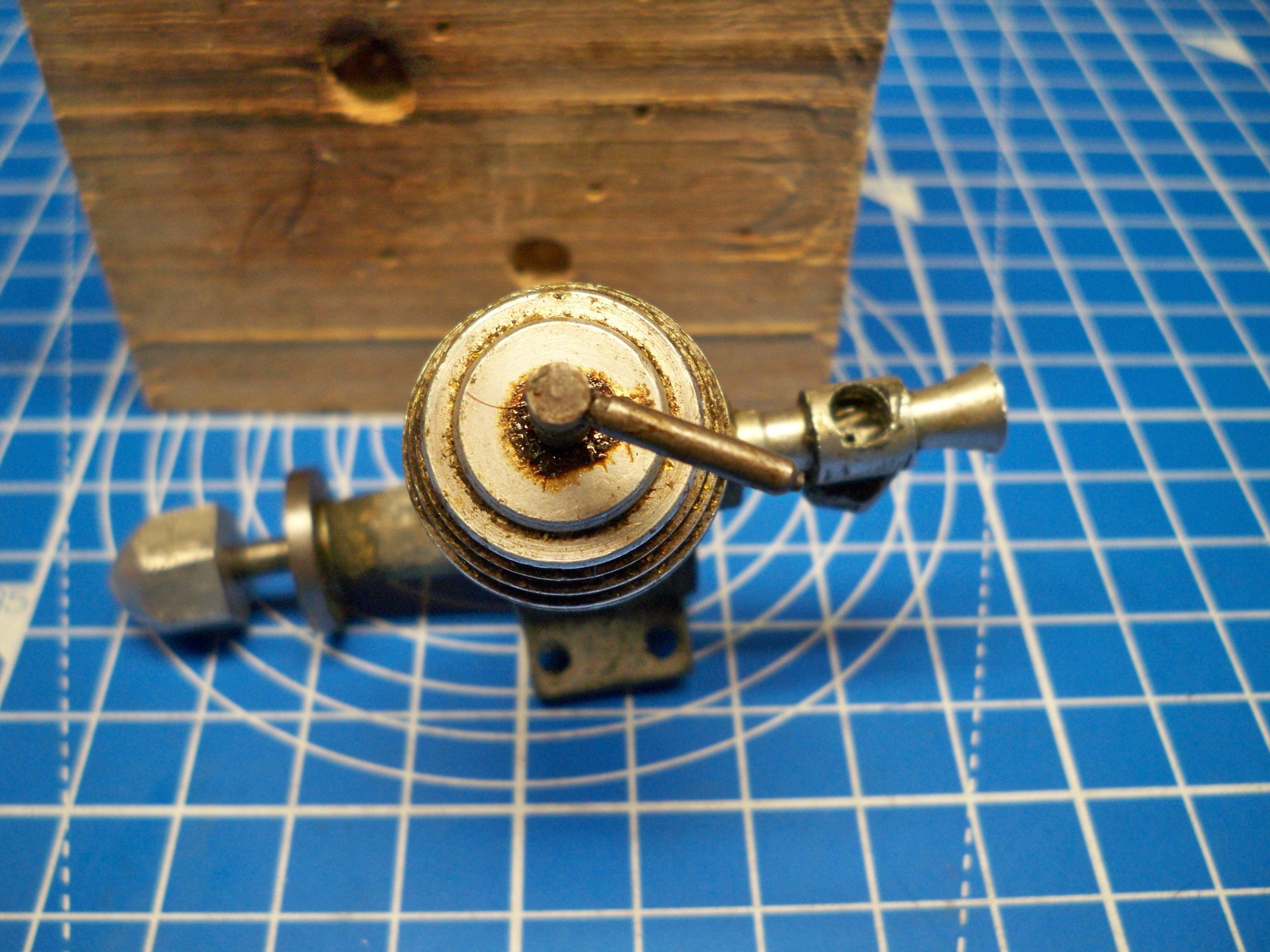

Hello from Italy,
I've got a lot of glow engine with a couple of diesel ones as well; I know all of them except this little diesel engine in the pictures.
Does anyone can give me any information about?
Thanks in advance, regards from Italy
Luca

Looks like Mills .75 Series 2

Hello,
many thanks for yout hint!
Looking on the web for the Mills .75 my engine look it could be the same
Thanks again
Luca

After a quick clean I can say that you were 100% right....it's a mills engine
Just wondering about the numbers on the crankcase (511 and 72); maybe 511 it's a serial number but 72? maybe a .72ccm version??
Thanks again for your help
Luca

The numbers on the lugs are simply a serial number-the number is read 'two digit' then 'three digit' -the two digit being the batch number, and the three digit number the individual number within that batch. There is NO way of dating the engine from the serial number=other than in a purely sequential fashion....ie a higher batch or individual engine number was manufactured later than a lower one...
Your engine is missing quite a lot of carburettor parts.....
ChrisM

Hello Chris,
thanks a lot for your explanation about the numbers on the lugs!
At last it should means that this engine is an orginal ones and a not a replica, am I correct about it?
Thanks again, regards
Luca

Originally Posted by baronerosso
Hello Chris,
Luca
Yes it is an original-you are missing the tank top,tank bowl and the needle valve assembly (the needle and friction spring)-and the jet assembly itself does not look to be in particularly good condition. You would need to locate both those items to get the engine into workable condition-and the tank top (or a washer of identical thickness to the tank top) is required because the jet assembly screws into the intake from below-and the hole through the intake tube passes through the jet assembly-and is drilled AFTER ASSEMBLY-ie after the jet assembly is screwed into the air intake tube-so you cannot just screw the existing jet assembly further in till it bottoms out on the intake-the through hole will then not be aligned...so even if you want to use a Mills 75 with an external tank, you still need the tank top to remain in position. There were two distinct models of the Mills 75 mk2-the S.75 (='standard') which had a rotating cutout between the venturi and the tank, and the more commonly encountered P.75 (='popular') which dispensed with the cutout-for obviously reasons the jet assemblies on the two variants were slightly different.
ChrisM
