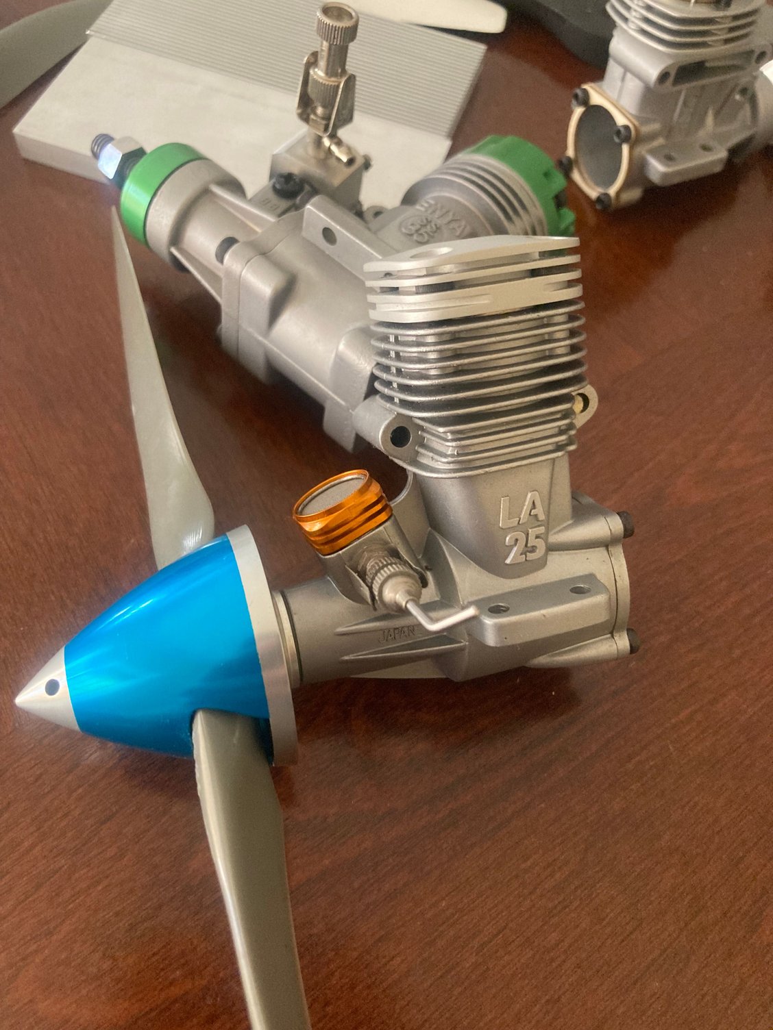

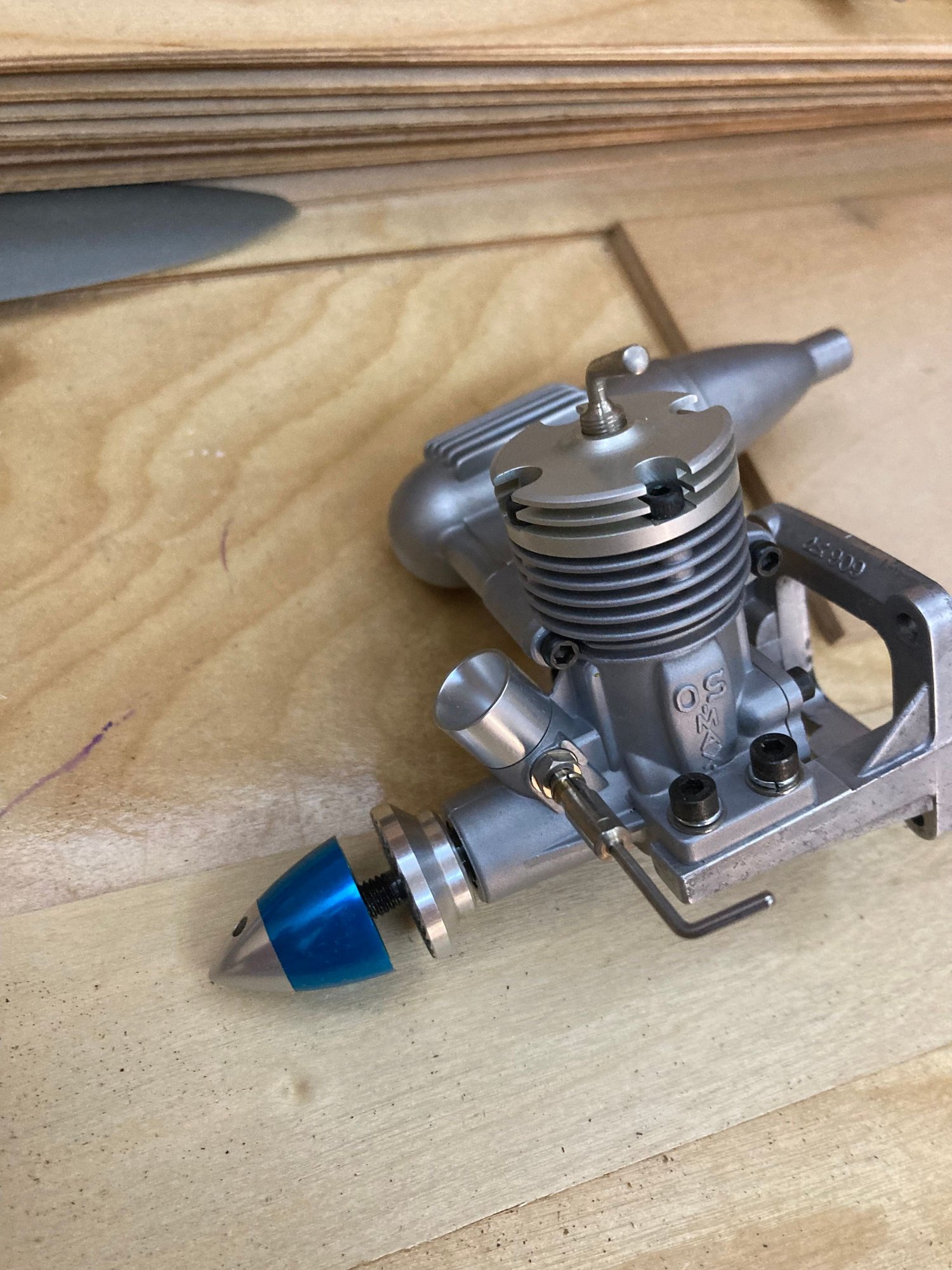

Default There some samples
Originally Posted by themakerD
Indeed, there is conversion heads, and they are American made for:
Enya, OS new and old (cross flow), Super Tiger, ASP, MVVS, etc.
Enya 30 ss
Enya 30 ss
Os 32 s, lapped piston
Os 10 fsr
Os 10 fsr
Os 25 la
Os 25 la
