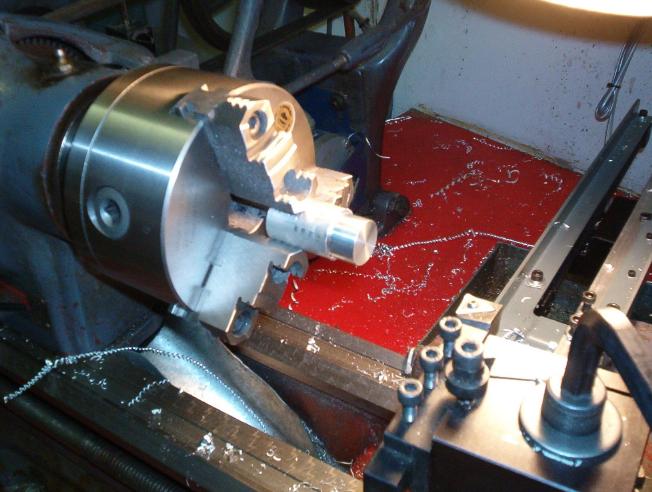

OK guys here is a picture lesson on how to make one diesel conversion head.
Step # 1, size the aluminum bar to the head outside diam...

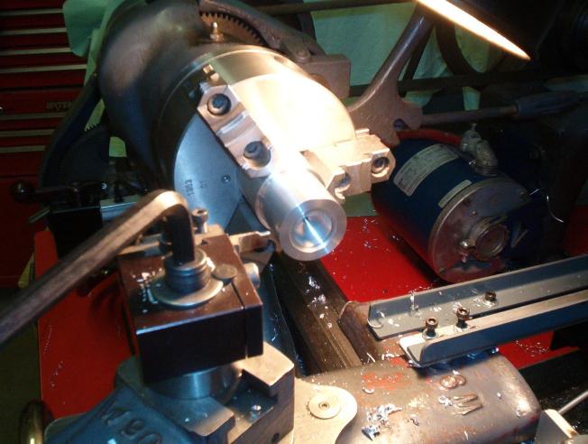

Step #2, bore out the interior of the head to the same ID of the cylinder, and step the bottom to fit over the cylinder top..

Step #3, part off the head blank, turn around in the chuck and face the top, round the outside edge, and drill/tap the head for the 10-32 adjustment screw...

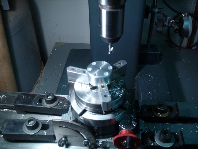

step #4,
DRill the holes for the head bolts - I use a small rotary table for accuracy.

Step #7 - rough the contra piston blank to 1.5 to 2 thousandths under the cylinder bore

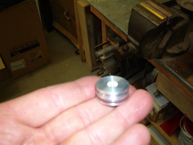

After finishing the O ring grooves, turn the combustion chamber side, then part off the contra piston, turn it around and face the top and use a ball end mill to make a dimple that the adjustment screw will sit in.
Old 10-16-2003 | 09:03 PM
My Feedback: (10)
Joined: Jun 2002
Posts: 4,236
From: Timmins, ON, CANADA
Default RE: anyone interested in....?
Step #10, install the O rings and check the fit of the contra into the head. Use grease to let it go into the head without damaging the rings

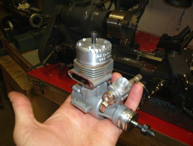

The engine with newly made head, mounted and looking sharp
ID:	68106   Click image for larger version

Final step, put it onto the test stand, fill the tank with some Davis Diesel mix and prime. If you are lucky - and I was... - it should fire and stay running after a few flips!!
The GMS was very easy to adjust. I had to close the Low speed needle 1/4 turn, and close the high speed about 3/4 turn. The contra was adjusted, and hot restarts were easy. Compression is tight and snappy, makes starting easy. The throttle response was way better than any of my 4 Irvine 40 diesels I had.
Only time will tell how this engine holds up and runs as a diesel, but as you can see the head was no biggie to make. Total time was about 3 hours of liesurely machine work.
I was runnign an APC 12-7 prop, but due to it being dark, I couldnt tach it. Sounded lovely though!!

I made the contra piston 3/8 thick. The head itself is 7/8" thick. The bore for the contra piston is 1/2" deep and the step that sits on the top of the cylinder is 1/16" deep, so measured from the lower lip the bpre for the contra is really 9/16". Follow me? That leaves 5/16 on the top of the cylinder and I cut the fins about 3/16" deep (leaving 1/8" solid material)
I used a 10-32 machine screw for the adjustment.
One thing, you may notice differently that I do, is "key" the head using the outer diameter of the cylinder sleeve, and make the bore of the head the same as the sleeve. The contra can then move up/down in the head and sleeve - the head effectively lengthens the height of the sleeve.
Unlike other conversions (DDD for instance - if I make out the pics correctly) that use a smaller diameter contra than the cylinder bore, and the head fits into the cylinder sleeve like a normal glow head.
AJC
