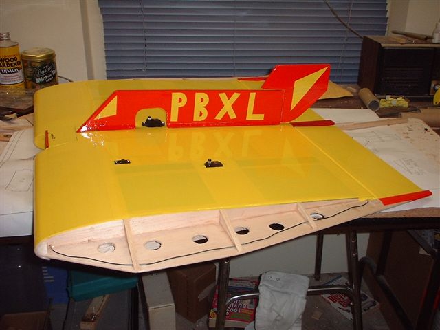

I finally got my Davis Diesel head for my FOX .15. I tried it on an APC 10x3 prop and got 11,300 RPM. I hope with more tweeking I can get more I will try a Zinger wood 10x4 next. Hope it will hover @ 2 and 1/2 Lbs???
Oily in Germantown
Francis Person

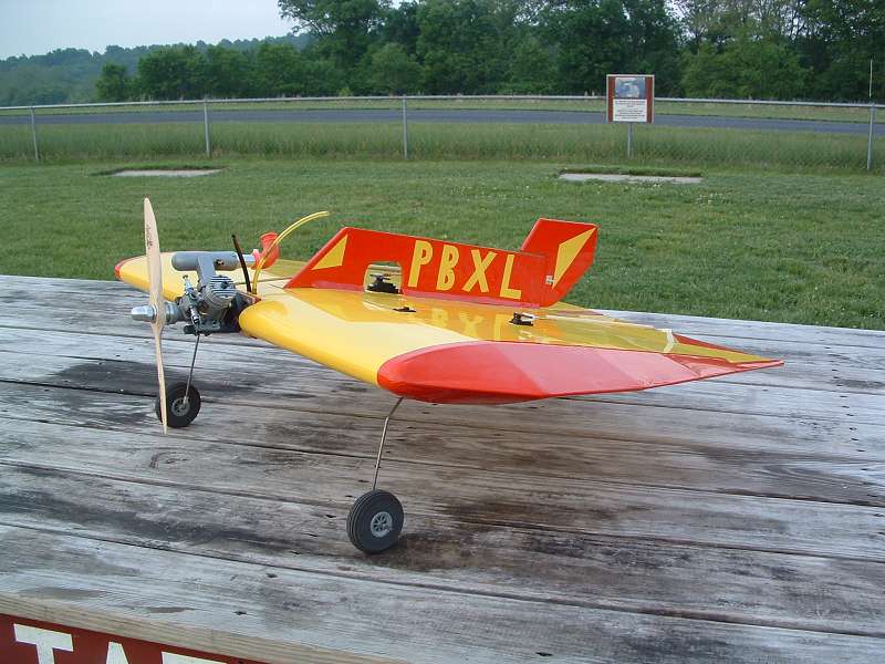

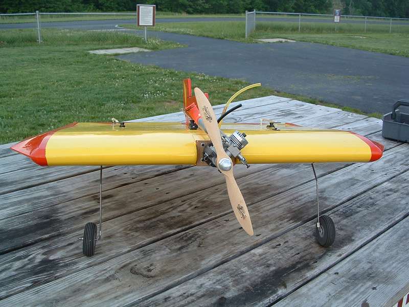

It Fly’s!!!
The Fox .15 with Davis head is GREAT! It will turn a 9x4 black MAS prop at 13,000RPM, transitions well and has a reasonable idle. At half throttle it cackles, but it spins up as soon as I hit the stick on the left.
Francis
