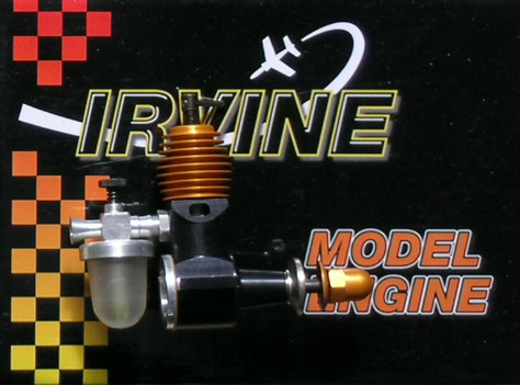

The Mills 75 Mk1 was introduced in 1948. The crankcase was manufactured from solid and has the angular look that you see in the first photo below. This version is extremely rare to find today.
The Mills 75 Mk2 came onto the market a year or so later and has the cast, more rounded crankcase, like the Irvine replica that you see in the second photo below.
The vast majority of the Irvine Mills 75 replicas are of the later, cast version.
Irvine did also produce a small run of Mills 75 MkI replicas – to confuse matters Irvine calls these engines the Irvine Mills 75 Mk2…..
The last of these had gold anodized heads, see photo 3, below.
The Mills serial numbers are confusing. I have seen them explained somewhere in an article, by P.G.F. Chinn I think it was. Maybe someone else out there can find the reference?
Tomas H.

Old 11-09-2005 | 03:24 PM
juxy2's Avatar
Joined: Nov 2005
Posts: 42
From: EXETER, UNITED KINGDOM
Default RE: Mills .75 Serial Numbers
Many thanks, at least I have the Mk1 / Mk2 question answered. It seems that one could have a significant numbers of engines, not to mention a significant financial investment, by just collecting Mill's .75 variants - but it's not hard to see why this endearing little engine remains so popular.
