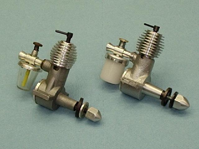

Apparently you don't come here often, here are some of my engines. both total builds and restorations.
Do a search on the Vivell .09 and read the thread titles below
Next Project
Vivell .09 Diesel Finished!!
ID:	360237   Click image for larger version
ID:	360238   Click image for larger version
ID:	360239   Click image for larger version
ID:	360240   Click image for larger version
ID:	360241   Click image for larger version
ID:	360242   Click image for larger version

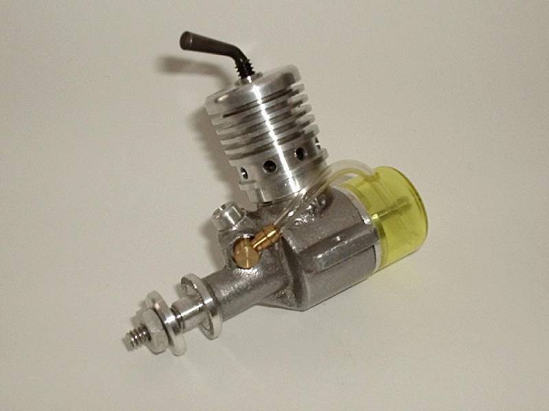

It's not surprising that responses to your post have been luke warm to say the least. FWIW, [link=http://modelenginenews.org/index.html]Ron's Site[/link], (the edu site you refer to above) is probably one of the most complete resources of model aircraft engine building that you can find on the web. Take the time to browse Ron's site and I think you'll have a different opinion.
Jeesh... if what you say is true, then I must have been dreaming when I thought I built these.
-Joe
http://www.geocities.com/joby1967200...-1/NGEZ-1.html

Joe,
The engine on the right looks like an EmBee or a PMC Imp. I am getting ready to build the Imp and wondered if you'd done any timing changes to it.
The other looks like the Lil' Dragon in diesel drag. Nice looking work!
Old 12-08-2005 | 02:05 PM
ProBroJoe's Avatar
Joined: Sep 2004
Posts: 981
From: Annapolis, MD
Default RE: Make your own diesel engine
Randy,
Thanks for the compliment!
Actually... the engine on the right is a Mark Lubbock designed "Midge" (It's an unofficial Motor Boys offering. ) It's a real sweet runner and fairly easy to build.
You're actually pretty close on the other one - it's my take on the EZE engine series by Tom Crompton (which of course is an off shoot of the Little Dragon series). I have done a few things different than Tom's design so I feel rather comfortable calling it my own. More details can be found on the link I provided earlier.
Funny you should mention the Imp... just last night I was looking at Ron's site and that one caught my eye. I thought about designing something along those lines as my next project. Where'd you get the plans? If they're readily available that may be the best route to go. Ron mentions that the Imps had a replacable "timing ring" of sorts that alters the cylinder sleeve height and subsequently the port timings. (7/64, 1/8, and 9/64") - Is this what your plans show?
-Joe
