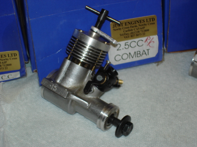

Ok guys the Sharma came today an 09. 15 combat (tuned) a 15 with a C/L carb and a 19 and Stewart they are very PAW ish in looks
the r/c carbs have a black plastic body ala some perrys and brass guts and barrel. The rods compared to PAW are much beefer sort of MVVS style. Have ordered PAW collector rings. They state in their info sheet the engines have been test run , ran at 12000 and ready to go no break in required just shove in the front of the plane and go, of course will play with them on the bench they also state 27 to 30% castor in the fuel their prop recs 1.5cc 7x4 8x4 2.5 and 3.2cc 8x6. 9x4,9x6 glass filled nylon
Looks like Just Engines now really into diesels really big selection and he promises more
Looks like I will be buying assorted fuel mixes from Davis by the case
I also cannot believe I bought 4 engines at one time If and when the enya 4 strk comes out my tail will really be in a sling
can"t help it-- Martin-- should be a fun Sunday on the back porch

Martin,
They look well enough finnished -least on the outside, so hopefully on the insides too. I like the prop bolt , maybe PAW could take note!
From the prop sizes looks like they need/ like to rev a bit, be interesting to see the No's from them .

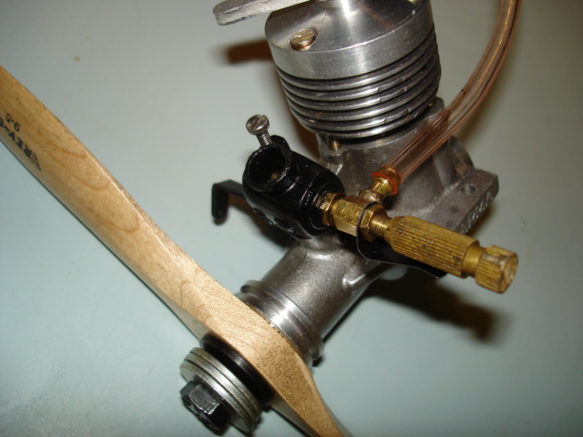

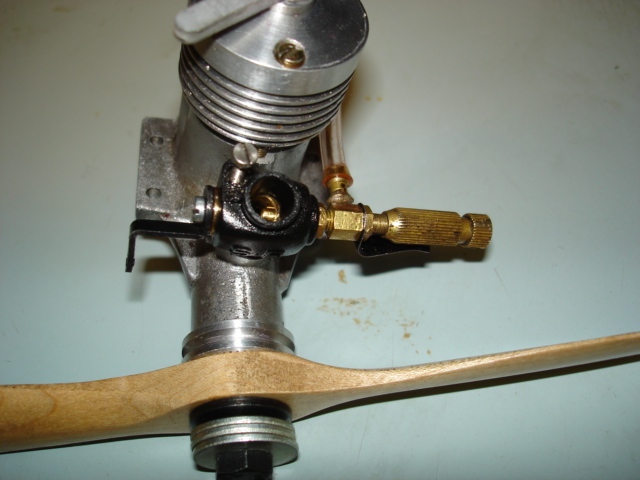

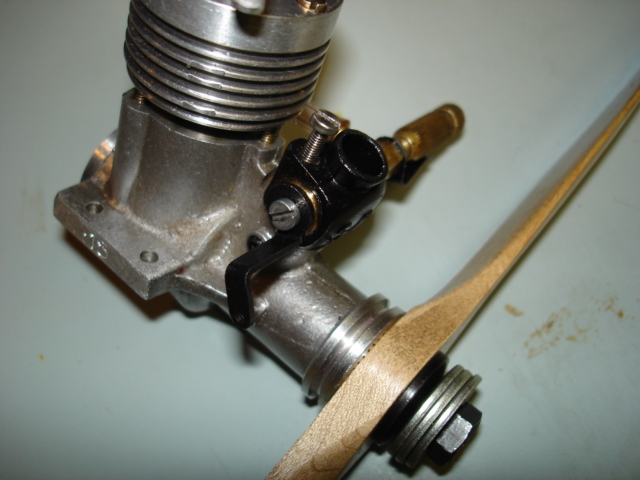

Her is carb shots now off to work back at 4pm to bench run martin

[X(] I can see the marks of jaws from chuck from lathe at the cooling fins at photos.. Not careful mounting of parts at tool machines and keep finish and clean surface at engineparts. But important the engine works well.

Motorboy did notice the jaw marks they could have remounted and polished them out but no big deal if runs ok, There is back and forth play on the shaft junst like the PAW I got rid of it by thainning a brass washer and getting it to a mirror finish must likley wo dor the same with these to get down to about ,010 play (inch) carb body needs a little polish up so barrel smoother in moving martin

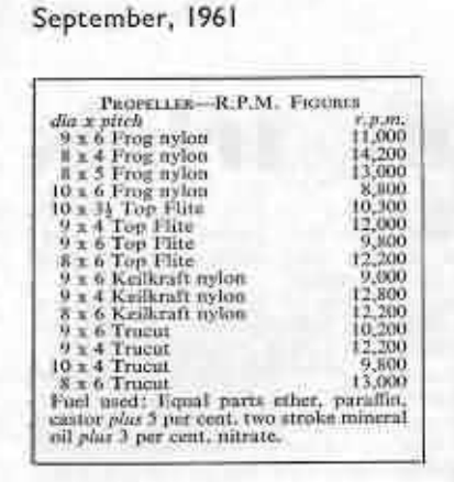

Martin ,
There pretty impressive No's , looks better than a PAW- see PAW 19 test results.

Stewart this in the COMBAT tuned 15 have not even run the 19 (normal) yet or the 09 or 15 really think the 09 is the engine for the bird dog its only 4.5 oz the OS 10 is 5,8 oz. I understand a few years ago these were a little on the crude side hersay?? or fact??
but these look pretty good still3 more to run martin

Martin,
I realise its the combat 15, I put up the PAW19 figures to show how good it is , it seems to be in the same legue as the MVVS15 which is a powerfull diesel for its size too. Looks like someone at Sharma knows what they are doing. Now youve had it running hows smooth is it? is the crank balanced ? I assume from the rod size comment youve had at least the backplate off.
Both my PAW 19 and 049 have NO crank balanceing= something I'me going to try and fix.( have grinders and not afraid to use them )
