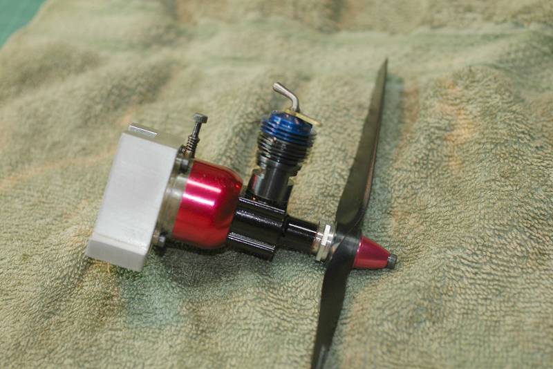

Today was a MOST interesting day. A number of things were learned and one is under suspicion.
First, castor WILL stay mixed with kerosene as long as the temperatures are high enough. It's 12.50 AM right now and the mix that came unglued earlier after getting the Chilly Willy treatment has remained IN solution despite having sat all day. As it warmed up to ambient, after about an hour, I gave the jar a shake and let it sit all this time, 6-8 hours. As can be seen, its clear and fully mixed. No separation line at all. Hope that comes out in the pics. There MAY be something unique with Klotz Benol, their racing castor formula which was formulated for racing bikes and snowmachines. The label says that it'll mix with methanol and gasoline. Does that explain it? The kerosene is hardware store variety meant for camp stoves and the like.
The other thing that was learned, is that the 50 weight aviation, non-detergent oil is equivalent to the castor as far as performance. That run can be seen here.
http://www.youtube.com/profile_videos?user=hopeso
Top end was strong, solid, smooth, no complaints. Idling and throttling became issues. But it wasn't bad, maybe just needs work. However, and that brings us to the third thing.
I flew the aviation oil mix in my .074 this evening. This time I had a lot of time and after MUCH poking and prodding with that stick I mentioned earlier, I got it. Well, briefly. Then I had to fuss with it some more and I got it back. Then it went away. What the *&%$#. What I found was that the screws holding the cylinder in had come loose. One was nearly out and one was just barely bottomed out. That's happened before, a result of repeated loosening and tightening of the head. Most of that was done last week when I went back and forth from glow to diesel testing some new props and glow fuel. SO, tighten it all up and things got a bit better. Only a bit. Did I have a loose cylinder when I ran the ether mix yesterday? Don't know, probably.
So now, with the engine all cinched up, I had a chance to REALLY work on all the elements. As before, with the other engines with no ether, we needed higher compression to start and ether prime was quite necessary. Once started though, the compression screw has to be backed off immediately. What's happening? Why? Well, we made note several times that it appeared that all the engines ran hotter with no ether. Therefore as the temperature comes up, that advances the timing and compression has to be reduced to compensate. Fair enough, what's wrong with that? First it reveals that ether, in significant quantity, contributes a great deal to cooling the engine. This is why, with ether, we don't need to back out the compression so much. Well, even, not at ALL with the .06 and the .074. Except for tonight. With the no ether, av-oil mix, the compression had to be backed WAY off on the .074. So what? Well so what is that this affects the idle.
Here's the deal. Reducing compression forces your mix to go lean and this creates the need to turn out, (richen) the high speed needle to compensate This takes the idle so far rich that even max out on the airbleed screw won't compensate. The proof of this is the sound at idle. Rough, burrp, burrp, pop. It doesn't quit and you do get good transition but you're hanging by your fingernails afraid that the engine will quit on you. Another proof is that as you put the nose up, the idle smooths out to a purr. This doesn't last long as the wing stalls and you fall out, but it's unmistakable.
What to do?? Modify the throttle to go leaner at idle? That can be tried. However, I'm going to approach the problem from the causal end and not the symptomatic end. The medical profession take note. Anyway, the cause? A no ether fuel and hot running. Solution? Provide better cooling. Pictured is a LiteMachines heli heat sink head, reduced and modified to fit the .074 in my small CAP. This engine is fully cowled and needed the heat sink.
Installed on to the Mini-Sport's .074, we're going to give it a go tomorrow.

Good day all,
Good idea actually calling Klotz, information right from the horses mouth and all that.
I checked my castor/kerosene mix this morning and the castor was indeed in solution with the kerosene. Seems the little "bubbles" I was seeing last were indeed little bubbles.
So, I repeated Andy's experiment of putting the mix in the freezer. It didn't take very long nor much of a temperature change before the Castor and kersoene began to separate. The castor oil wouldn not go back into solution until the mix had warmed up to room temperature.
I seems regular Sig Baker AA castor will so into solution with kerosene but only reliably at warmish summer time room temperatures.
I spent some time poking about the net on the subject of Castor oil. Interesting stuff; been around for more than 4000 years. I stumbled across many references to medicinal grade castor and degummed castor oil. Clarenece Lee and many others recommended using only degummed castor oil in our engines but there where some posts on threads on RCU stating that there was no such thing as degummed castor oil but the manufacturers clearly describe some of their grades of castor oil as degummed and Andy made reference to his chat with a gentleman at Klotz who also described their oil as highly degummed.
Perhaps in the early days of model engines and diesels in particular the grade of castor oil commonly used was not as degummed as our more modern oils and that was the reason for the start of the old wives tale that castor oil will not go into solution with kerosene.
In any respect it seems that castor oil and kerosene will mix - Myth Busted! but with certain caveats; keep it warm and it seems that Klotz Benol works a bit better in this than ordinary castor oil.
I couldn't just let Andy be the only one running some tests so I got off my duff and did some running today.
I have messed about with model engines since I was a wee lad. Unlike Andy I have never been so concerned about idling and good throttle response. While those topics are of interest, most of my engine use has and is in control line and climb and glide (1/2A Texaco and Texaco) type of models so throttle and idel have been of little consequence.
I have also gone 30 years without buying a starter but that has all changed. I believed the old Wives Tales about not using a starter with diesels but after ready Andy's and other posts on using starters with diesels I took the plunge and got one and boy an glad I did.
Don't use Starters with Diesels - Myth Busted!!! - again with certain caveats; be careful and think about what you are doing, these leasons from Andy and other users.
I put together a .049 diesel from Cox reedy parts using the RJL diesel head and Davis heavy duty crankshaft, and various other bits and pieces I had laying about. I put a phenolic washer tween the prop drive washer and crankcase so that I could use a starter on this engine.
After a bit of messing around and a couple of tear downs to replace the internal fuel line and fix a leaky tank I got the engine to the point where it would start and run well. Some of my initial problems were caused by it running very over compressed caused the RJL not having enough adjustment to reduce the compression; I added 3 head washers and now is much better.
Initial test's where done initially with my standard mix of fuel 35% ether, 40% kerosene, 25% castor oil, 5% marvel mystery oil, and 2% Amsoil Cetane boost. (I know it doesn't add up to 100% but replace the % with ml and makes it easy to mix)
Starting with the starter was dead easy. After I got the compression and needle valve set I didn't even need to prime. Just fill the tank and put the starter to the engine; a coupe of tries and it was drawing it's own prime/fuel and would start. A short warm up and it would be on peak. Consitent runs at about 11,000 rpm on a Master Airscrew 7x3 prop. Repeat a dozen times just to be sure this all wasn't a fluke.
To carry on the no ether fuel tests, I then tried running this engine on 25% castor oil and 75% kerosene and 2% Amsoil Cetane boost. And, I was able to get it running. It took a bit more trying to get it going using the technique I described above, was very touchy to compression and needle setting and ran noticeably hotter than before. On a hot day like today (hot and muggy) no or low ether fuel will certainly work but I don't think I would have had much luck getting this going on a cool crips Autumn day.
I will have to try low ether and more Cetane boost in various combinations. Awaiting more results of Andy's tests and I will certainly pass on more of my tests as they happen.
Andy, thanks for getting us off our duff's and challanging some of these old Myths and Wives Tales.
cheers, Graham in Embrun near Ottawa Canada

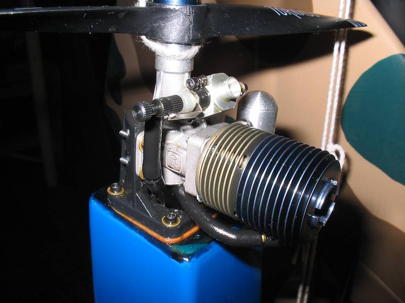

I am reading this thread with great interest.
The diesel idea is a great one and I experimented with a Davis ST 45 and a PAW .033 years ago. The exhaust note was great and running lamp oil made it very clean. The thing I didn't like was the magic ways of trying to keep the ether in the fuel and the potential cost to run a large 1.60 cu in engine. Otherwise diesel would be for me.
The idea of running a Diesel without ether makes it sound much more user friendly and less expensive.
It would be cool to try a Turbo plug equipped contra piston on a large diesel conversion to see if you could light it off with external heat and not have to chase settings. I don't know how you would energize the plug and move the contrapiston. Maybe the plug could be set toward the outer edge of the combustion chamber if the engine was big enough.
The other way would be to make the compression adjustment like on a Enya four stroke diesel (move the rear bearing to increase or decrease head clearance) and use a glow plug to get things going.
