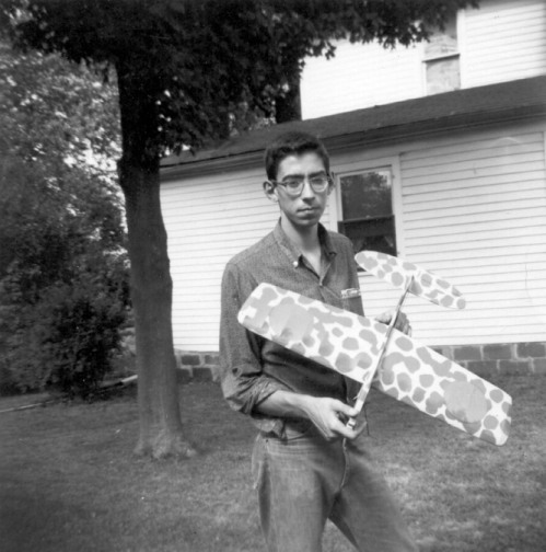

Joined: Jul 2003
Posts: 469
From: Downers Grove, IL
Stuntguy, congrats on your 2nd place. I built a number of Ringmasters in the 1950's but none as good looking as yours. I have tried to attach a picture of a Ringmaster Jr. in 1958 for a Fox .15 glow. Painted with a sort of Japanese WWII color scheme. I had the full size Ringmaster with Fox .35 Stunt and a Fox Combat Special on pressure. Also after the Jr. a light weight full size Ringmaster I built with wood lighter than in the kit and a thicker airfoil for a Super Tigre G.30 2.5 cc diesel. Just clear dope and silkspan on the diesel version to keep the weight down. Flew great well into the 1960's. Jack
