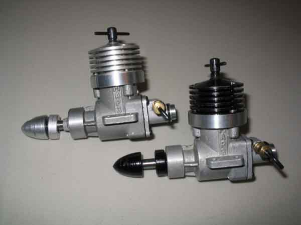

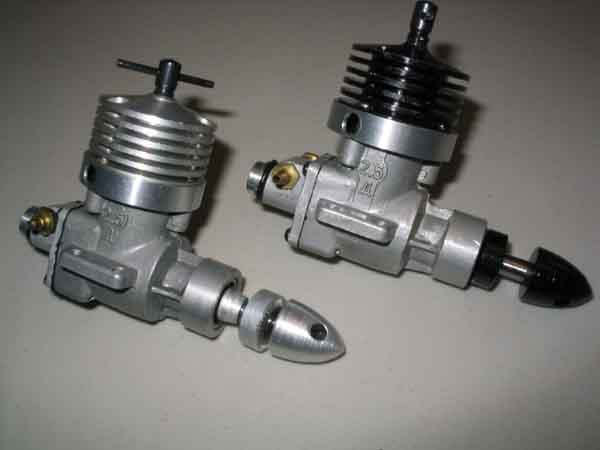

I broke in My MARZ 2.5 using Davis or Aerodyne, can't remember which. It had almost zero compression when I started, but developed some as it ran and formed an oil seal on the piston. Here's a couple of pics:
George
