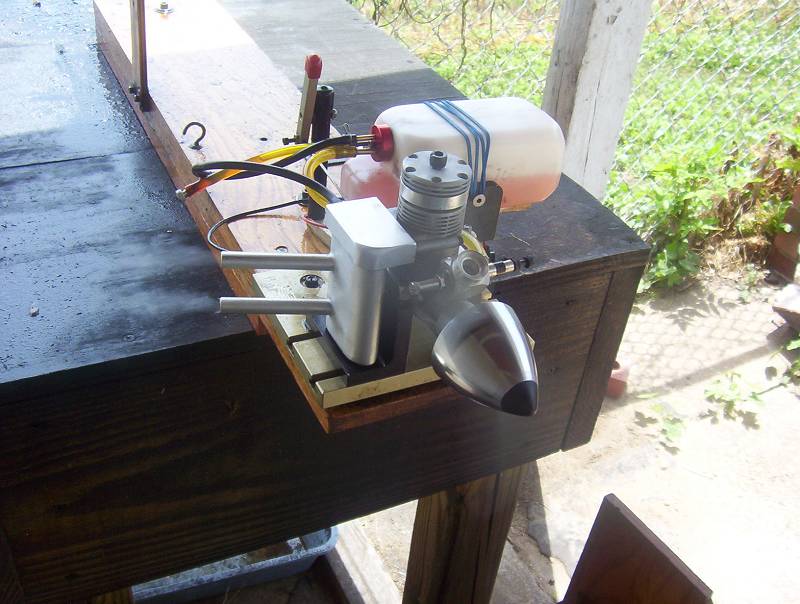

Just for kicks I ran all my .50 sized Diesels today, I may have a SuperTigre .45 conversion somewhere too.
MVVS .49 with Graupner 12x7 DDD ABC mix===9,775 rpm
Fox .50 Graupner 12x7 DDD ABC mix===9,150
Irvine .53 Graupner 12x7 DDD Abc mix===10,121
Webra .50/Bisson Pitts=Gr.12x7 DDD ABC=====9.950
SuperTigre .45 ABC Gr.-12x7 DDD ABC mix===9,800
SuperTigre .51 Graupner 12x7 DDD ABC mix===9,650
OS LA .46 Graupner 12x7 DDD Plane Fuel==9,450
OS LA .65 Bolly 13.5x8 DDD Plane Fuel===9,300
PAW .60 same Bolly 13.5x8 DDD Plane fuel===7,300
Francis, the fuel can adapter you made for me came in mighty handy today, Thanks

I found the SuperTigre .45 ABC with DDD head. I bought it about 3 years ago, today it provided an interesting story. When I first tried to start it it would not draw fuel. I opened the HS needle to about 4 turns, still no go. I opened the throttle about half way, it would fire a couple of times but still no go. I bottomed out the compression screw, it fired some more but would not start. Finally I opened the throttle to full and it started but could only manage about 4,500 rpm. As soon as I would try to reduce the compression or lean it even a little it would quit. I began to think I had bought a worn out engine but it didn't feel like it when flipping. Upon inspection the reason was obvious, it had been assembled with the sleeve rotated 45 degrees toward the front. The notch in the cylinder phlange was lined up with the exhaust side front head bolt. After proper assembly it started instantly.
Using the same 12x7 Graupner, DDD ABC mix and Hobby-Lobby spinner as the others it turned 9,800 rpm. It surprised me by being stronger than the ST .51, although the .51 has a lot of time on it, about 16 years worth.

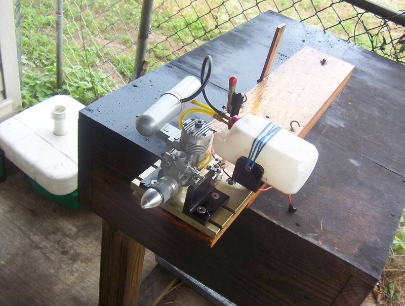

I ran my PAW .60 today and put 16 OZ more fuel through the Fox .50.
PAW .60, Bolly 13.5x8 Davis Plane Fuel, rpm===7,500 plus a few.
Fox .50, Graupner 12x7 Davis ABC Mix, rpm===9,500, it improves every time I run it.

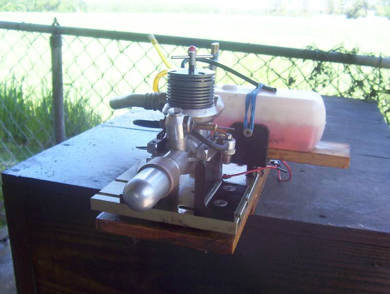

Here are two more .50 sized engines, I received the heads for my Webra .50 and Fox .46 ABC yesterday as posted in another post. The Webra turns the Graupner 12x7 at 9,950, it turned it at 9,570 with its stock muffler and 9,950 when I put the Bisson Pitts muffler you see on it.
The Fox .46 turns the 12x7 at 8.590.
Webra .50/stock muffler====9,570
Webra .50/Bisson Pitts=====9,950.

Hobbs numbers of course excellent the surprise is that "clean look: with the new head on the Webra the look beats anything (my opinon diesel or glow) very contempary martin
