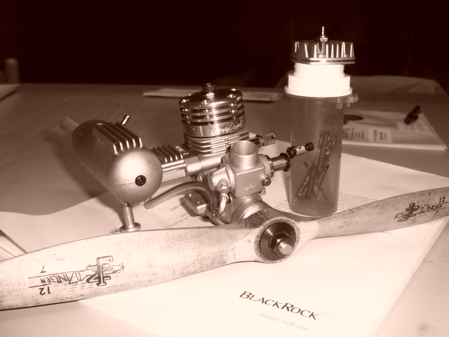

Finally it got here 32 SX head from davis new angular fins smooth top it make the glow head look puny, binding screw against compression screw now straight thru no longer at an angle on top, nice touch hope for a run tomorrow quite an update after 30 years or so martin
thats the glow head on the pill vial
Hit the wrong button on the camera sepia a little different
The beaver will fly with the installed Enya 25 first then will be switched to the OS and see what 3 blade we can swing hope to try a couple tomorrow on the bench. the AT6 will get the ST34 conversion

what makes the 32sx awesome is the carb. as a glow engine, it wll turn an 11x4 prop at like 11.5K. its a really strong engine.
however, the carb will likely not help you much as a diesel, as i'm sure you are aware of. i'm curious just how much the barrel ends up traveling between idle and full throttle Martin. I'm thinking since the barrel is so big that it may not travel much.
it looks awesome though. what prop are expecting it to swing? i'd say 12x6-2 blade = 10k 10x5 - 3 blade - 9K

ON the carb my guess around 70% opeh will be full throttle plan and running later today will let you guys know

Ok folks on the 32FX found a 6.5mm front carb perfect fit for the 32 ( from Just engines fits OS) Getting rid of the rear setup drill and tap for 8/32 short cap screw both sides done hope to run later and let you know the numbers martin

Tommy boy just ran the OS32SX I used a front carb from Just engines 6.5mm opening, ditched the rear carb setup davis abc fuel XOAR 12x4 wood 9800, still messing with idle around 3300 , needs more time on the engine we only have about 40 minutes on it , transitions nice
