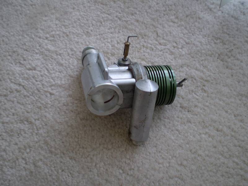

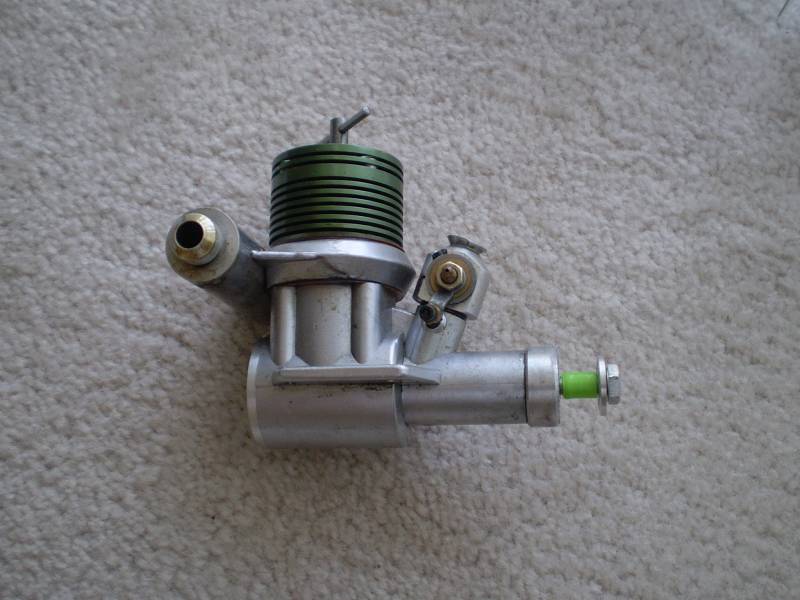

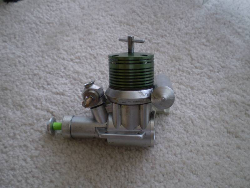

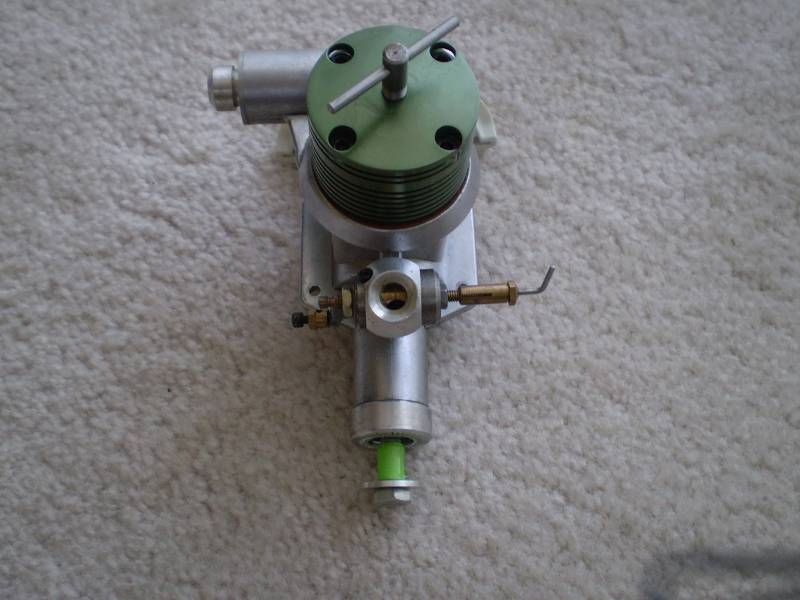

Hi
Just wondering if someone can identify this engine, recommend a prop and the range of rpms to expect from it.
Asim

From the looks, it is definately a PAW, as these engines all have a smooth looking casting.
Without much for size comparison, I'd say it's the 49 or 60TBR
For prop sizes:
http://www.eifflaender.com/techdets.htm

Is there a way to tell them apart? Their weight also seems to be close together (based on the link above). This engine weighs at 511 grams. Did they make 49 in green head too or was made only for 60?

The displacement should be stamped on the rear cover plate martin

Would have been nice , but no luck. There is nothing written anywhere on this engine including the cover plate.

The PAW engine has Varijet carburator and the coolingfins are green, it is a 60 size engine also a PAW 60 TBR-R/C while the engine with darkbrown cooling fins are a 40 TBR-R/C size engine. Both 40, 49 and 60 has Varijet carburator.
All anodising in coolingfins has been withdrawn as of 1st June 2007..[]
You need 16/8, 15/6, 12/6 propeller for your PAW 60 TBR-R/C , read instruction for Varijet carburator: http://www.rcuniverse.com/forum/fb.asp?m=5991650
