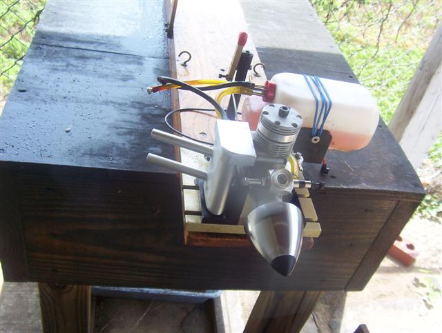

Fiery, if there were a carb equal to the Irvine Jetstream it would be the MVVS carbs. I have about 4 of the 7mm carbs for Diesel use. In a bit of irony, here is a Fox .50 wearing an Irvine Jetstream and a Webra .50 wearing the MVVS 7mm carb, go figure.

HOBBSY You did it again one up on me, Webra 50 nice whats does she turn and on what prop?? martin

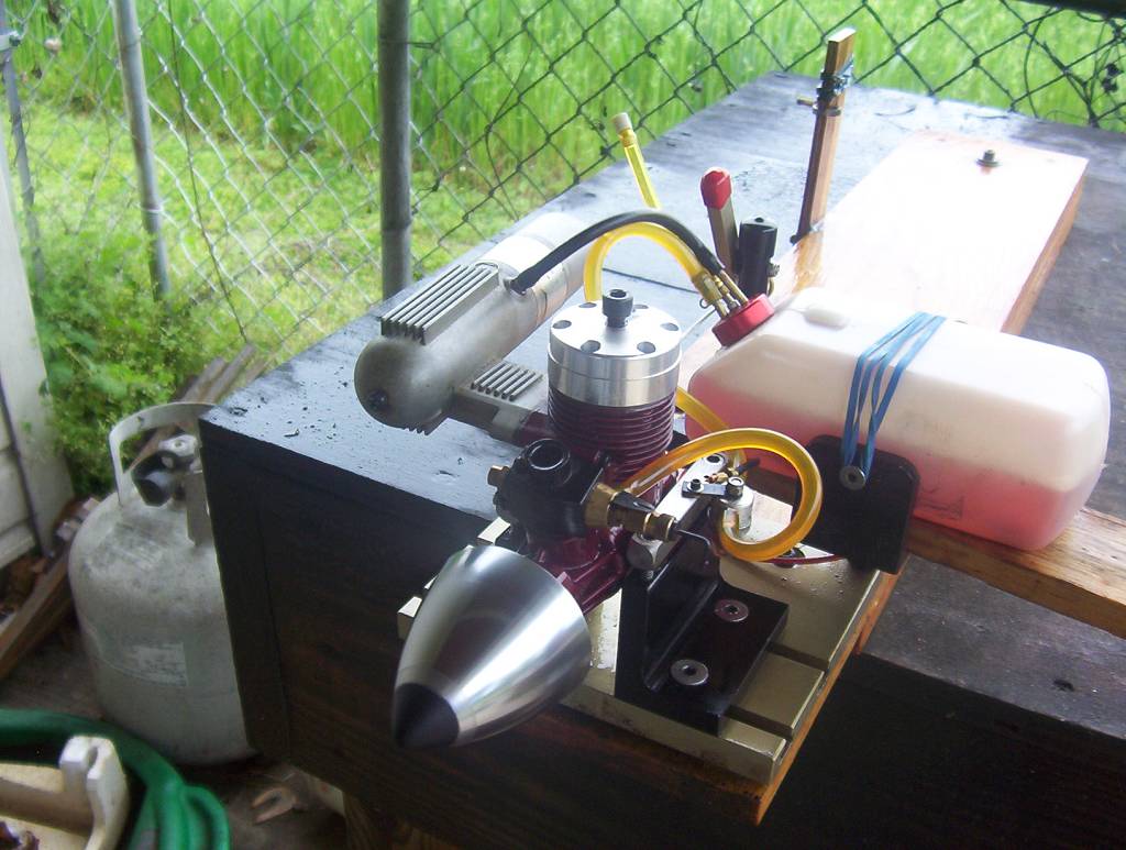

Here are two more .50 sized engines, I received the heads for my Webra .50 and Fox .46 ABC yesterday as posted in another post. The Webra turns the Graupner 12x7 at 9,950, it turned it at 9,570 with its stock muffler and 9,950 when I put the Bisson Pitts muffler you see on it.
The Fox .46 turns the Graupner 12x7 at 8.590.
Webra .50/stock muffler====9,570
Webra .50/Bisson Pitts=====9,950.

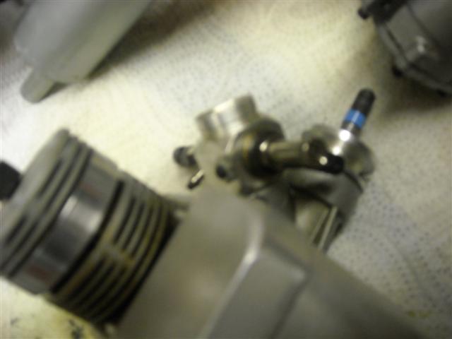

Yep, it is the king of the .50 Diesels turning the Graupner 12x7 at 10,200, I suspect the .53 is a 12x8 engine.
Martin, note the barrel retaining screw on the MVVS carb and how close the carb is on the Fox .50, I tried to put one of the MVVS carbs on the Fox but no go.
