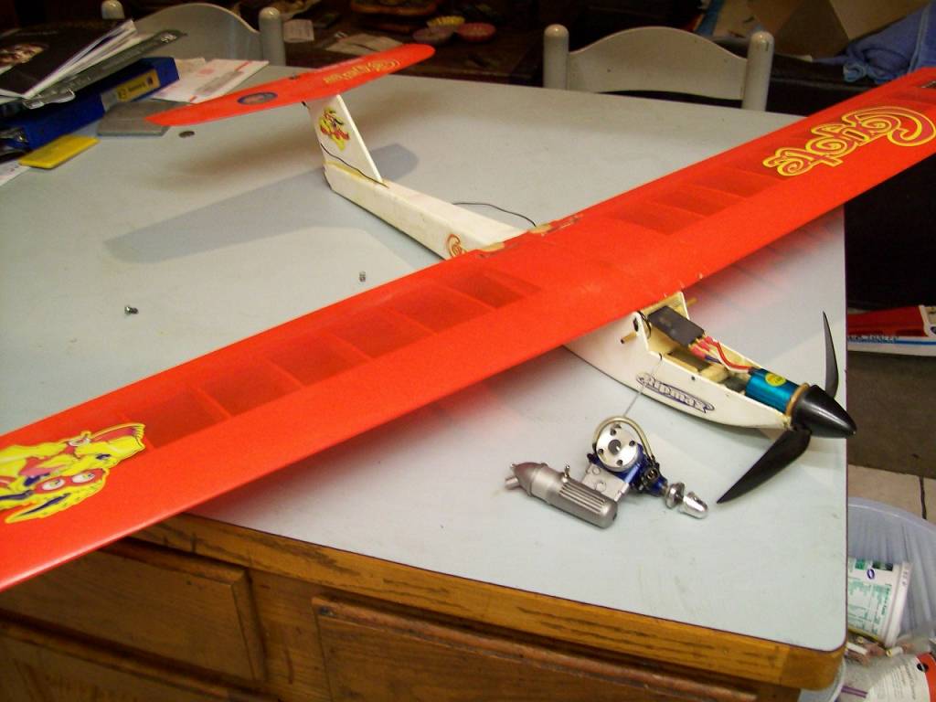

Just dug out my ripmax coyote a t tail aileron and elevator , pretty swift preformer, plastic canopy was broken in a "hard landing" this would not be a lot of work, to install, the OS10LA
davis head, add a bent wire main gear, it carried a 1500 3 cell lith battery, dumping the brushless motor, speed controller, and battery and replacing it with the OS10, 2oz tank and one more micro servo for throttle should be about the same wt, even if an oz or so more I do not see an issue and plenty for space to do this, being a slab side balsa fus a new firewall and mount a snap. The vertical stab was broken off too, so the excess epoxy needs a touch of the dremel and will repaint the fus, the bottom is scored up from lots of landings so a refinish in order maybe we can turn the coyote into a wolf
