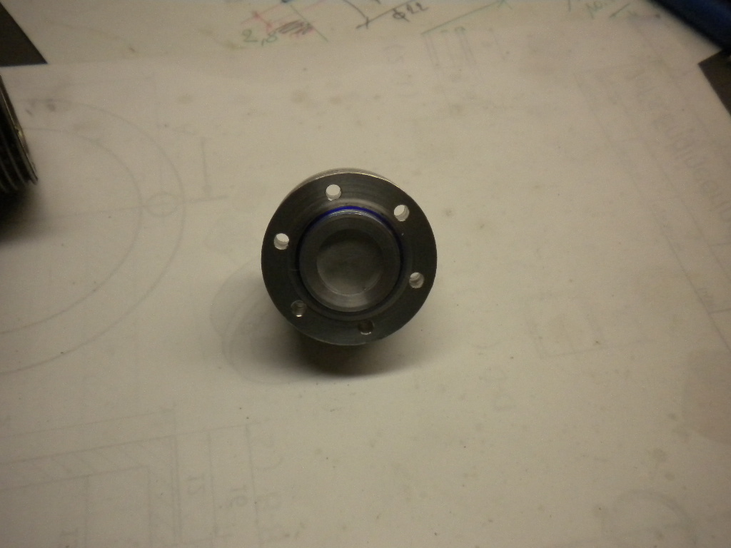

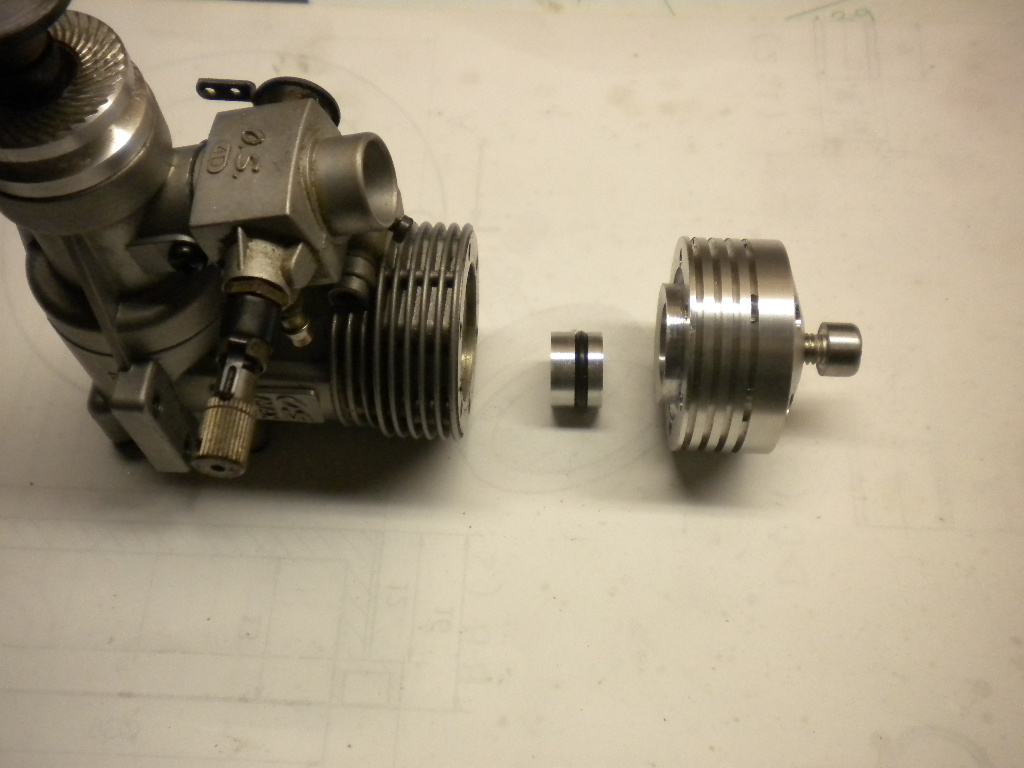

jef-lemmens 09-21-2014 12:40 AM
OS46SF Diesel
2 Attachment(s)
My homebuild glow to diesel conversion
http://www.rcuniverse.com/forum/atta...mentid=2033828http://www.rcuniverse.com/forum/atta...mentid=2033829
https://www.youtube.com/watch?v=_g2SWA-D1Qw Greetings Jef

Good job with the head and contra piston for the OS 46SF
erik58 09-21-2014 12:03 PM
I have one too. mine has a DDD head and a just engines piston & liner set it runs great .

fiery 09-21-2014 08:39 PM
Where is your contra-piston sitting when adjusted for best RPM?
Up in the head? Or with some of the lower portion protruding into the chamber?
jef-lemmens 09-22-2014 09:58 AM

I have not be able to measure RPM , tachometer is broken , on the movieclip I have used a graupner 12 "x 6" , then I tried a 13 "x 6" APC and I think that was OK too , fuel = 25%casteroil / 30% ether / 42% petroleum and 3% ignition improver from Barhdall
The bottom of the contra piston sits a little bit in up the head , about 0,5 mm

fiery 09-22-2014 07:34 PM
One extra head gasket should get the contra-piston setting near perfect Jef. Well done.

jef-lemmens 09-26-2014 10:06 PM
That's a good advice , thanks Fiery
