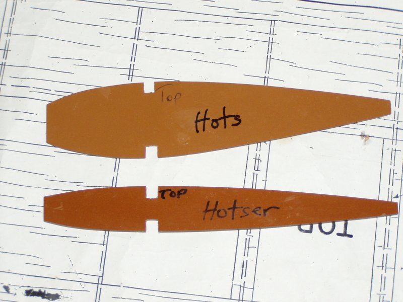

The Hots, the original purpose built Fun Fly plane, has a thick airfoil, nearly 20%. The first thing I did was thin this down. I shrunk the original rib template down to something that looked good and it turned out at 11.5%. The difference between the two templates is impressive. Instead of a flat firewall for the front end, I planning on a spinner and cowl. I was originally thinking no landing gear but finally decided to go with racing wheels and gear.

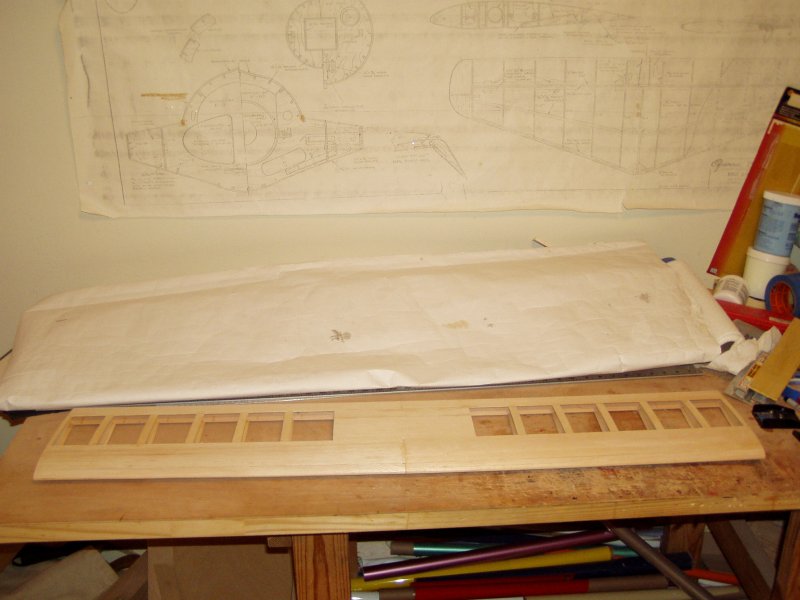

So far, ribs have been cut, the fuselage is framed and this evening I started construction on the wing. (Don't hold your breath though, I've been pretty slow on building lately).

Ribs and sheeting are 1/16" contest balsa. TE is 1/4" square balsa and leading edge is carved from 1/2" x 1" contest balsa. The spars are full length 1/4" spruce, one piece wing tip to wing tip. Center bay has two 1/32" ply shear webs. The next two bays on each side have one 1/32" ply shear web and 1/16" balsa webs out from there. Finished it measures exactly 11.5% thickness.
Wing tips go on tonight.

Airframe changes for wing thickness, wing changes for fixed TE and other changes for cleanup have been very interesting. This plane is going to be one fast Hots! I flew the standard #6 Hots Sunday and got the blood pumping again.

The outwardly noticable changes from the original Hots are the drastically thinned airfoil (well, maybe not noticable in the picture), the shortened ailerons (dang, also not visible in the grainy cell phone photo!), the carbon LG, the racing wheels and of course the Jett power package. There other, non-visible, internal changes.
