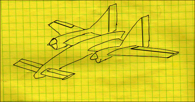

As others have noted, with the addition of canards you will have to adjust your cg forward in order for the canard to operate properly; as well as adding a bit of length to the fuselage.
Now if your looking at building this a a speed plane as well that is going to take even more work. First of all you will want to get the airplane a heck of a lot lighter than even the six pound weight they suggest as the lower limit to get it to move at all. All in all your probably better just sketching up your own design base on an enforcer and going with that given the modifications your thinking of making, plus a few others like a thinner wing as well.
Now with all of that having been said,I kinda like the idea of the twin tractor powered canard, here is a sketch that some one drew from my description awhile back.

Love the rendering of the Twin Canard that you have there.. It kinda reminds me of the Beechcraft Starship.. it's a Twin engine Canard in a Pusher configuration!! Cool looking Aircraft.. I for one would have loved to own one!!
Craig.
Craig.

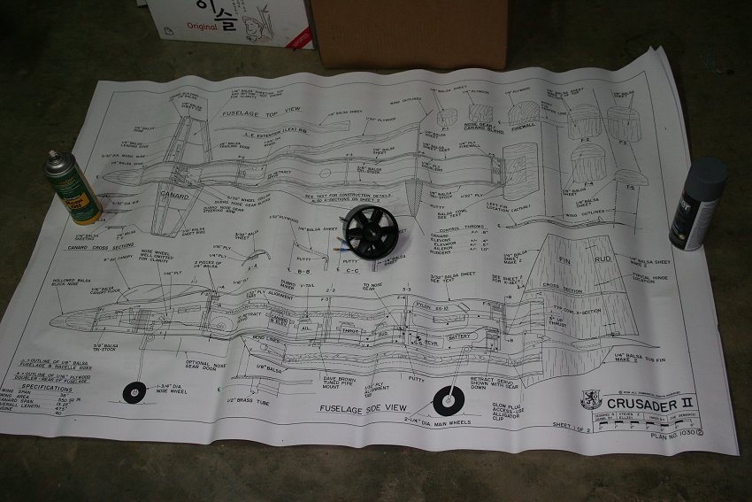

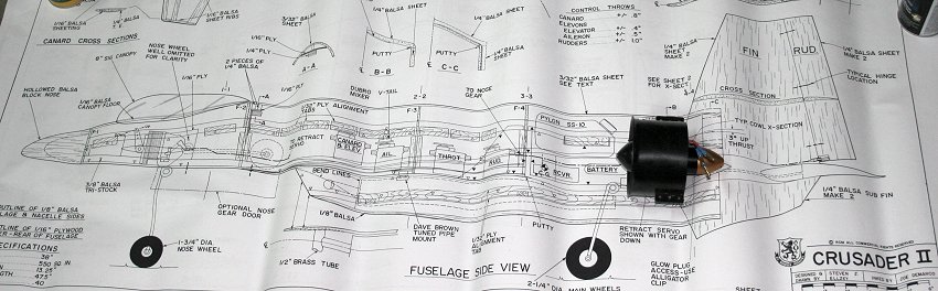

I though the same as you. However instead of modding the Enforcer like crazy there is a better airframe to start with that is just about perfect for you. It's called the Crusader II
http://www.rcmplans.com/index.php?ma...oducts_id=1845
You can get plans for it from RCM. It's a rear prop plane but it should take a fan eazy enough.
Here is the fan I'm going to use in mine.

Great plane to start, with your a lot closer to start with without having to re-invent the wheel, then trick it out...
If your using an electric fan you can really shed some excess baggage.
Even a propped version would be a lot closer to start with rather than adding canards to a Enforcer and then trying to figure out where the COG needs to be.
Stretching out an enforcer and adding canards is really going to change the cog requirements, your mean aerodynamic center is going to be a lot different.
