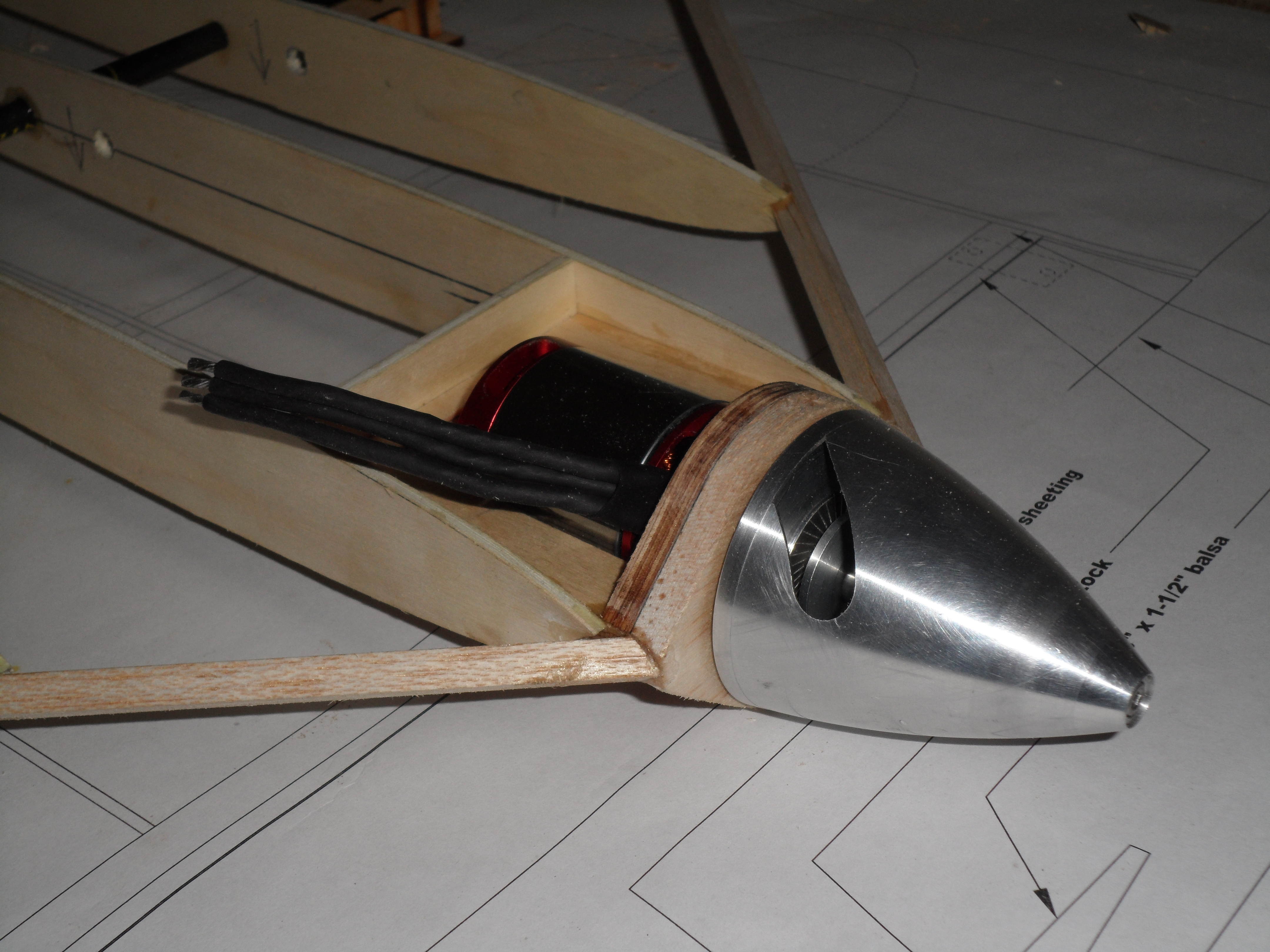

I've got a 1600kV outrunner for a 500 size T-rex heli in a MPX Dogfighter. I run it on 5 cells and an APC 7x10 prop. It draws well over 100 amps.
Don't know what motor you have there, but you'd need a really tiny prop to run a 1600kV motor on 6S.
If I were to put the motor I have in a delta this size, I'd be looking at an 8" prop and 4S. Probably an 8x7 or 8x8.
Old 05-27-2015 | 01:56 PM
  #486
rcguy59's Avatar
My Feedback: (8)
Joined: Jul 2008
Posts: 1,490
From: tacoma, WA
Thanks Rudeboy. That's exactly the kind of advice I need. I was thinking 6.5-7" dia. and about 5-6" pitch on 6S. I was going to try 4S first, so thanks for reinforcing that idea. I happen to have plenty of 8-7's and 8-8's for my .32's. My motor is a Chinese cheapy, so I doubt it will survive 100+ amps for long. I was planning to try to hold it under 90 amps peak, as it's rated at 75. They're only about $20.00 ea., so a smoked motor here and there isn't a disaster. I've got a 150 amp ESC I was planning to use. What brand of motor are you using?
Old 05-27-2015 | 08:49 PM
  #487
iron eagel's Avatar
Joined: Jul 2004
Posts: 3,275
From: Middleboro, MA
Four cell and the 8/7 should be a good match, the 6.5X7 on a six cell should haul. What type of constant wattage is it rated at? You should be able to push 150% of the rated wattage for a couple of minutes anyhow with good cooling. I have done it with the cheap Out runner motors and they have held up without cooking a bearing or magnet, but they probably only have 3 or four hours each of total flight time. Stick with a real fast ESC when using a 6 pole motor (a good ESC with program limits will be able to survive frying the motor).

This is the one I'm using, also a chinese cheapo.
http://www.hobbyking.com/hobbyking/s...ter_Motor.html
It handles the amps just fine. Just don't keep the throttle pegged, and don't use a spinner. Or use a small spinner, but make sure that the motor windings get hit with the full speed airflow. Proper cooling keeps these things alive at 150%+ of rated power.
The same goes for the ESC. I shorten the motor and ESC wires, and solder the together, no connectors. Shortening the motor wires is a pain though, because you have to remove the lacquer from the strands

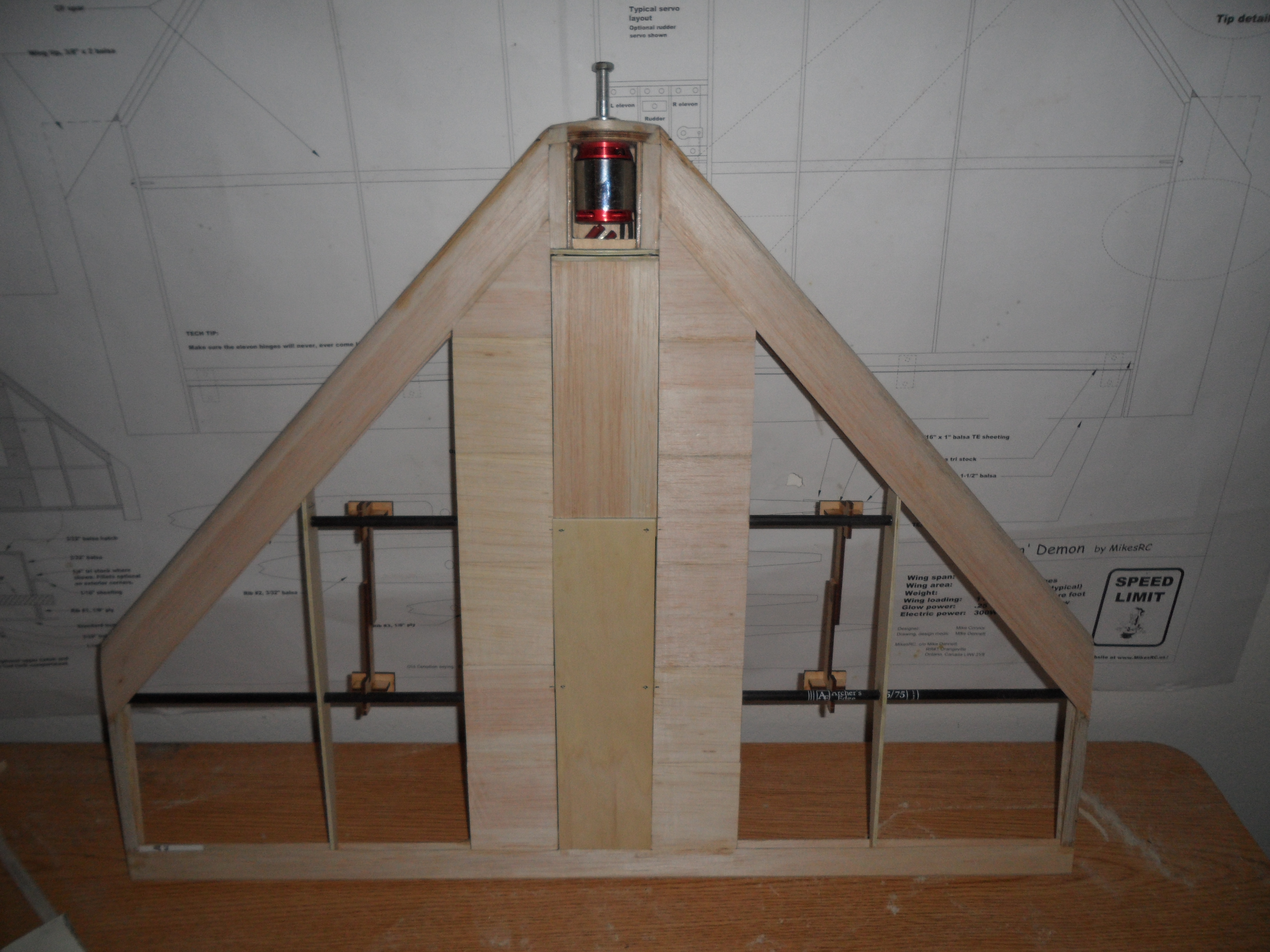

Been working on it again tonight. Once I test-fitted the motor, I decided to do some watt-meter pulls with some different props. Started with 4S and an APC 8-6E. 104 amps. A bit much. I must have sorted through 50 or 60 props and couldn't find anything I wanted. So I cut an APC 8-7 sport prop down to 7" diameter. I got 79.4 amps out of that one, 1131 watts. That will be my starting point until I can find some more suitable props. The LHS didn't have any, either. Figures. I ditched the spinner, as it was preventing good cooling airflow. I'll finish the airplane before I do any more test runs. Here's the progress.
