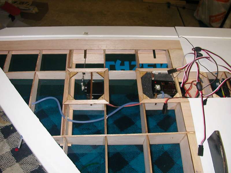

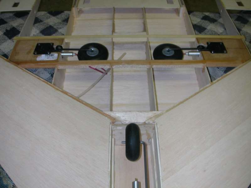

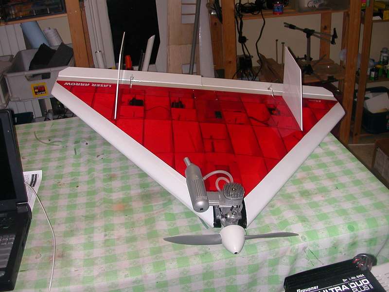

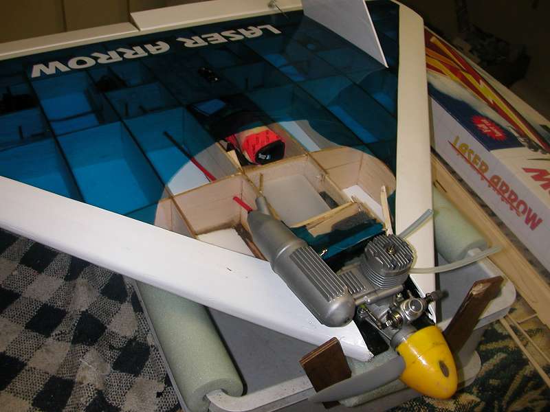

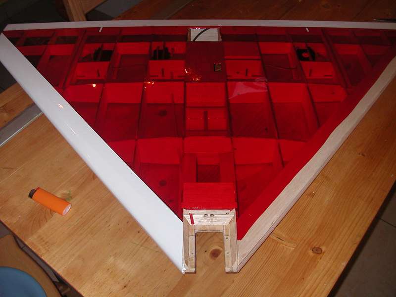

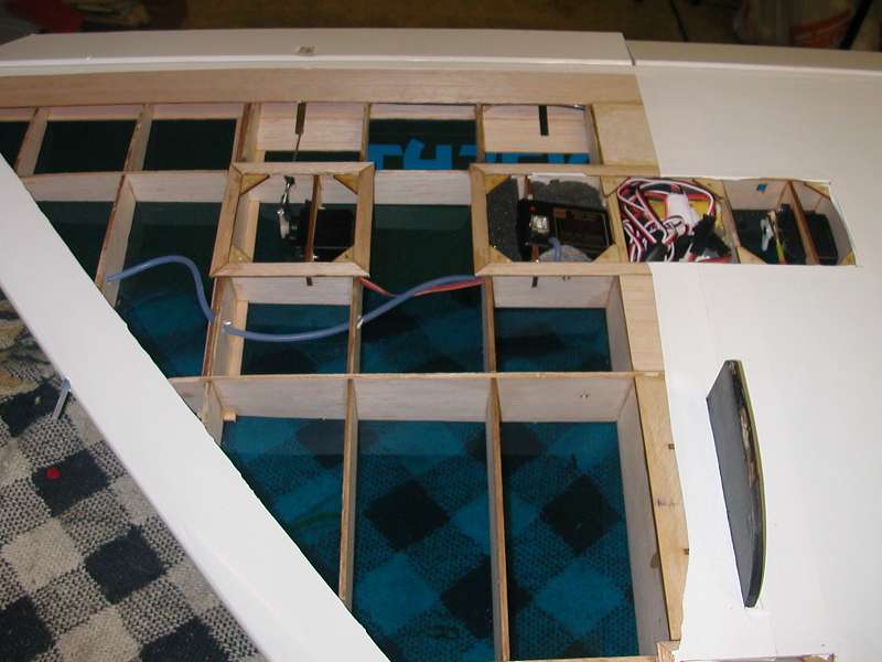

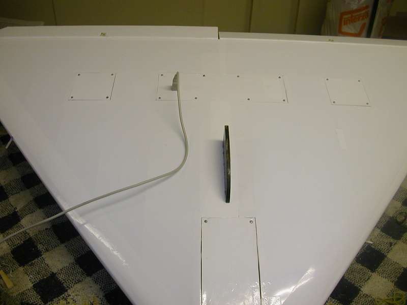

Hi,
This winter I will make some brainstorming around the accoustic speed mesurement method. I plan to develop some friendly soft working live.
In order to find some parameters I need a backup speed info.
That's why I invested in a eagletree stuff.
I instaled it in a laser arrow and I will take this oportunity to tell you the real speed of that plane.
Actualy it's fit with a magnum 45 standard exhaust turning APC 9*7
after speed mesurement have been made with that engine i'll switch to a 61 FX.
feel free to ask me to install any prop on those combo just to see........ (don't ask me to buy similar engine than your )
actualy I estimate the top speed around 100 MPH with the magnum 45 (maybe a bit less), we will see as soon the weather is ok if my estimation is correct.
I also bet that the top speed won't increase a lot with a .61 FX

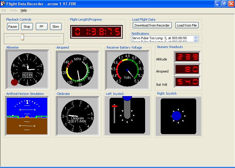

By the way here is the first trial of the eagletree system
It was freezing this morning and I forgot my gloves home, so I made a short flight.
the sky was overcasted at 1000 Ft. I made that flight using 10 procent nytro APC 9*7 I am unable to give you my RPM because there was not enough light for my photocel rpm measuring tool and I don't have the eagletree racer expander (I will order that stuff now !!)
I tuned the engine with my ears and eyes (smoke and noise)
I made a very short flight and as you can see I reached the top speed of 93 MPH exiting a moderate dive
that's exactly the speed I was expecting !!!
I also pulled up a vertical who bringed me to a maximum recorded altitude of 894 ft, at this time the plane was disapearing in the clouds.
the unit recorded one glitch one elevons when I switched the system on and numerous glitches on my throttle servo. I have a old servo on my throttle.
more infos when the weather will be better
here is a screenshot of the display as it appear at the end of the playback. you can see the max altitude and airspeed display and the total amount of glitches.
I choose to not display the stick position because the soft doesn't support elevon mixing yet and the display is completly wrong, the artificial horizon also. (I exchanged some emails with eagletree support during setup and they said they are working to a software update )

here is a view of the display during the flight playback with stick display on
at this moment the plane was stabilised in level flight at full power showing a airspeed of 80 MPH
that's amazing, when I see the airspeed indicator during playback I can say that the cruising speed of a laser arrow with a .45 is the same than the cruising speed of a full scale 65HP piper cub

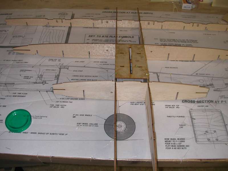

Ok nice begining for 2004
I went to the field this afternoon with the arrow and a 10*6 bolted on it for some records as per miskin request.
the sky was clear but the temp was very cold. I started the engine and launched the bird. I let it accelerate a bit and pulled up gently. The bird went 90 degrees verticaly into the ground. You should have seen my face at this moment.[X(]
I stuplidly looked to my transmiter and readed the fatal sentence " MODEL : DIAMOND DUST "
It hapen........ This must hapen one day in a modeler life, it hapened to me today.......
I ATE MODERN TRANSMITERS !!!!!!!!
Ok I examinated the debris and altough the bird look relatively in one piece, absolutly all the ribs cracked because of the impact. I could fix it but it will take more time than to frame up a new one (if I want to fix it correctly). The arrow kit is a very fast build and a cheap plane, that's why I went to the LHS on the way back from the field and bought a kit.
I started on it already.
Will fly monday, you bet ?
I will download the (short) flight file and post a screen shot showing the moment of the impact
In the car I was thinking "I could build the new one exactly the same color scheme than the old one, and nobody on rcuniverse will see a diference. I won't look totaly idiotic to other members ".
But I decided to be honest and to post
here is a pic of the plane and a pic of the new one I started 30 minuts ago

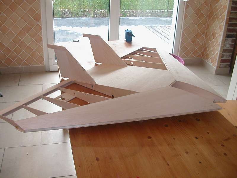

I said fly on monday, but it won't be the case. Altough I can fix my crashed arrow, I decided to build the new one with a os 60fx in the nose. So I will have the two versions.
here is a pic of the new one I framed up those last two days. Took a bit more time than expected because I made some mods
1) reinforce the front fuselage and tank aera with extra sheeting and a ply firewall instead of the balsa one.
2) tri stocks everiwhere on the engine mount
3) antena tube (like on the first one)
4) extra acces hatch in the aft top of the center of the wing for more backward battery instalation (to balance with the .60 in the nose)
5) cleaner instalation of the data recorder
color scheme will be exactly like the .40 one except the clear top covering will be red instead of blue.

the .60 arrow fit with the eagletree stuff is waiting for nice weather
this thing required a TON of lead to balance and turned out very heavy []
4.6 Lbs............
I am curious to see how will the launch turn

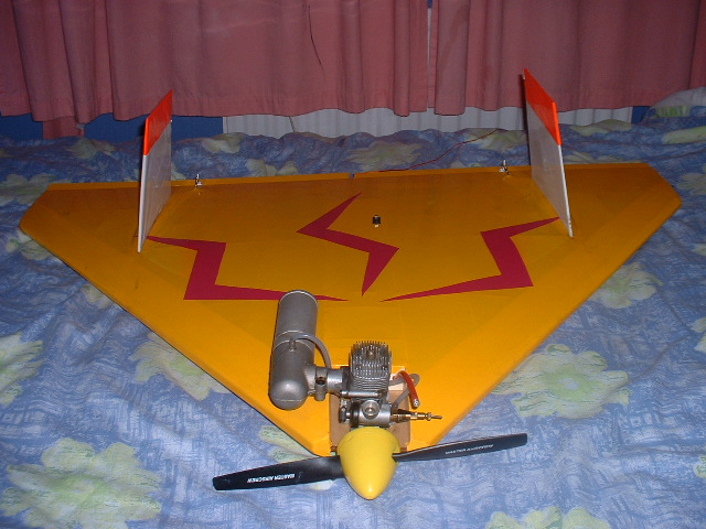

that one nice plane you have there [8D]
i wish mine looked like that
how much weight did you have to add to balance it ??
my friend has a rapier ARTF with a MDS 48 he had to add 1LB of lead at the back to balance it []
its a bit of a pig to hand launch[:@]
i dont know the exact weight of my arrow weigh but im sure its under 4LB

sure your is under 4. My .45 version balanced fine without lead (I'll start to fix it soon I promised my friend)
I didn't weighted the lead I instaled, I only weighted the entire bird
hey ! your arrow look nice !

there will be some delay to fix my .45 arrow, I decided I wanted absolutly to finish this one before

what is, or was, it?
Old 01-10-2004, 12:25 PM
miskin
Join Date: Dec 2002
Location: kent, UNITED KINGDOM
Posts: 275
Default RE: laser arrow and eagletree data recorder
i was giong to ask the same thing
what ever it is a was it looks like its going to be hell of a bird
i look forward to the flight report
