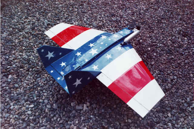

Here is my "Shrike" which has been seen around here. I run a simple TT46 pro with a Ultrathrust muffler. It turns 17000 rpm and speed is about 120. Not bad for a simple TT. Now I have not clocked it. I can take my friends F-20 with Jett 50 and it has been clocked. Now that F-20 weighs a couple more pounds. Where i am going with this is You put a Jett on this Shrike and it will really move.
