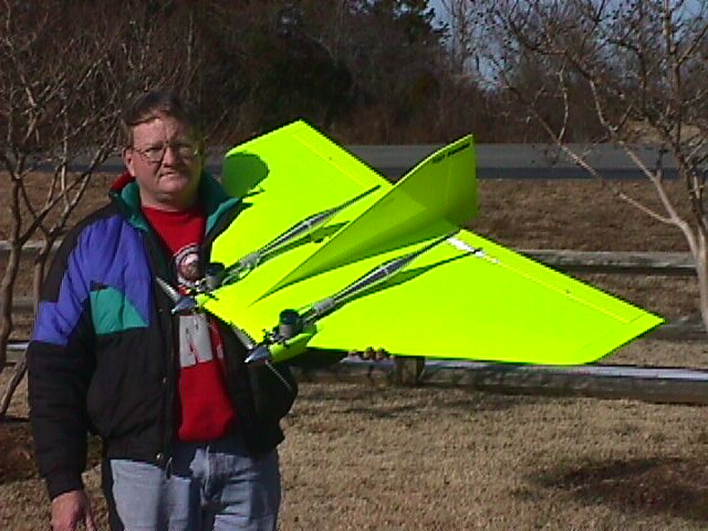

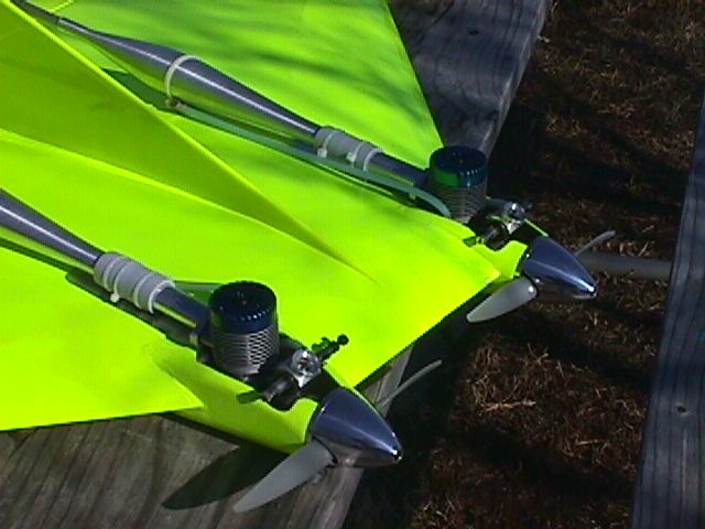

Made you look with that subject line... I finally got a perfect flight out of my Twin Outlaw. Great separation from the dolly and some great high speed passes. It's easily running 40mph faster than my Diamond Dust or Magnum and they run an honest 145+ so I figure it's getting close to the magic 200!!!! All that, no damage and it's ready to fly again....

WOW!
thats awesome man! You gotta post a video on that thing. Or at least record the sound it makes with both engines on pipes! I bet its unreal!
Those look like MVVS .40 somethings .49 maybe?

They would kick me out of RCU if I used the adjectives that describe the sound this thing makes, totally unreal. Two MVVS .40 Q500 motors, modified by MVVS, would be illegal for Q500 as they are, oversized carbs, porting, the pipes, etc...

evan....you are da' Man !!!

That is too cool! I assume ear plugs are mandatory.

Talk to Robert at MVVS, they can do any modifying. Doing engine run ups when I built this thing it took three people to hold it down and yes all our ears were ringing. I had a big reverberation problem when I first started it causing so really harsh vibrations, the engines were ringing off each other. One of the guys here had the solution. I had the props set up so that coming upon the compression the props were level. The trick was to off set one 45° to the right and one 45° to the left.

That's not MVVS... it's Morris Hobbies. Did't know they did that kind of service to engines. Nice to hear they did a good job with them.
What props are you running and at what RPM?
Twin speeders are cool. The sound is an experience on its own. Just watch it when one of them engines flames out. Ah well, at least you've got carbs to throttle down the other one...
Good job!

Running plain APC 8X8's, not sure of the RPM's and honestly don't care. Flame out is a non issue with the engines that close and the size of the verticle stab and rudder.

KOOL!
great job on the cowls
try 9x8 APC or the Pylon 8.75x9.25

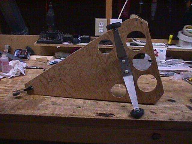

HOLA:CAN YOU HELP ME WITH A PICTURE OF YOUR DOLLY?[:-]

Dolly pictures.... The holes are to balance it so if it sticks to the airplane during the flight (it did the first flight) and to let air flow through to aid separation. Notice the steerable tail wheel that the rudder lays in, works great...
