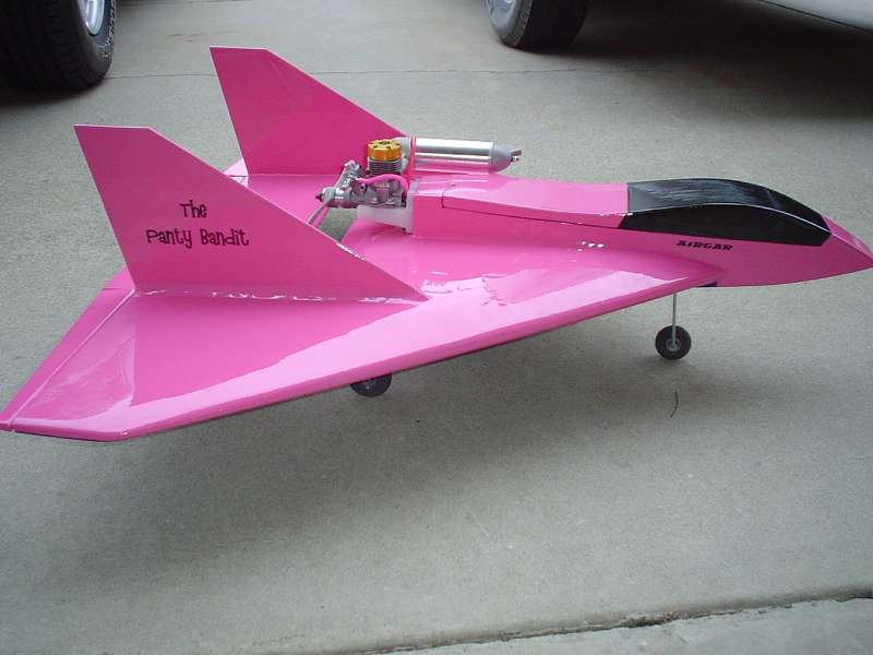

Airgar has one with a GMS-47 that flies well- Not sure about the wing dropping... Have you laterally balanced it? And are the elevons traveling the same amount on both sides...

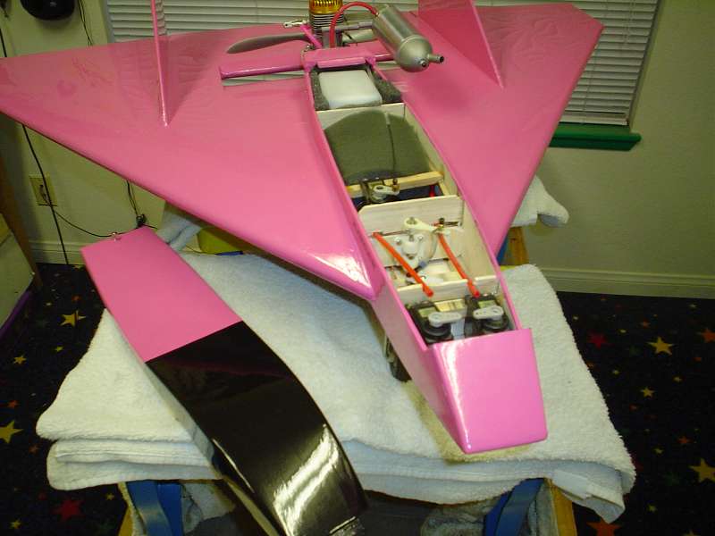

His is pink, please tell me yours is NOT

Be nice James....
FB,
If you'd like a copy of the instructions, let me know....or if you have any questions. The Force 1 flies awesome, however, I had a fuel tank problem last time it went up. I have since fixed it, but with all the recent CA rain, I don't know when I'll get a chance to fly it again.
Gary
FB,
Gary

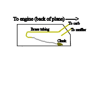

Freebird, I really like the sound of the Rossi-45 on that airplane...
The lateral balance thing was just a thought, the side exhaust muffler alone is enough to make lat. balance difficult, but you may be able to center it a bit---
When I saw Gary's fly I was impressed and while the GMS is actually a powerhouse, the Rossi-45--- well
Don't you guys just turn the tank around so the back of the tank is close to the engine and leave the clunk that direction? Gary knows anyway....

That is way to easy Razor just to turn the tank around
., but that is the only way I see of doing it too. OK you have talked me into the Rossi.

I thought you could just turn the whole tank around but I see gary's method is just moving the tank "innards" around- shorter fuel line route I guess-

My Feedback: (7)

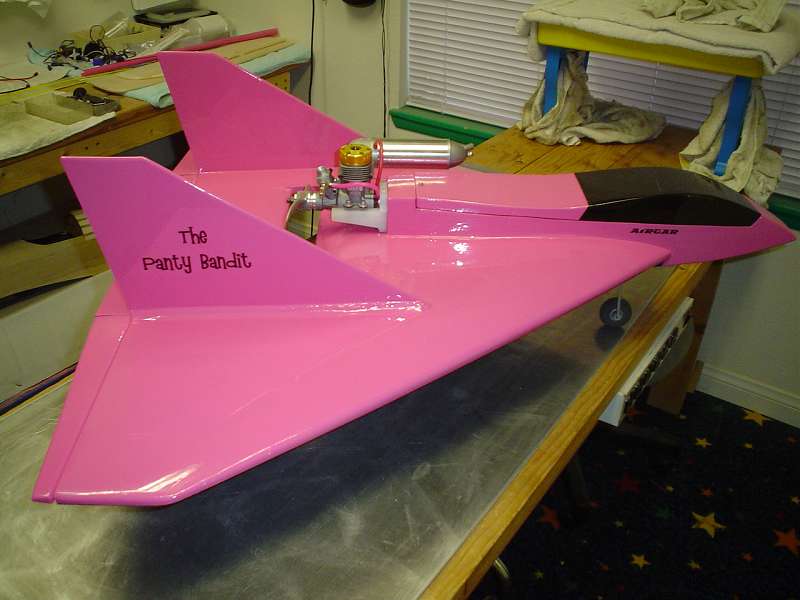

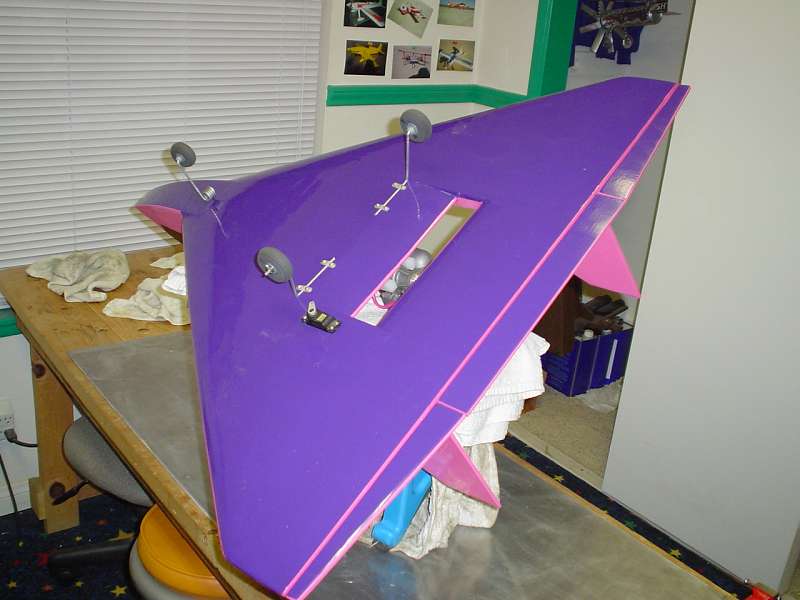

I'm with Freebird, forget about a rudder mod.
Elevons? Why? This plane flies awesome just the way it was designed, I wouldn't change a thing. EXCEPT.... (
) adding another servo for the ailerons (you can see this in one of my pics), and hooking up the nose wheel to your rudder channel . Done, go fly it...
Gary
Gary

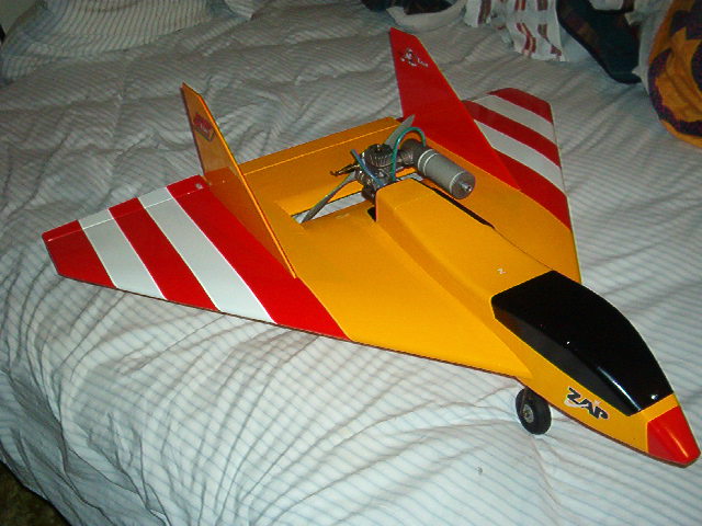

AirGar, Here is my Forcer 1. I had it in my extra bedroom, very cold here. My brother finally brought my cam back. How do you have the front wheel as far as which servo. I would like to have 2 Al servos and one for the El, but just can not find what to do with the wheel.

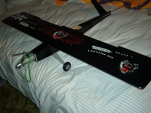

Here is a predator that had a very bad covering job on it, and was not very well built. I love to take a plane that was given up on and make it a real nice plane again. My friend that taught me to fly after seeing my Viper fly, stated "I have to get me one of those." I tried to get him to buy this one and re-do her. He stated it was a lost cause. I showed him the preadator after a little covering and mods and he deamded to have her
. I hated to give her up, but he did teach me alot.[&o] She still lacks about 2 hours, but I will let him finish her.
