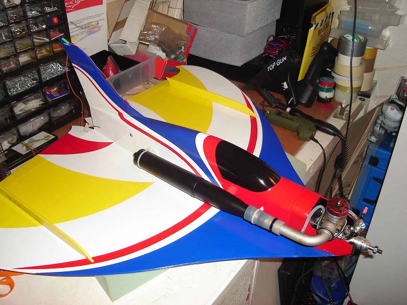

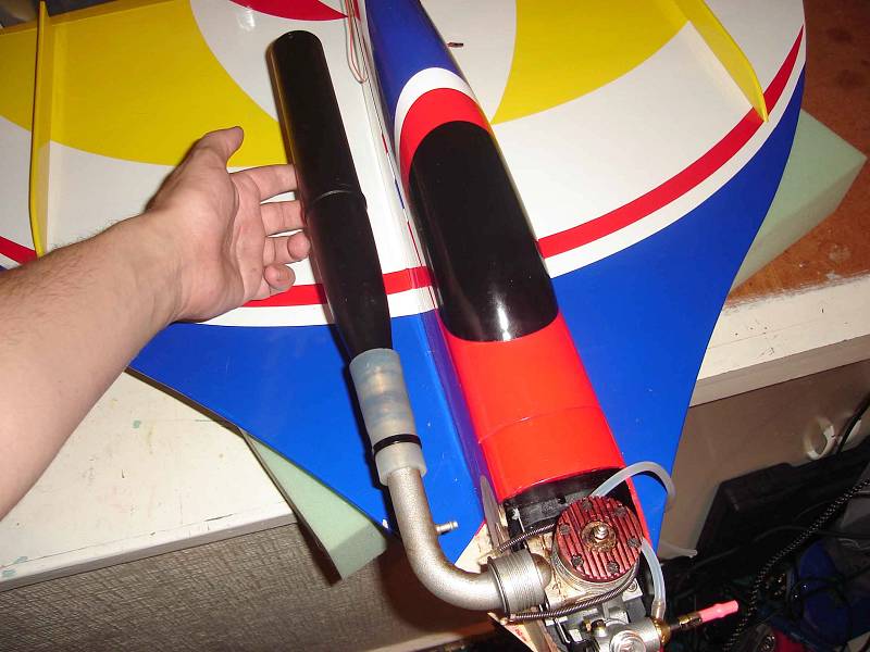

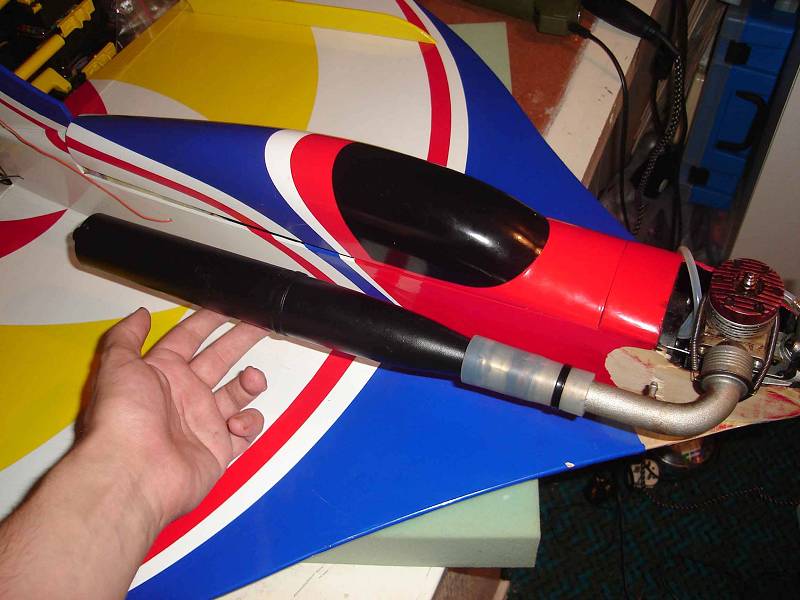

Hi Guys,
Just a quick question, as ive never mounted a tuned pipe before, ive finally got round to fitting my Rossi 53 with the Tuned Pipe to my Tigershark in the pics below......... after its last crash .........
My question is i have a Tuned Pipe Mounting kit, but should the tuned pipe itself be level with the engine......... ie : as im holding it in the last pic ? ie the space between the side of the fuse and the pipe ? is that right or should it be mounted down ?????? any clues would be helpful thought i would ask to save me mucking it up
Thx in advance for any info..........

Hello!
It doesn't matter how you mount it!
Regards!

Default RE: Another Quick Tuned Pipe Question !!!!!
I would mount that one solid to the fuselage with a zip-tie mount.
FBD.

Dude , if I may, is your pipe being held to the engine only by the spring ? GL on maiden.
Old 08-23-2005 | 09:49 PM
Joined: Aug 2002
Posts: 690
From: Columbia, MD
I think all of the Rossi headers are mounted with springs. I went with a MACS header because I did not like that type of mount. Looks like it is subject ot leaks and posible separation and loss of header and pipe.
Old 08-23-2005 | 10:47 PM
Razor-RCU's Avatar
My Feedback: (50)
Posts: 5,405
From: Mira Mesa, CA
RC-Fiend: The Rossi has an adapter that inserts into the header and is secured with the Spring- I always ran mine like that and no problems---
It will not come off
That is how I was going to suggest you mount the pipe- Looks good!

Look closely at the rear of the pipe, and you will see the zip-tie holding the
rear of the pipe to a mount on the fuselage. The front spring holds the pipe
to the engine....no worries....the rear mount just keeps the rear of the
pipe from flopping around.
