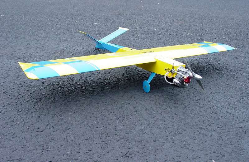

I am running a batch of Seeker Fusealage Kits as we speak, but I need to place my final count quantity today. I only sell the wood for the Fuse.
Hardware, landing gear, and wing needs to be obtained on your own. Bill Vargas builds the wings (Sheeted 1 piece) with all the goodies inside (CF) and complete LE and TE for $50. My fuse kits are $40 each + $5 shipping
Honestly though, for sport use, for basically the same total price, your better off buying a Viper, Predator, or Sonic rather than build my Seeker. The airfoil I use is better suited to the speeds obtained with a Q500 Nelson or Jett (160-170 mph).
Heres a picture of the first one I built from the Laser cut kit. I have since slightly changed the tail, but it is essentially the same plane.

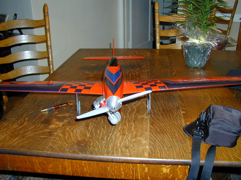

Agreed with Dave, the older ARF Vipers GP put out were a great diservice to Doug Whittacker (designer of the Viper - many were built from plans for years - very competitive in its day - even a NATS winner)
For sport use, if you go with Jett the SJ-50 is probably your best bet. You have a throttle, large array of props to chose from. For Q-500 type applications or on a Magnum you may want the SS or Race muffler - its an option when you purchase the engine. Turns Q-500 props better with it. Set up this way, the SJ-50 runs pretty much the same rpm as the Q500 .40 engine - just that you have a functioning carb, the engine idles well, and its less critical on the needle. Put on a 8.75x9W and hang on. And remember, you can throttle back ........ take off at half throttle .... makes life easy until you get the hang of it.
The Jett or Nelson Q-500 engines are wonderful machines. Not all that hard to set up, run very well. For sport you can back off a prop size and they will run flawlessly with little effort. Downside here, is they have no throttle - just an air-valve carb. Up side is you can occationally find use or older models of these engines for sale that are in great shape, just not 100% competitive for racing. For sport, the 95% engine will blow your doors off.
Skip the FIRE on a Q-500 or QM40. The long pipe is not worth it. Cost more too. The tuned muffler is all you will need.
The QM40 planes make real nice sport speed machines. Even with just a Thunder Tiger .46 up front! My old RJ QM40 is still flying - gave it to a kid in the club 2 years ago. ST46 in the nose. Pleanty fast for him. Matney has the AJ-2 and the Napier kits available. Inexpensive, and pleanty fast. Basic glass/wood/foam construction. Larson's planes as dave noted are very good. Im not sure if Lyle offers foam wing Dago kits still. Those were good values as well.
The QM40 planes do take some finess to land. The older ones (any of the glass/foam/balsa version) tended to land slower - some of these new composite birds have wings on them drive landing speeds up. Any of them will be quite fast. I agree with Dave on this though - get some experience with the speed with a Q-500 and you can try the QM40 later.
An example of a Larson dago red here - SJ50 engine for power. Uses either a 8.75x9W or a 8.8x9.25 prop clipped to 8" dia. Flys great. Also a photo of a typical Q-500 configured for sport use.
